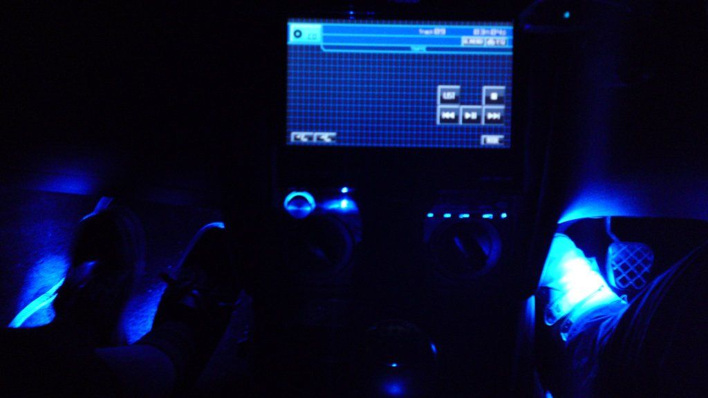

There is a lot of cheap lighting you can get now,
The way I wired mine, I got one of them four way plugs ( halfords) with on/off switches seperate to the plugs, biggest fuse in the car is for the push down lighter. I took apart the centre unit around the lighter. Then cut the plug off the wire and joined it to the wire off the car. I then chased back the wires for the switches, under the arm rest. By doing all of this , there is no plugs/ wires to be seen and you can plug in four etc lighting units. :)
what ever lighting you use , make sure you cant see the light , street glow affect works best
