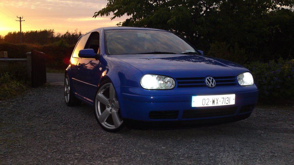

hay i have a mark 4 golf ,GT TDI ,originally 130 bhp , now 195 ,upgraded intercooler (front mount with all new fabricated pipes nd fittings... boostin at 2.1 bar ,,  turbo blew yesterday  :sad:,
wud a 150 bhp turbo fit my car ?

You had a 130 hitting 195....Bloody good efffort!
Yes the 150 turbo will fit! It is a bolt on upgrade, nothing will need changing! The turbo (only internally), injectors and intercooler is the only thing that is different between the 150/130  :smiley:

top pipes , made from noting , wit fabricated fittings , none of them crap little clips , two joiners using hydrailic hosing for a lorry

front mount on it , air a lot cooler so more compression , 2.1 bar of boost

Great pics pal!! :cool:

b4 colour coding the car and extra body work

Tidy work with the custom pipework. The Fmic makes a big difference compared to the crappy SMIC! If you throw the 150 turbo on I'm not sure how much power you'd get as the fuelling is a big thing with tuning diesels I believe, and the 130 has the smaller injectors!
Fit a decat, either cut out the orig or get a decat pipe and possibly a turbo back exhaust, and you will get a few more horseys and more torque, the decat is so sh!tttt.
I bet the tuner is to blame, 2.1bar is pretty high I think  :undecided:
