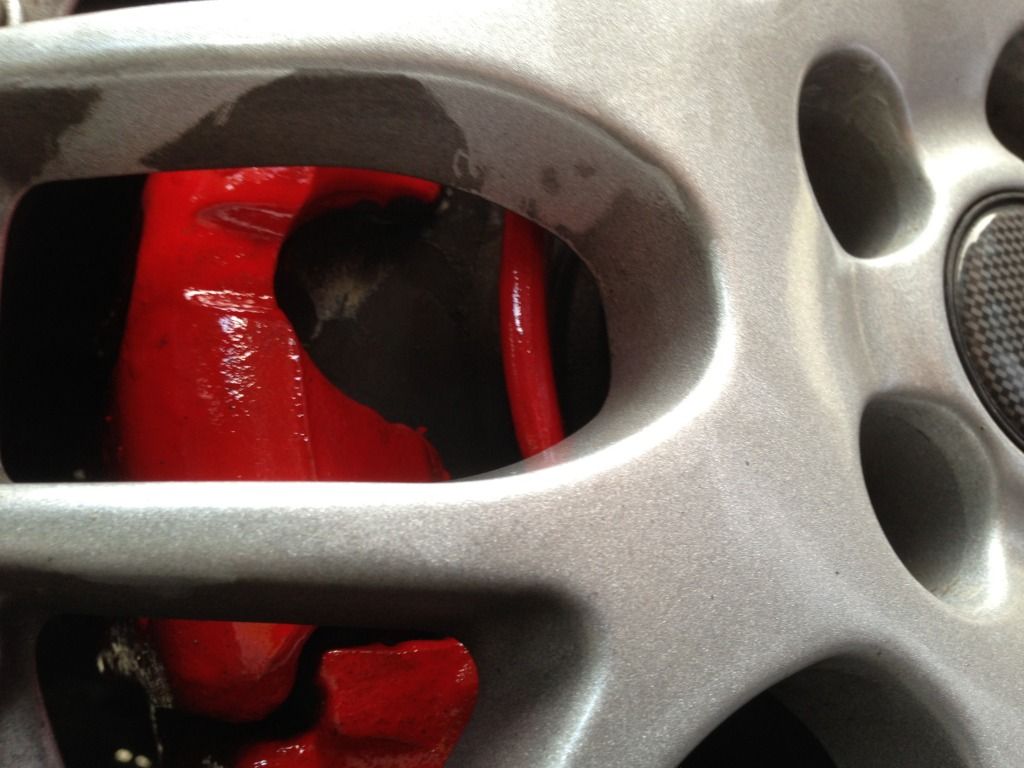

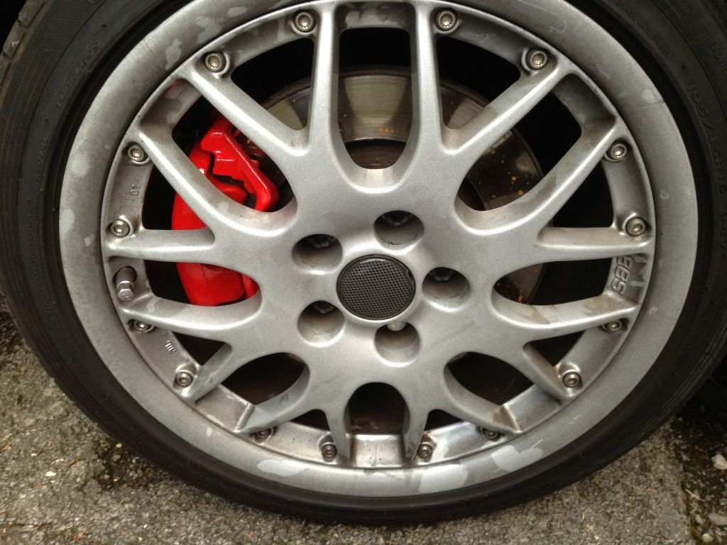

Just take a pic and show us.
288mm have a thing metal pad spring.
280mm has nothing.
Easy to tell difference just by looking at them
just a pic of the wheel square on? or more of the caliper?
ive just being a bit ingenious as dont wanna go take off a wheel now, as only just got in from work from 7 this morn, so got some wire and fed it around the disc around the middle (so sat on the vents), through the caliper aswell :) then took the length of wire, lay it down and measured, and got  d = 885/3.14 = 282,
but the groved bit is slightly smaller diameter than the disc, so in actual fact it isnt conclusive but looks like 280s, haha i hate golfs at times, lol :)
anyway ill go take a pic :) just to see what u reckon :)

You have 280mm

For the record if anyone searches, I'm guessing this is a 288 caliper :)

Yes that is a 288mm
