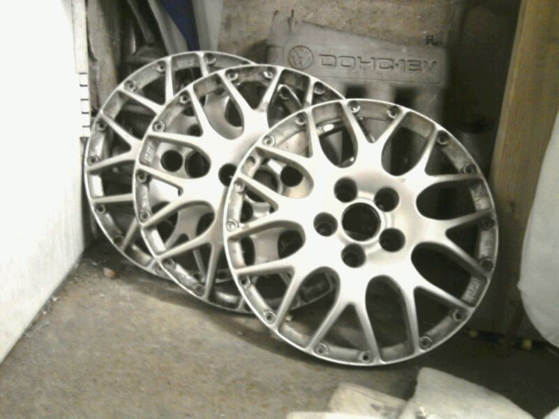

Mine were in worse condition than yours and all bolts and threads were good ,suppose its luck of the draw . thinking of doing mine again (colour change) so just the locktight to deal with as it been less than 2 years since i did them.

Got three split  :cool:

i may push the boat out and take one of them to work and get  the other broken bolt drilled out ,might lol

lol that sounds more like a might not  :grin: how many bolts have you got trouble with?

had one drilled out and one more to go and gave up trying to split them after that as we had tried heating the rim ,long bar on the spline key etc and basically got f**ked off lol, may well try soaking in plus gas and see how tha goes as on nights this week ,maye even inspire not to go view this other car at the weekend

Yeah i would defo finish the job if i were you,drilling titanium bolts out aint as hard as youd think, a carbide tipped or a cobalt drill super sharp and kept cool as the heat build up is what fecks them ,drill at a slow speed and use firm pressure,jobs a goodun ,he says,plus they will be worth a bit more  :wink:

would you believe it had the intention of taking it to work to get wheel sorted and forgot to get it out the shed lol,but had a word with my mate in engineering and hes goin to do it for me tonight
