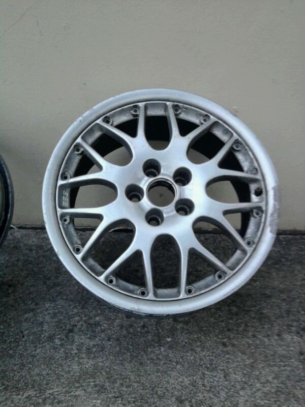

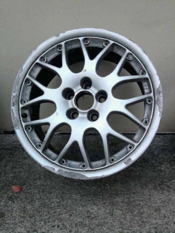

Thanks for all the replays guys sorry I didnt write back to all of you but did listen, and to be honest you well and truely put me off attempting this lol...... But I did :cool:
So got the wheels today and started undoing bolts
Wheel no:1
Rounded off thre bolts but managed to get one of those out
Wheel no:2
Rounded off two bolts but managed to get one out
Wheel no:3

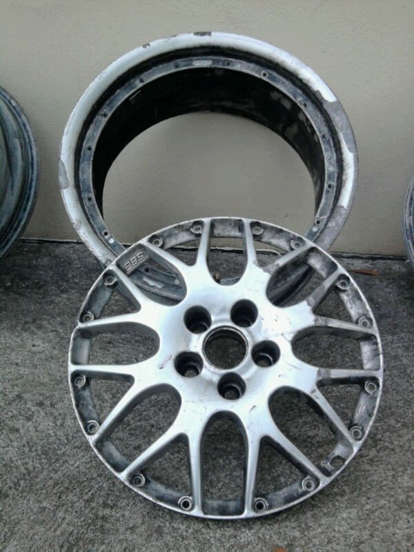

SPLIT!!!!!! Rounded off two bolts but got them both out  :cool:
Wheel no:4
Rounded off one bolt and couldn't get it out
So any ideas on how to get the four remaining bolts out? I tried hammering in a t45 in which worked on the other four. I also tried drilling one out, but burnt the drill bit and round that off  :embarrassed: lol

Got wheel four split by drilling out the bolt
josh

Got the stud out of the second one I split just by using a small bolt extractor tool. So I'm gunna drill out the rest of the bolts and do the same  :cool:
fair play mate ,mine look in better nick than yours and mine wouldnt budge with heat or anything lol
Yh I did think they'd be a LOT harder to split coz of the condition of them
