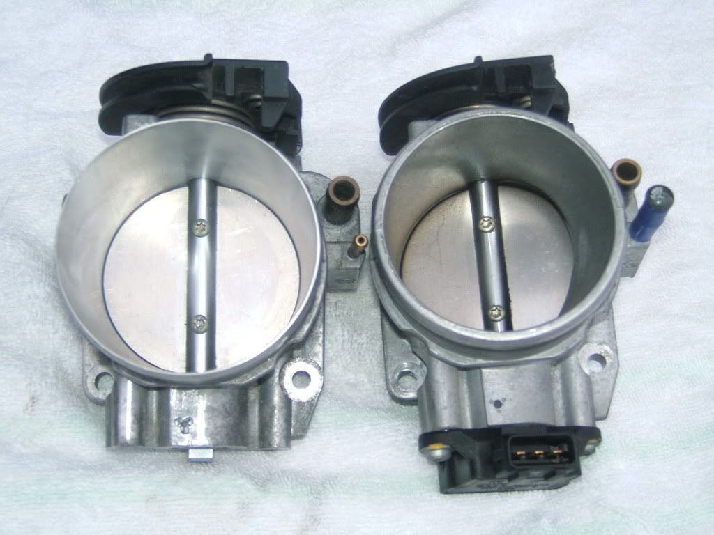

Do you have any dimensions/drawings for the throttle body modification?
Just take the ramps off the TB, inside and out.
You can do it with a Dremmel, just don't touch the sealing face.
It's pretty obvious when you get the TB in your hands.
I had mine off for it's periodic scrub up this past weekend and i forgot just how rough and lipped these were. unfortunately my Dremel is out of suitable bits at the moment but i can feel a bit of fettling coming on over the next week or so.
You can go further if you have access to a lathe with a 4-jaw chuck:
