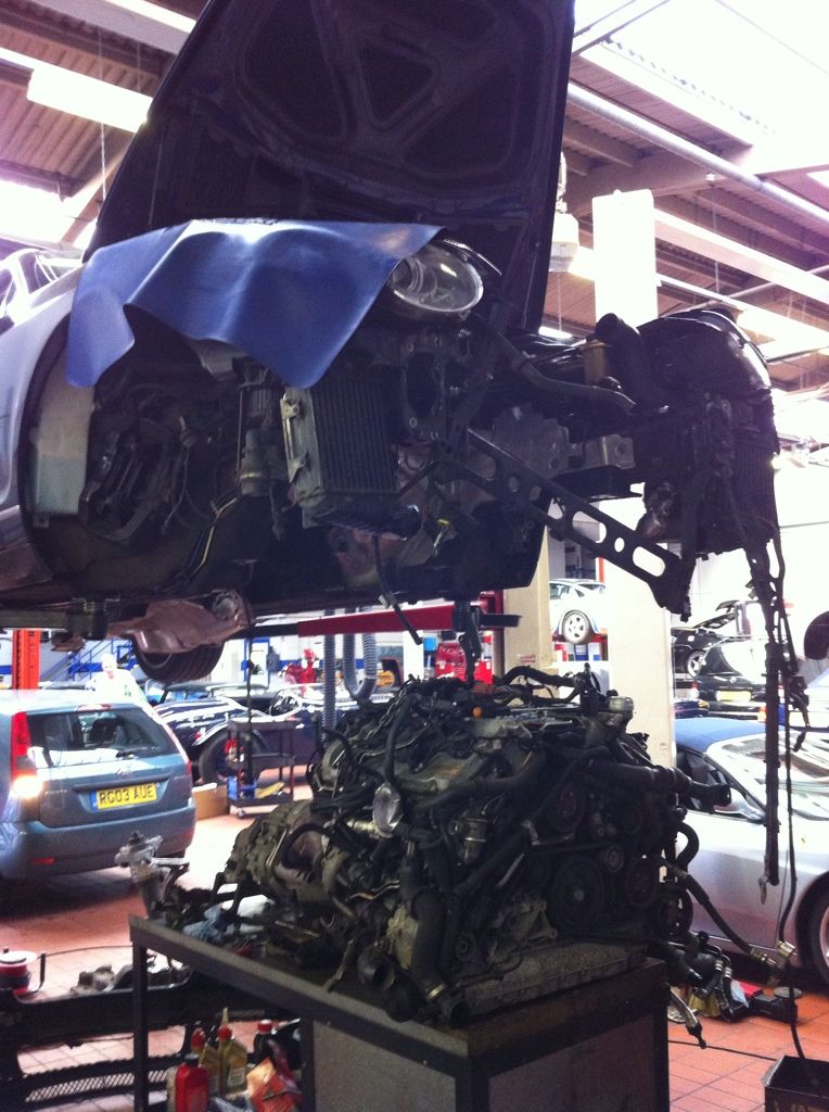

Gt's the last one I done , see the round pump behind the o/s inter cooler , that's the pump and filter that run up an go near that silver foil on the engine then the plastic pipes run over to the rocker cover on the o/s o the top of my head ,
There are several sensors round the maf and bottom of the inlet manifold . But get in there with brake cleaner spraying looking for air leaks
