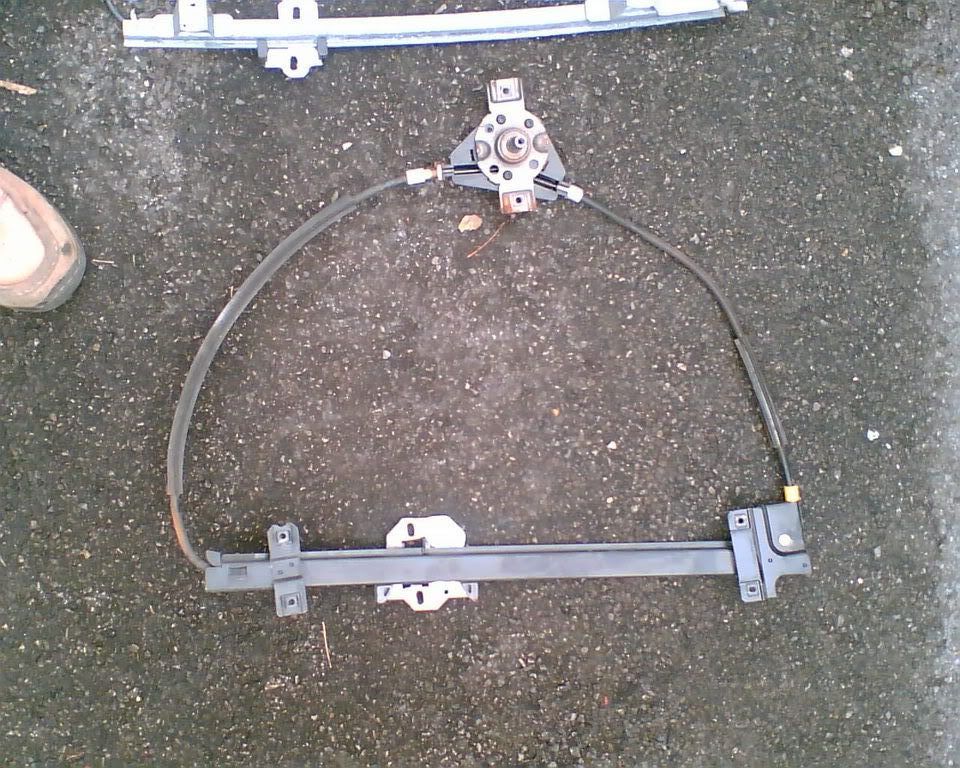

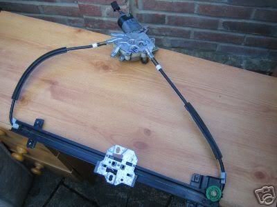

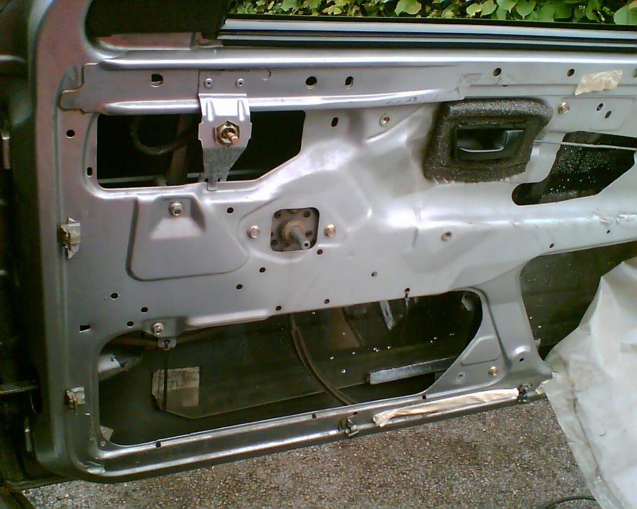

OK thanks for the advice.. still not sure on how there gonna get in. recon i might have wrong type.. if these are to fit the metal part which holds the glass will need to be moved to the right.. I am guessing this isnt gonna be too easy to shift..
My manual Winder Mech
New Electric Mech
My Door

Just had another look.. If anything the new electric motors could use the blue holes.. I THINK... and the red holes are the for the standard winder.. i would still have to move the piece of metal and rubber which grips the glass..ummm

the mechanism look like 90 spec ones to me apart from the bolt holes
Have a go at fitting the motor till it all lines up.
You have to roll the window down about to get to the mechanism bolts that hold onto the glass

The running which the Mech attaches to the glass on the bolt holes are in the wrong place.. meaning i would have to move the Strip of metal and rubber along the glass to meet up with the runner. Ive had a go and its F*cking tight...
