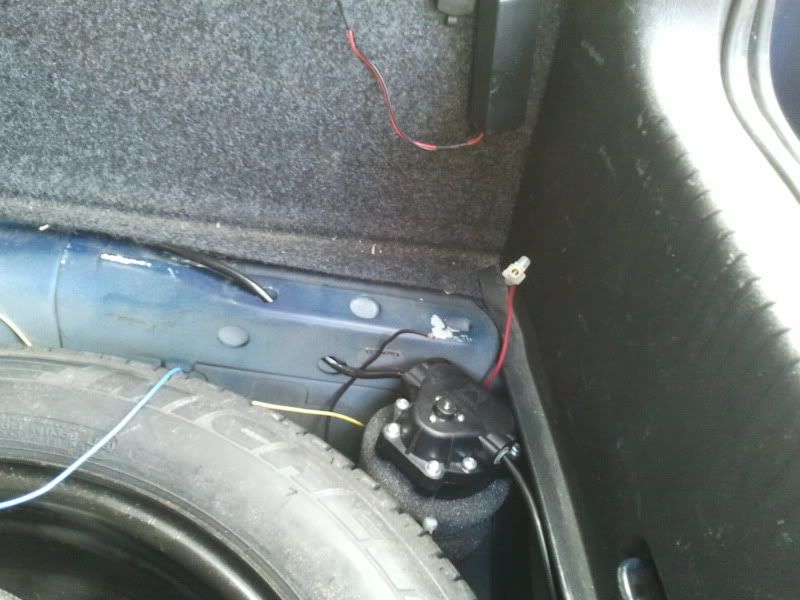

Chris is your wmi plumbed into the intercooler or inlet?
Iv seen one at R-tech his is directly into top of inlet manifold.
I to buy a kit but im clueless when fitting something like this, how easy isit?
After a long discussion with fellow wmi users it drew to the conclusion that the best place to install the wmi injector was on the outlet (cold side) of the intercooler pipework before the throttle body to allow maximum time for cooling/atomising of the charge!
The kit is rediculously easy to fit, Few very basic tools needed and the instructions are very good! if you do get stuck devils own have there own forum on there website with members constantly online to help you out :wink:
Nice bay dude!  :smiley:
I'm thinking of a similar set up in the boot. I take it you've dumped your spare wheel? How do you like meth?
Nope if you possition the pump in the right place you can still get the spare wheel in like me! WMI is night and day difference, Played a huge roll in the figures I produced after my remap. highly recomended and methanol/water at 40pence a litre its hardly bank braking
          2003 1.8T: R-tech Live Cutom Stage 2 remap: N249 Bypass : Forge T.I.P : Forge 007p  : Forge Actuator, yellow spring : Toyosports F.M.I.C : Toyosports C.A.I :                                                                   PCV simplified - oil catch can : 42' Draft 3" turbo back non res exhaust system : Devils own W.M.I : 231bhp & 258lbs-ft

you mean like this
 :wink:

you mean like this
 :wink:
Looks good. I think my boot is similar?
I was hoping to fit it in the cut out section where the boot light is if it'll fit. Then the pump in the spare wheel well below? Im planning on getting the AEM kit off eBay.
