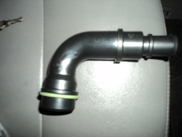

problem though. just been checking and wonder what people have done to their connections to the oil filter housing?
have you removed the old connection and put in a block breather adaptor in like this
http://www.034motorsport.com/engine-components-18t-block-breather-adapter-audivw-18t-p-392.html
and what type of adaptor did they purchase, such as -10AN or a -12AN or if there are any alternatives?
this is a head scratcher for me as i havent found anything else  :cry:
many thanks!
jockgti
Re: Oil Catch Can problem
« Reply #1 on: 29 July 2012, 21:49 »
http://i1085.photobucket.com/albums/j421/LEBMK4GTI/DSC03024.jpg
i just bought a new one and stuck the 19mm hose on the end of it,if thats what you mean
