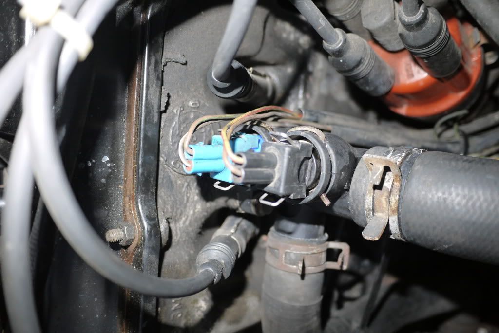

Below are pics of my sensor and reservoir just in case

Just replace the black coolant temp sensor. And then see what happens

Un plug black sensor next to blue one on coolant flange. Bridge the two pins in the plug together, using a piece of wire. Check gauge for movement, should go all the way to the top and stay there with light on. Remove jumper/bridge wire and it should lower back down. This proves the gauge and wiring work. Then if your coolant header bottle has a level sensor unplug that, and do the same test you did earlier, this should make the light go on and off on the dash as you short the two, and disconnect them again. these tests will hopefully show what the culprit is, either black coolant sensor or header tank level sensor at fault..

It sounds to me that you have either a faulty black temperature sensor, ie shorting intermittently. Or you have a fault in the wiring to the sensor. Try it with the plug disconnected as mentioned previously and if it goes away with it disconnected,try a new sensor.
