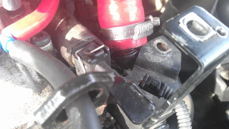

Checking over my meth inj system found oil mist breather pipe broken and to top it off meth inj pump loooks like given up the ghost.  :cry:

Ordering silicone hose replacement type and my work for today look into my wmi.

Well removed and refitted wmi today and now working :smiley:. put 100cc nozzle after TB and 175cc after IC added 3degrees timing with unitronic setting, logged timing pull via vagcom pulling 5degrees. Adj spray start before timing pull starts pull disappeared so have add another 1.5 degrees log pull on way to work in morning. noticed now intake temp way down to 5degrees on nice hot day like today to brilliant. Looking into going direct porting have spare intake manifold in shed.  :smiley:
