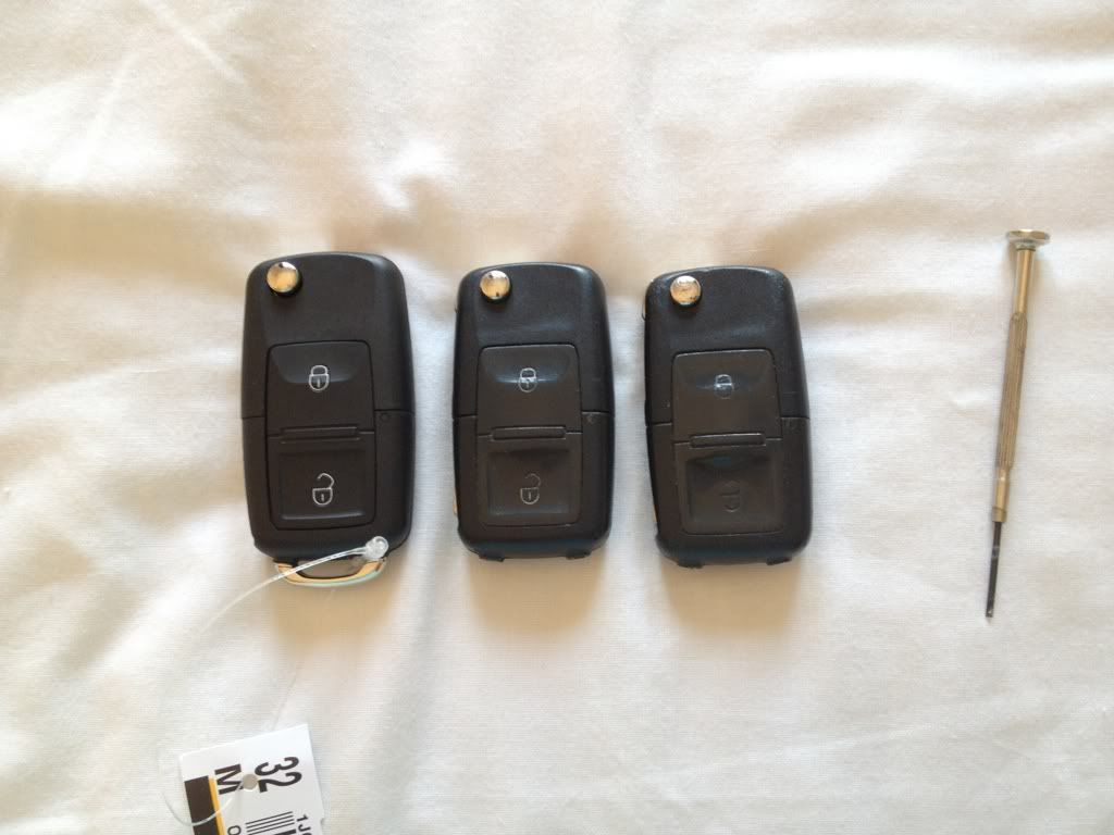

Hi. I want to change the outer casing on my key fob (as it is held on by selotape at the mo :-\ ) My question is; is it just a matter of taking the casing of the new one and putting it around my 'gubbings' (changing the blade over of course) ?

What I mean by outer casing is its off a scapped golf so not brand new lol

Niceand simple buy a fob off ebay take apart current fob and swap over the gubbins which is simple but you will also need to remove the immo chip CAREFULLY i used side cutters and cut around it then super glued it into the new fob i only done this as i had 2 keys so if i knackered 1 it wasnt a huge deal

« Reply #8 on: 02 July 2012, 18:39 »
