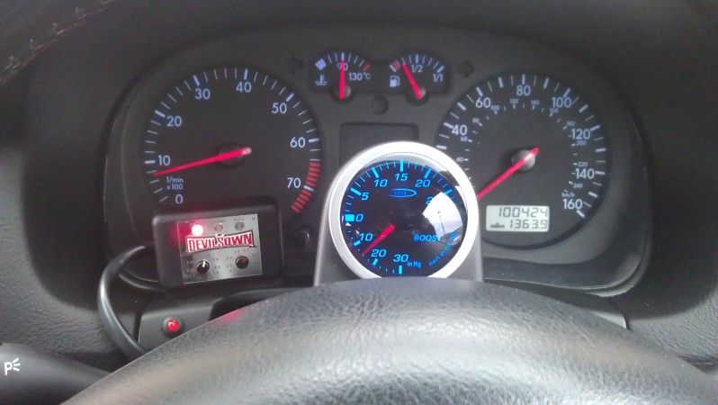

What a day up early to work removed WMI pressure type switch and fit MAF based progressive controller, filled up meth tank and away i went. Rigged up laptop carried timing pull logs was pulling 8-9degrees advanced to much as i added 6degrees last week. Dropped timing by 3 and carried 3rd gear pull on motorway pulling just under 6degrees. WMI start at 3.4v/6psi and full at 4.1v/13psi now pulls like a train bloody awesome. Waiting for TB spacer so can go dual nozzle one after  cooler smaller nozzle after TB better cooling and poss more timing= more power. Best mod i've done by far highly recommended.

My intake temps well down compared with boost controller, mine now down to 10 degrees which is damn low compared to 20+ with boost controller. I speak to Scott at usrt in state main man for wmi over there said if go fast spoiling turbo like ko3/s must run maf controller comes in a lot faster and correct time from the 1st component on car the MAF. A lot smoother now and potent a must have I'd say.

Took an hour to change over easy just running wires 2 to tank, 3 power supply and 1 to MAF can put more timing on too.

Yep doing that yesterday on motorway 3rd gear pulls, Did add 6degress but was pulling near 8 so dropped to 3 advanced now pulling around 5. Going twin nozzle when my flange finally turns up from states will get lower temp and timing pull will lower. even at 6 advanced no detenation pulling from 2000-6500rpm intake temps 20degrees, down to 16 at times tyrolsport smic doing its job. Lad in runcorn who i use for power runs says can use his rolling road for couple hours if need be £50, so check 2nd, 3rd and 4th gear pull will do that when correct size nozzles and solenoid fitted. Vagcom and unisetting so helpful, had to do it myself no one wants touch water/meth. not doing a bad job myself don't think so far anyways.  :smiley:
