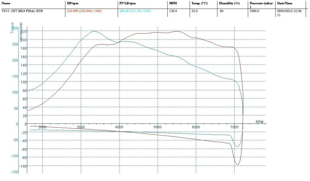

Take a look at my buid thread mate not up today's yet but got all my mods listed at the start  :smiley:
As said I have got 250 butt exhaust is restricting me massivly can see it on the graph, feel it and hear, my set up is pretty much the same as what nick at r tech had apart from the milltek exhaust which is next on my list an he was gettin about 280 bhp!
You can see how my torque peaks holds a tiny bit and then drops pretty much straight away, that's because my exhaust gasses can't get out quick enough so hopin to hold that a little more after gettin a good system.
