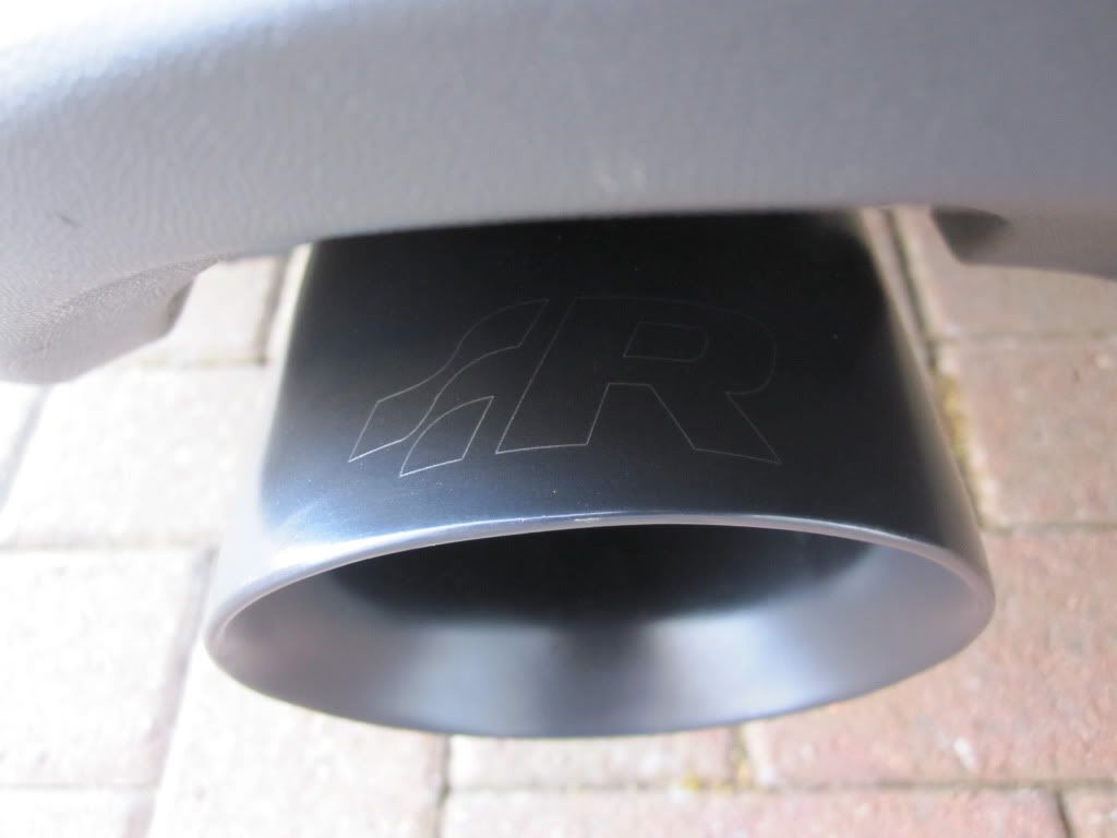

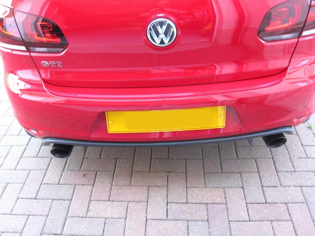

After a quick buff up and sorting out some of the black ceramic coated VW Racing tips, I got round to fitting it today.
It fitted a treat...and I'm pleased with it.
More de-blinging completed.
Job done:

 :smiley: I have got the black ceramic tips on mine, IMO they look miles better than the Chrome bling bling,
 Well done  :smiley:

I pestered and pestered Sam @ VWR until he agreed to sell me a pair of black tips.
They were the 70mm tips though, for the full turbo back exhaust, so I had to get creative with the hacksaw and break out the TIG welder and stainless rods to make the black tops fit my road biased system.
The black tips are 60mm, with 70mm 'increasers' welded on to suit the turbo back 'race' system.
I cut the '60-70mm increasers off, cut the 60mm to 50mm 'reducers' off the standard chrome tips, and welded the 50-60mm reducers onto the black tips.
Half a days work later...job done!

Bloody good effort!!!
They look cool   :smiley:

Very nice, and a lot better than the std tips...

They look cool.... :cool:
