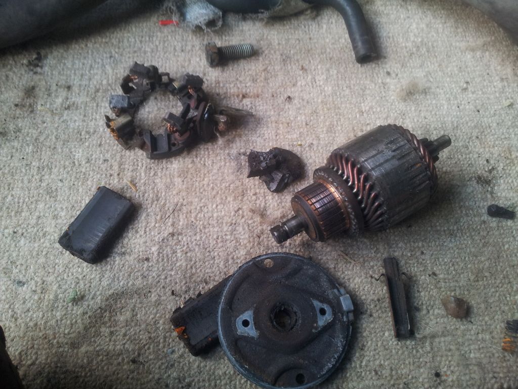

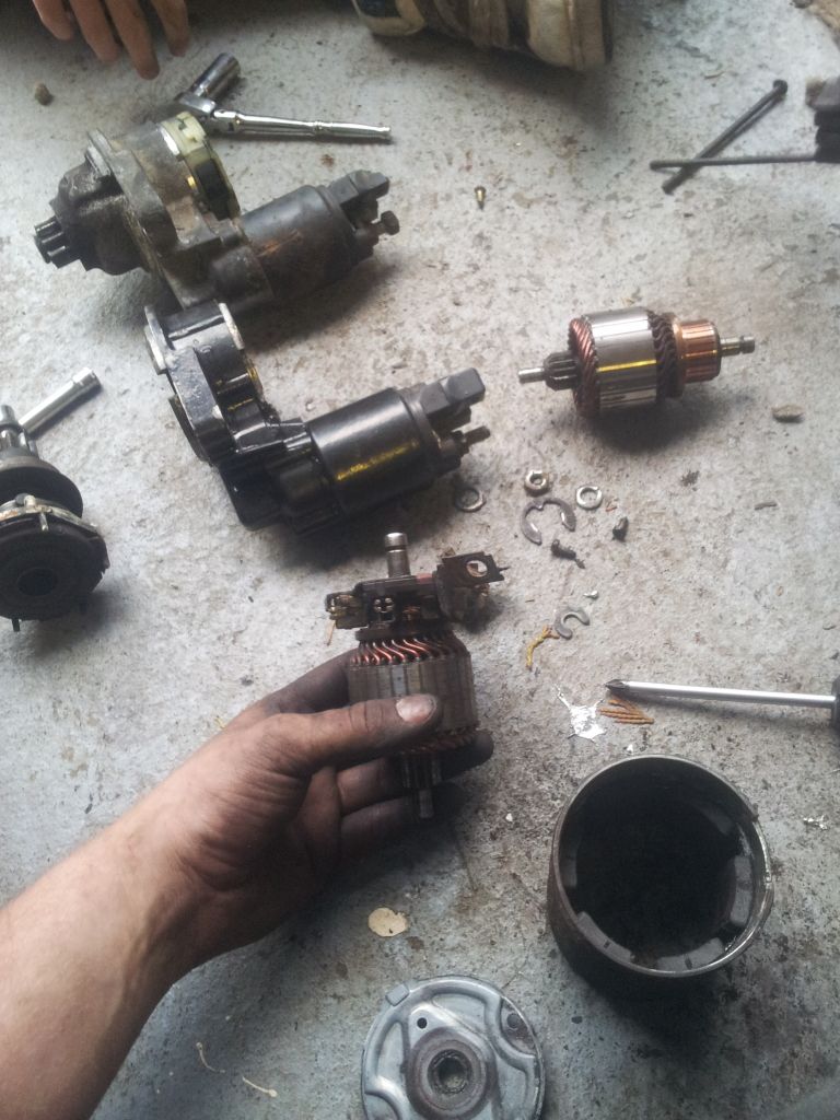

Second hand ABF starter i got from Bay advertised as in perfect working condition was noisey from the very first time i turned it over... Died a death yesterday and started crunching etc also...
Took it to bits
Maybe not too clear but in middle is one of the magnets that sits on the inside of the casing, had decided it didnt like it there anymore and was rumbling around in the rotor. Cleaned out the solenoid on the starter and freed it off, then got the 20vt starter and robbed bits off that. Luckily the casing is the same size/dimensions/no. of magnets. So built a decent starter thats not noisey at all now outa two of them  :smiley:

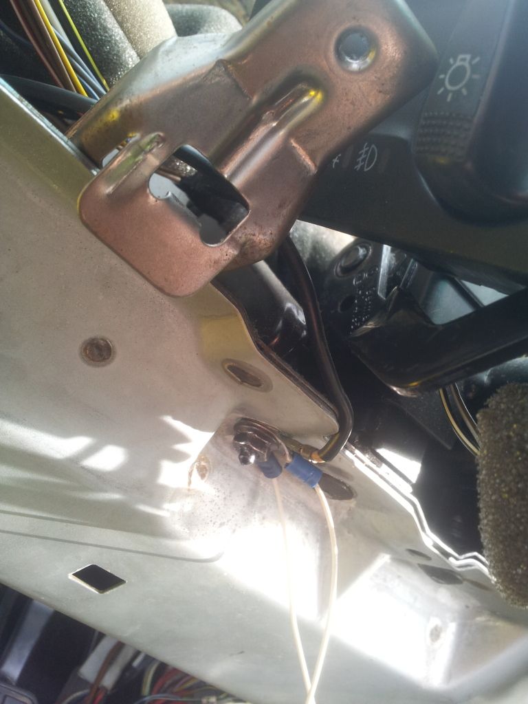

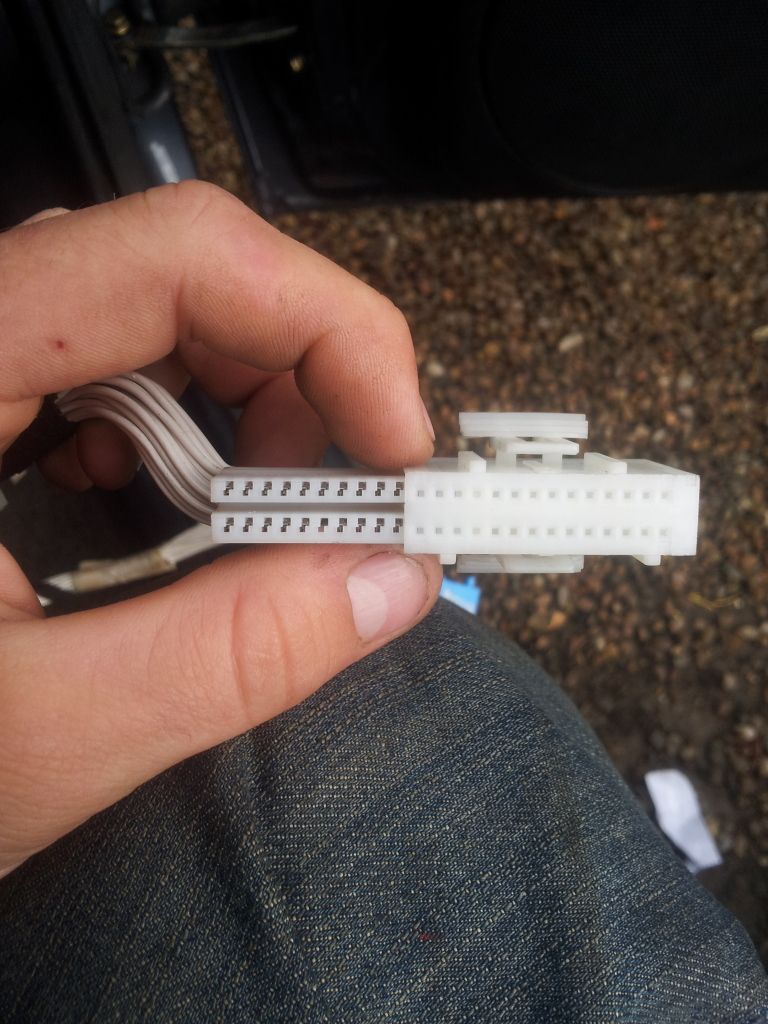

Had no dash lights at all, milage and MFA were working, but as soon as you turned ign on whole lot turned off and didnt want to work. Checked all my engine earths etc, all okay. Found that pins 3 + 5 are earths for the clocks to the fuseboard, for some reason they had become disturbed somehow. Pulled the wires out of the chocolate blocks that go to fusebox and earthed the wires to the steering column. All good, clocks working a treat  :smiley:

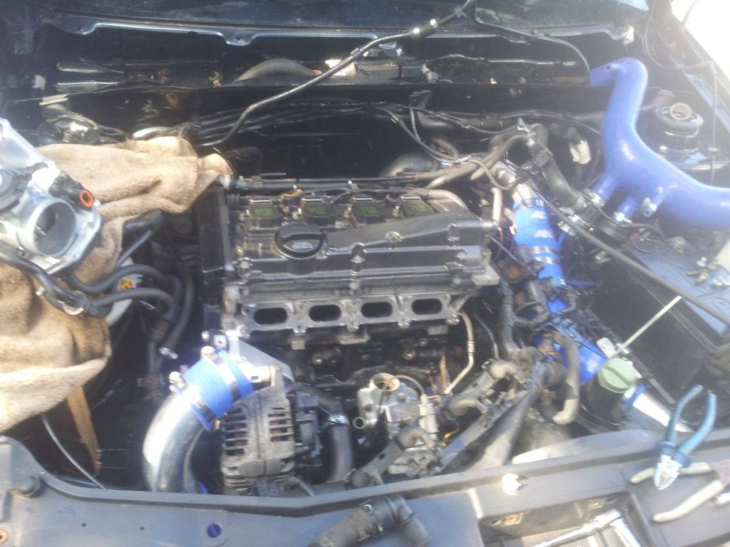

Last problem iv got, maybe someone could shine some light on it if possibly?  :kiss: The N75 valve is noisey, after about 30 sec idling starts chapping and sounds almost tappety. Gets steadily louder and faster. Give it a bit of throttle then it goes away but comes back again after 20/30secs.
Video
http://s1114.photobucket.com/albums/k530/CJA321/?action=view&current=20120907_191404.mp4
There is a fault for N75 last time i checked codes, but i assumed that was just due to unplugging etc when had imob fault. Boost pipes are on the correct way, and iv tried another N75 with the same part no. and end code letter C on both of them but both seem to do the same thing. Any ideas would be great cheers

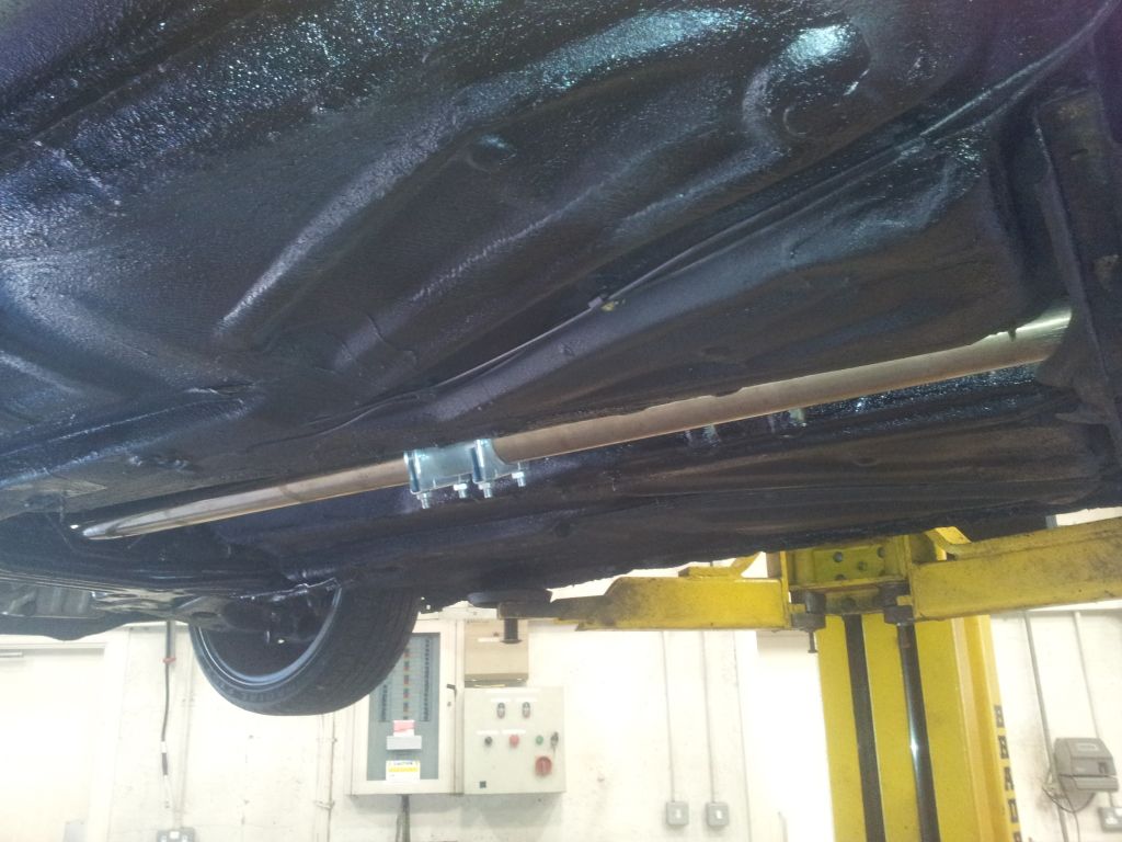

Got her back on the ramp and waxoiled it to death!!!  :rolleyes: :evil:
No rust, and solid underneath. Hopefully keep it that way for a bit!!

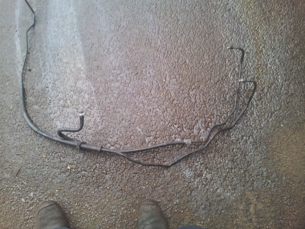

Power steering pipe burst today though, was a risk as new they looked bad when had engine out. But hey-ho, nevermid....
Thats the old ones, VW wanted as near £400 for them both... So gonna take them to local hydraulic place and see if can cut the rot out and make me a high pressure pipe with hose and the old connectors!

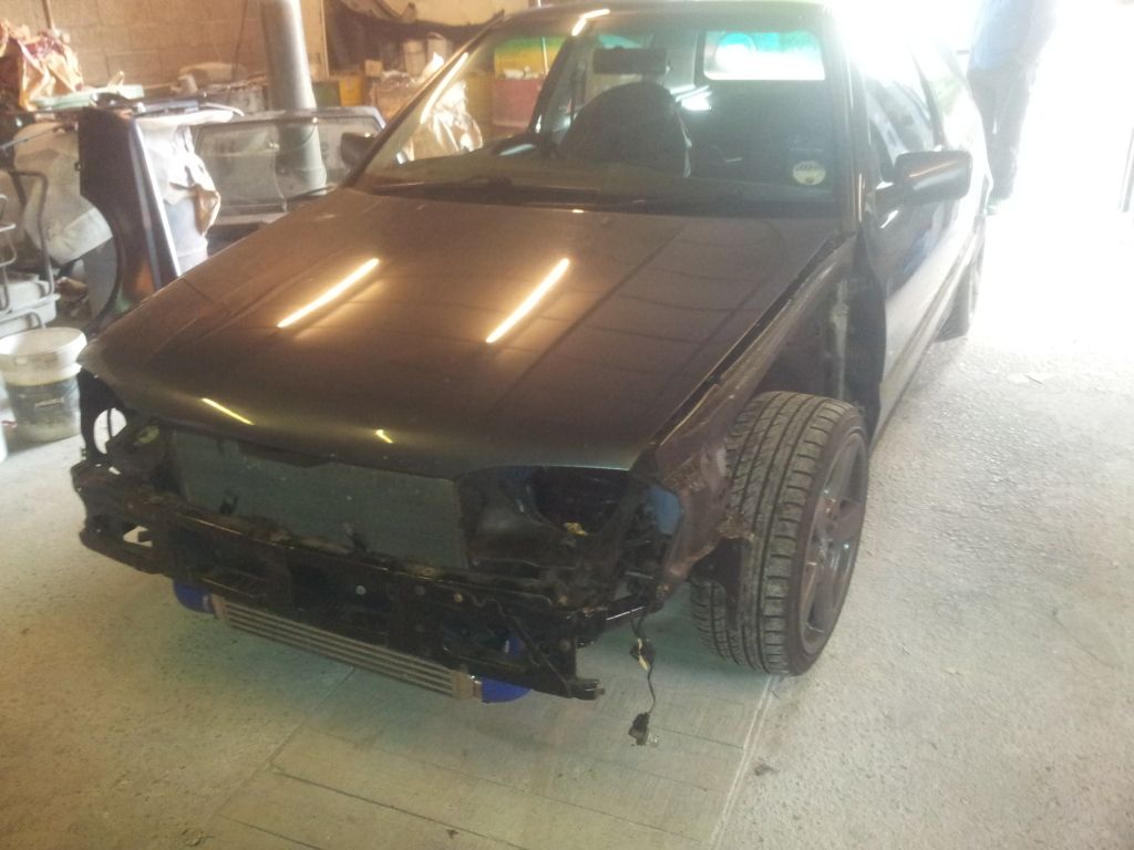

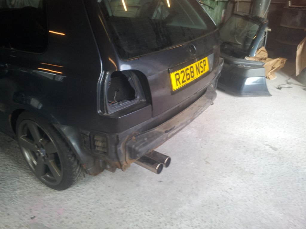

Dropped off at paintshop about 30mins ago, stripped her outside.
All colour coded, leaving black trim on splitter, spoiler, rear valance and sill trims however.
Few cheeky shots of her going in
He's gonna give me a shout when its in primer  :smiley: :smiley: :smiley: So more photos to come shortly

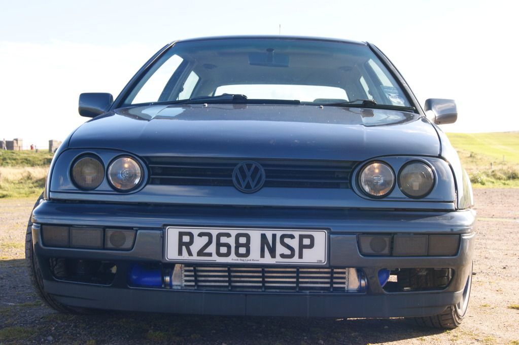

Need to centre intercooler a bit better, not to fussed though

Offline F17BAD
  • Posts: 4,225
  • Golf MTM S3 GTI TURBO
looks really good mate
is that intercooler to the right tho ?
Not no ordinary GTI....
www.mixcloud.com/kells/
Offline Toby
  • Posts: 3,901
  • Car - less
Intercoolers not enter  :undecided:
