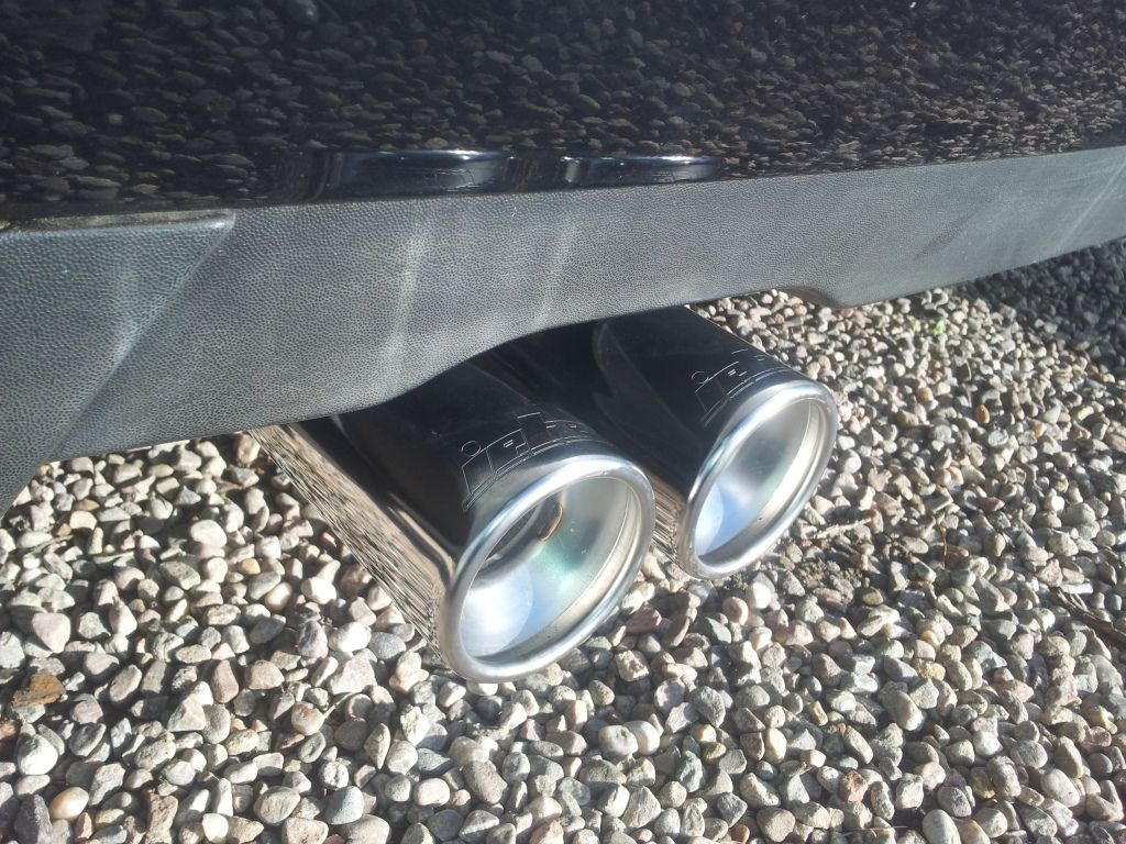

Got my custom downpipe and my 2.5" Jetex exhaust fitted

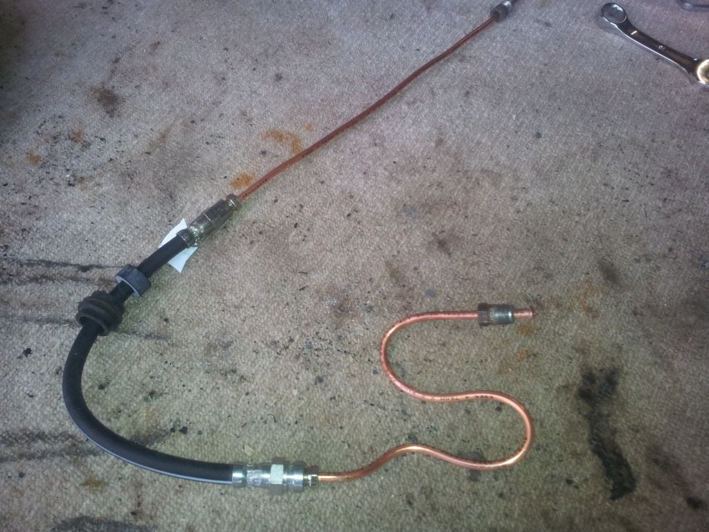

As said before, broke my clutch pipe being a tool, wanted £80 from the stealers, made myself one up outa double ended female flexi for £10 and some brake pipe from work. Have no idea if this will work yet, functionally it should, unsure if it will leak or what the pedal will be like though as noticed the pipe on the standard one is slightly thicker, will have to see  :laugh:

Should work a treat mate.. Where you get double ended female ?? peddle should feel no different as the feel is in the cylinders..
Got the flexi from local trade parts place called dingbro, was a delphi hose. Probably have the box and part number somwere if you need it.

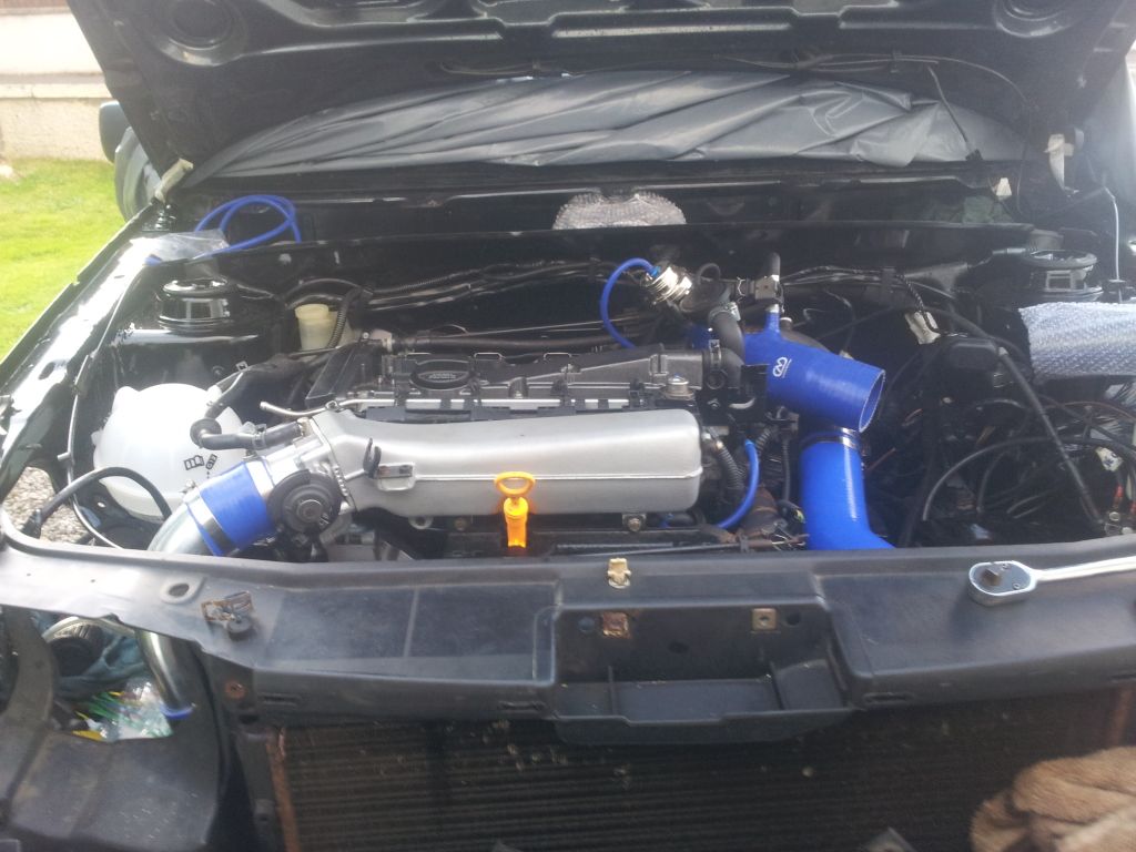

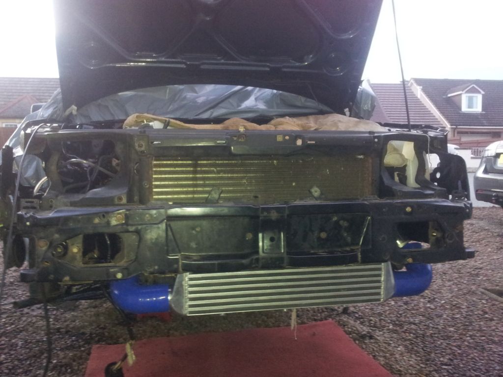

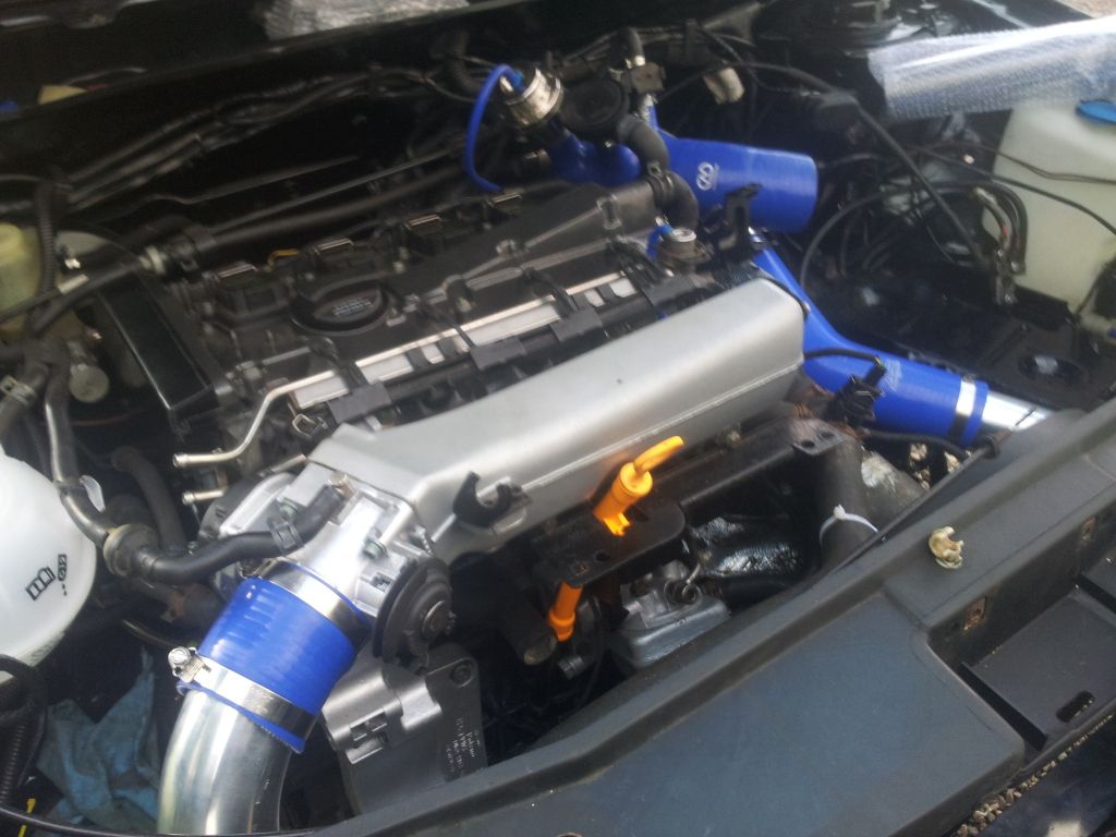

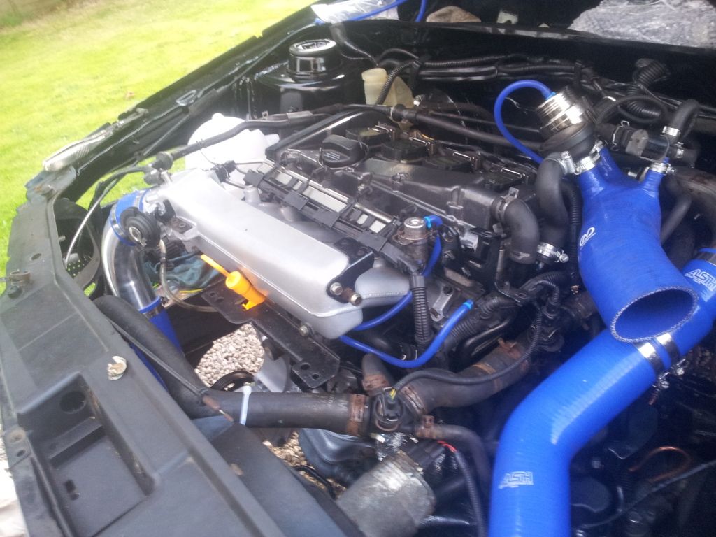

So, got the FMIC  fitted, made up some brackets from some old gate brackets
Plumbed the whole lot in, new vacuum pipes and new silicon TIP, aloy hard charge pipes and silicone hoses from ASH.COM
Few bits need adjusted, But pritty happy with result so far
Might get some stick for going blue, but i think it works pritty well tbh.

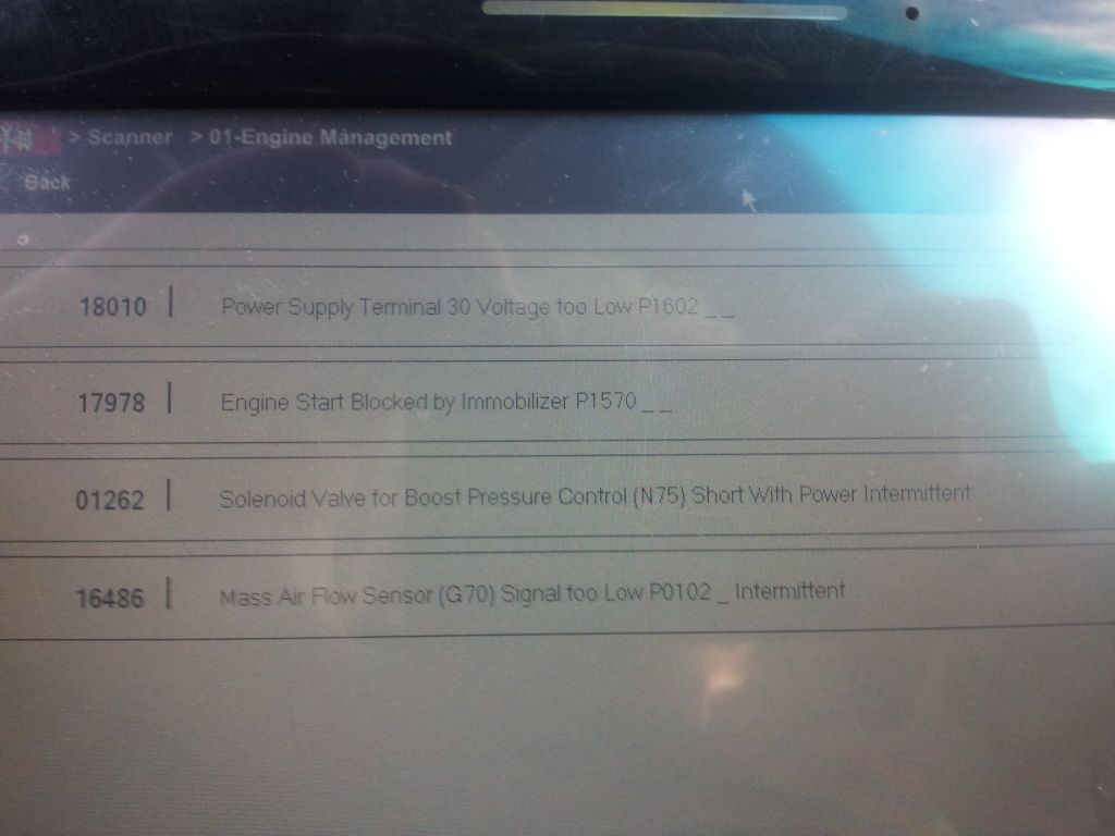

Went to start it the other day, starts and runs!!!!!!! Delighted!!! Only problem, was idling for 2/3 secs then dying... Checked all earths, sensors, plugs, fuses. But looked to me to be an imobiliser fault, which is pritty annoying seeing as the ECU was supposed to be unlocked.... Borrowed the scanner from work to have a look
Other faults are from me messing around with plugs and all cleared fine. Bit annoying iv now gotta send ECU away again... Gonna get the imob chip removed completally rather than just reflashed.

i noticed that on the exhaust theres a dent by the tail pipes?

looking nice. good to know your doing it right!!!
Thanks, hard work but worth it. Yeah i noticed that too, supposed to be there though apparently  :smiley:
