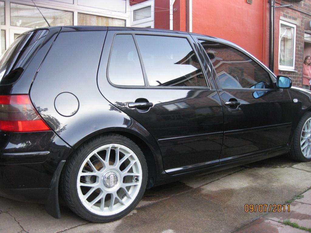

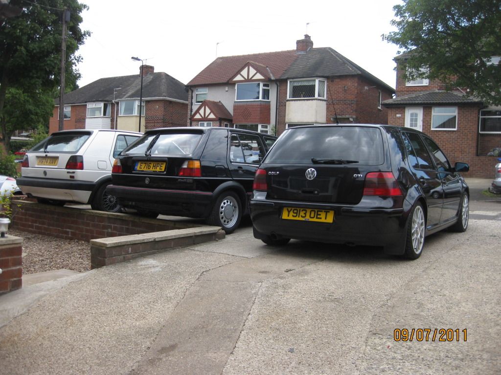

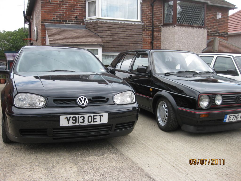

So here is how i bought it in july 2011, the wheels were knackered and there was a small chip next to the boot handle but wasnt to bad apart from that, already had the k&n typhoon induction kit, custom turbo back exhaust, forge actuator, 312 discs on the front, component spekers in the front and sub in the back.
a few pics next to my old black mk2 gti 8v and my dads mk2 gti 8v ...

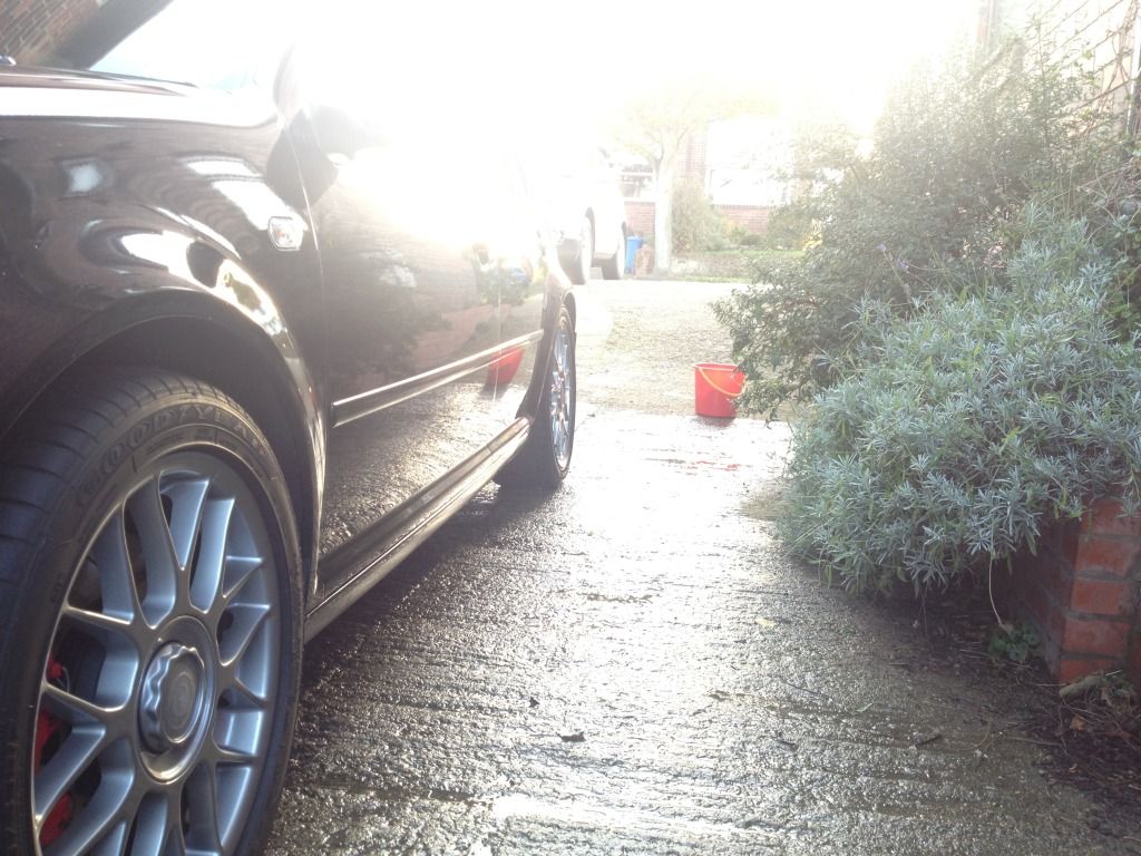

and after its first wash....

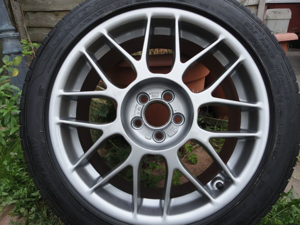

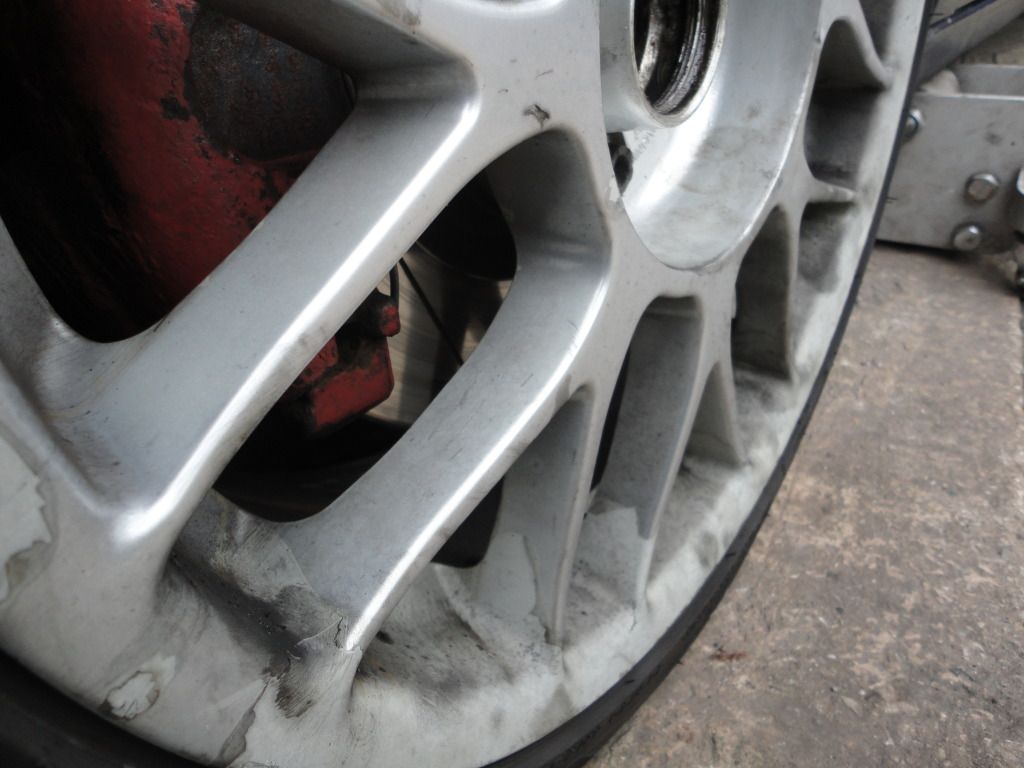

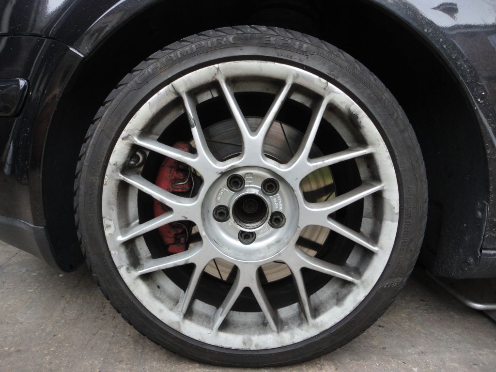

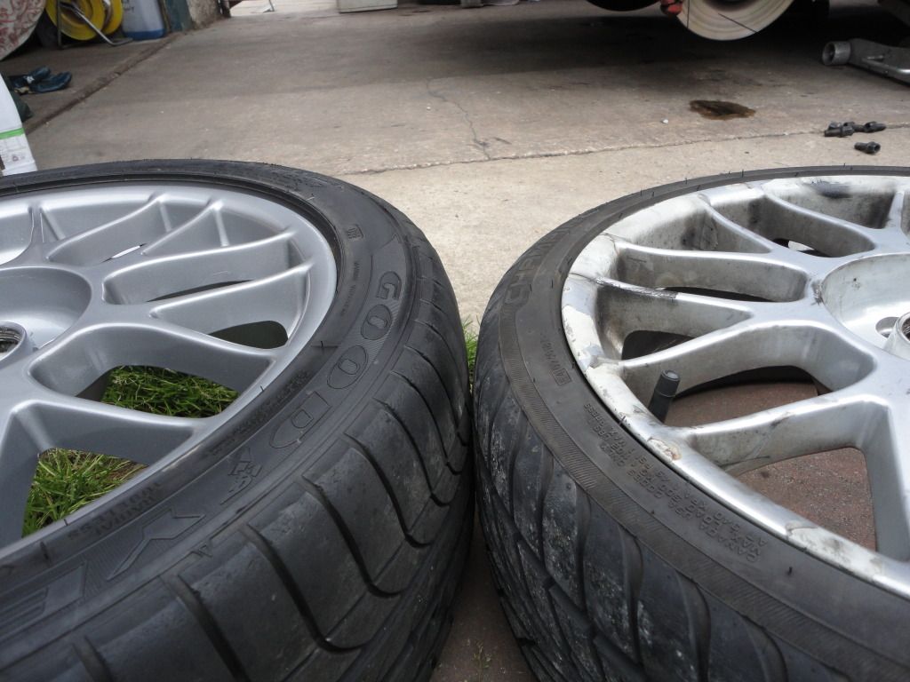

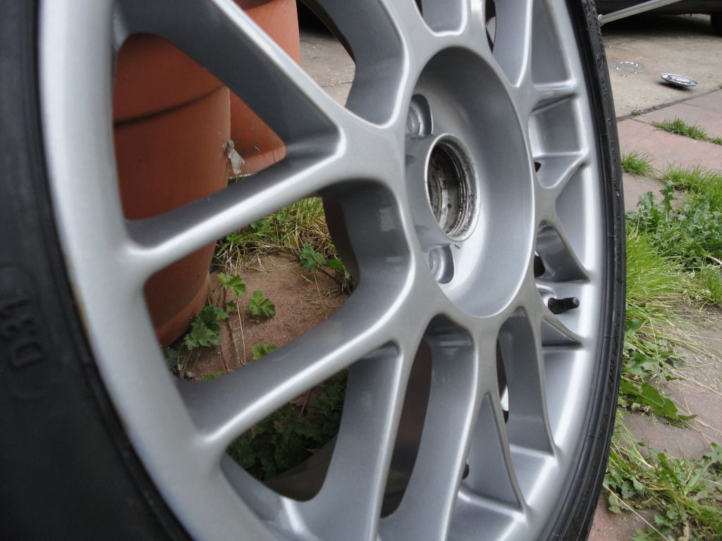

I decided to do something about my wheels as  they were a disgrace and i had budget tyres on the back which were dangerous! (nexan  :sick:)
This i what they looked like to start with  :sick:
And what they looked like after with goodyear eagle f1 tyres  :cool:
A comparison photo  :smiley:

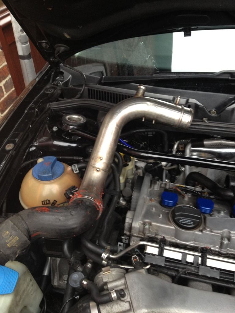

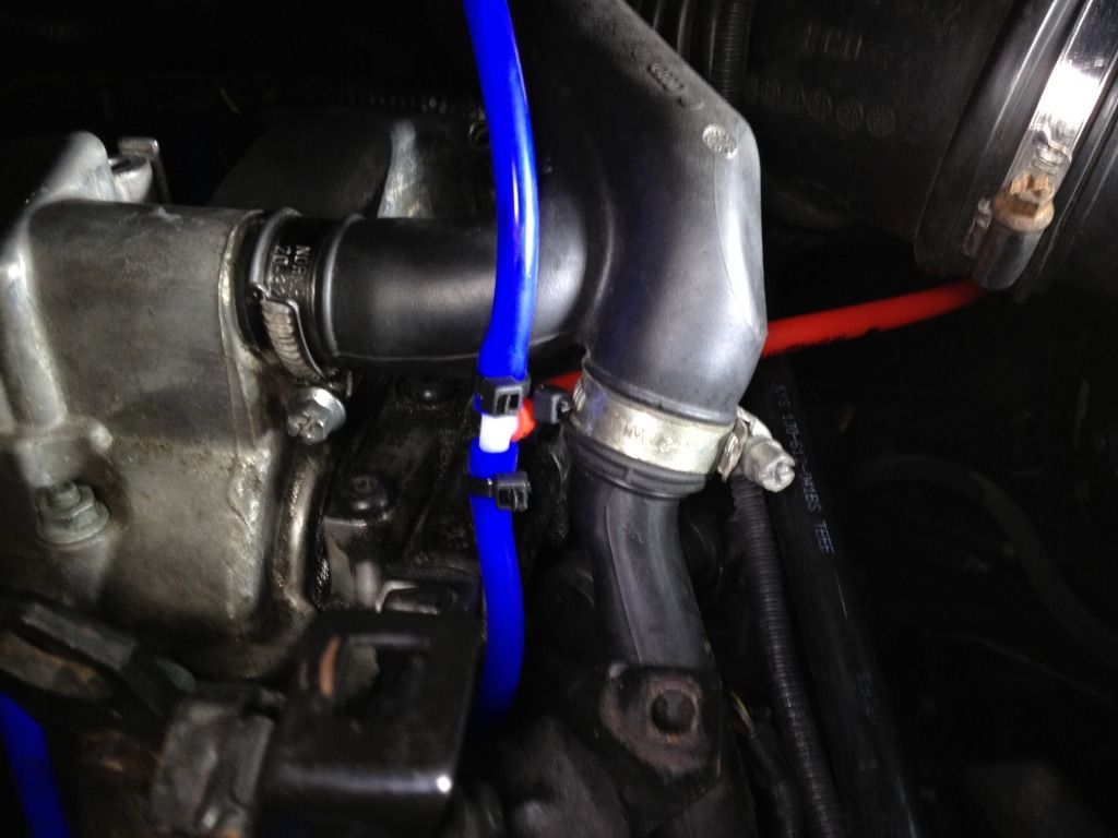

I had huge boosting issues for a while and found a boost leak coming from the charge pipe to pancake pipe, so i tried a new o-ring and sealant but it didn't work so thought i would buy a piece of silicone hose and hose connector to try and fix it, I also bought a prosport boost gauge and the centre vw wheel stickers to replace the scratched and worn bbs ones.....

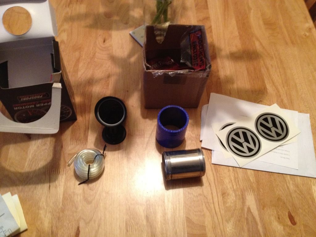

first small delivery (with many more to come  :laugh:)

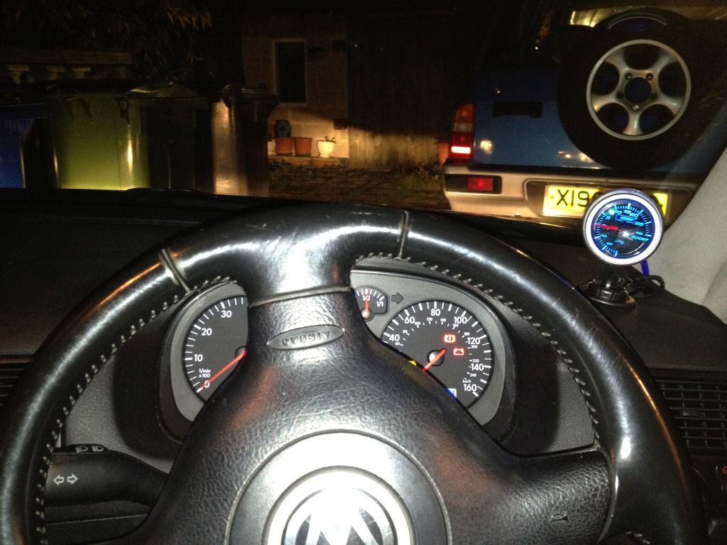

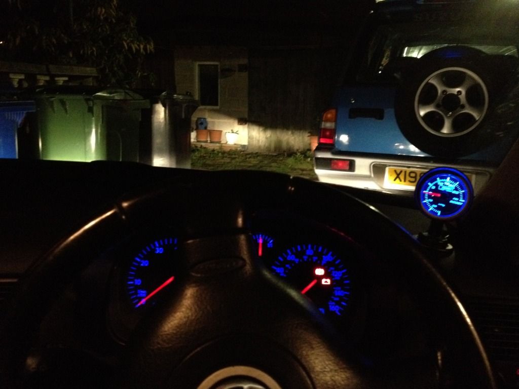

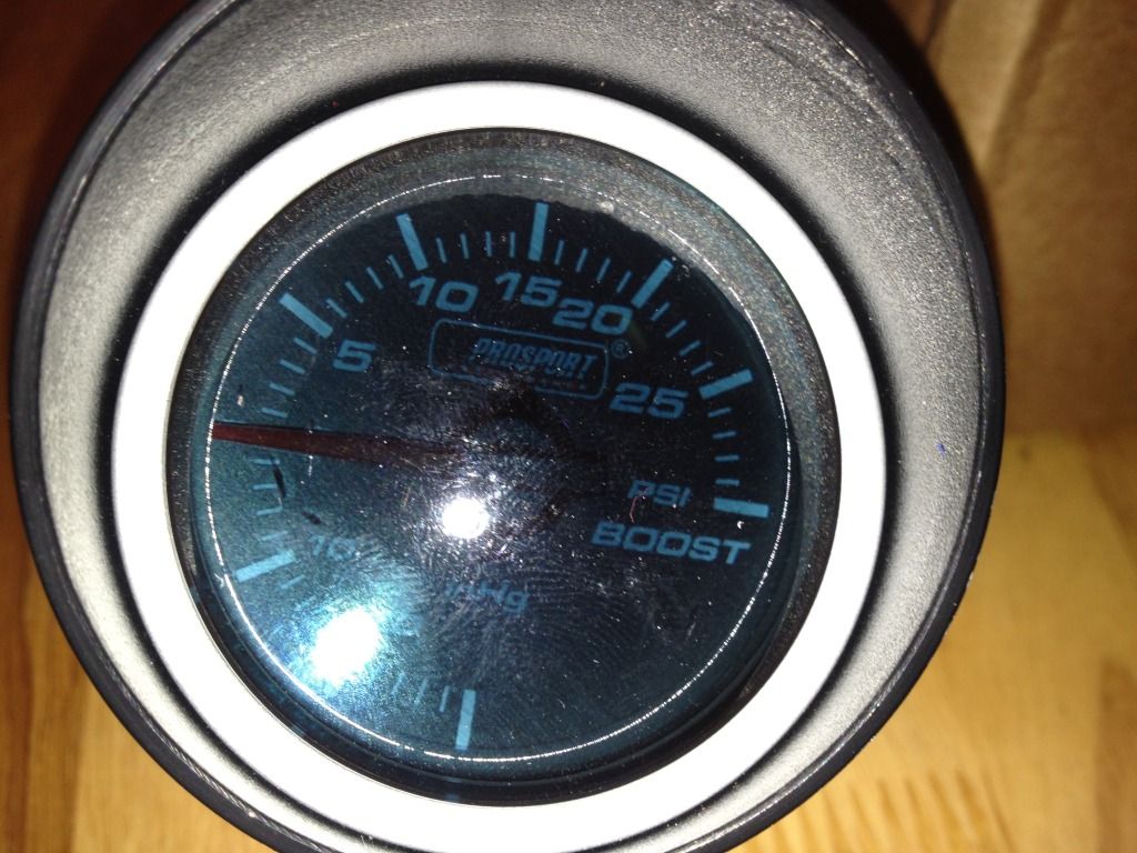

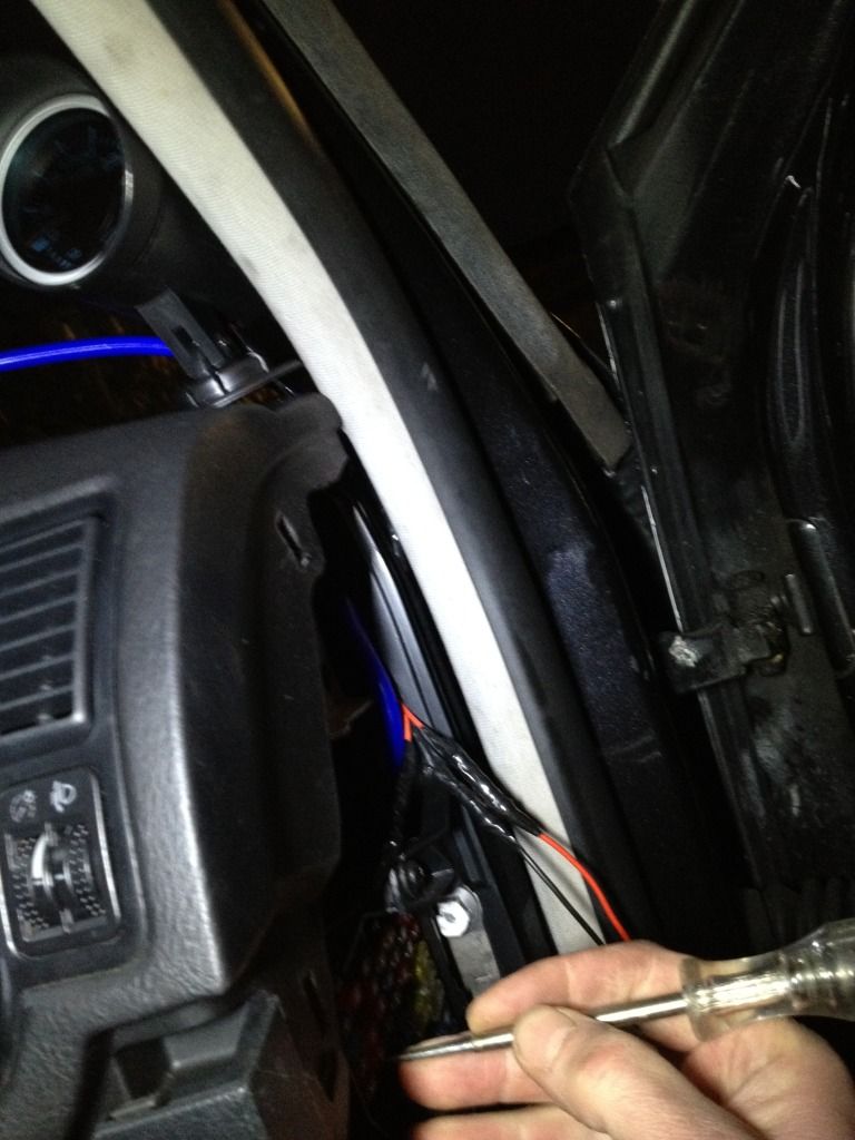

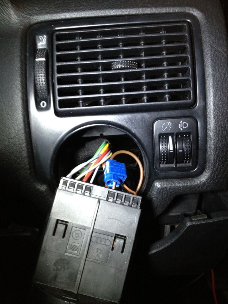

I started doing a few more things towards the end of the year including the boost gauge with a temporary plastic pod.
I originally t'd the boost gauge into the line between the fuel pressure reg and 007p which has since been swapped so that the fpr has its own.
I then ran the hose around the back of the engine bay to the drivers side and went through the firewall through two rubber grommets using a welding rod which took the hose into the drivers footwell. I then ran it up the side of the dashboard to where the boost gauge was going to be placed.
I ran the wires for the boost gauge down the side of the dashboard and to where the fuse board is, I then fed the wires from the appropriate places that it said in the instructions (sidelight switch etc)

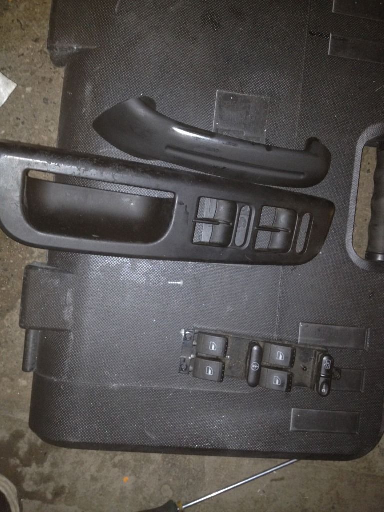

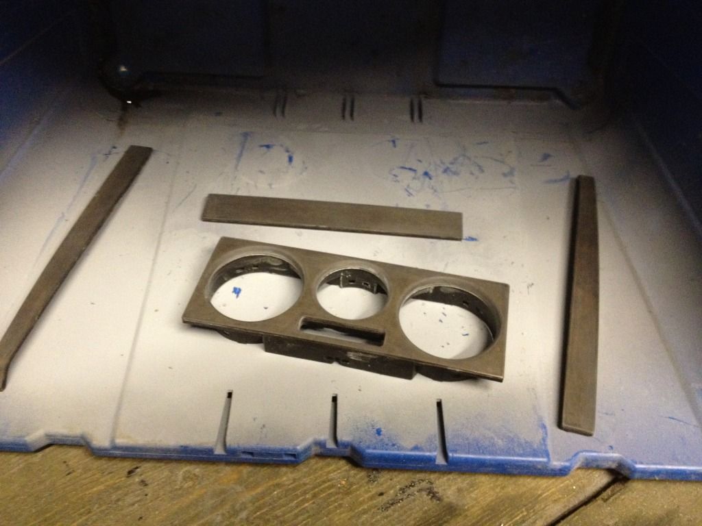

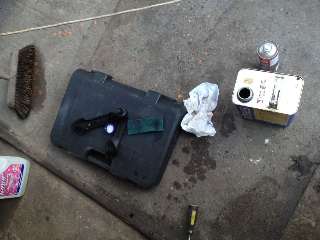

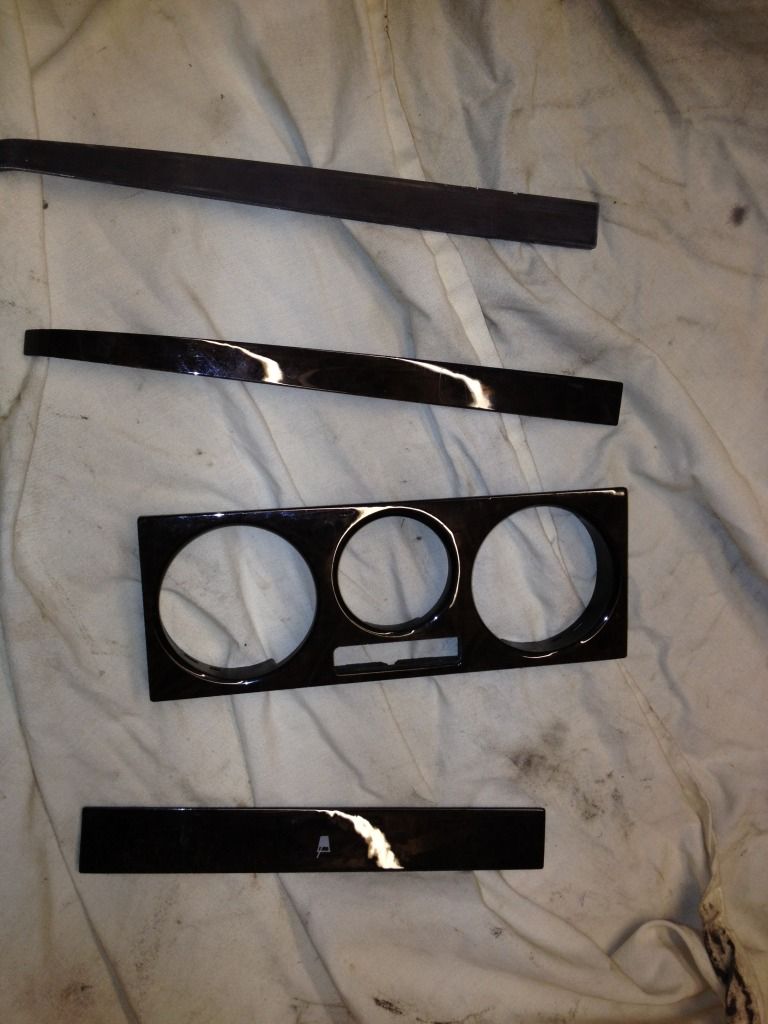

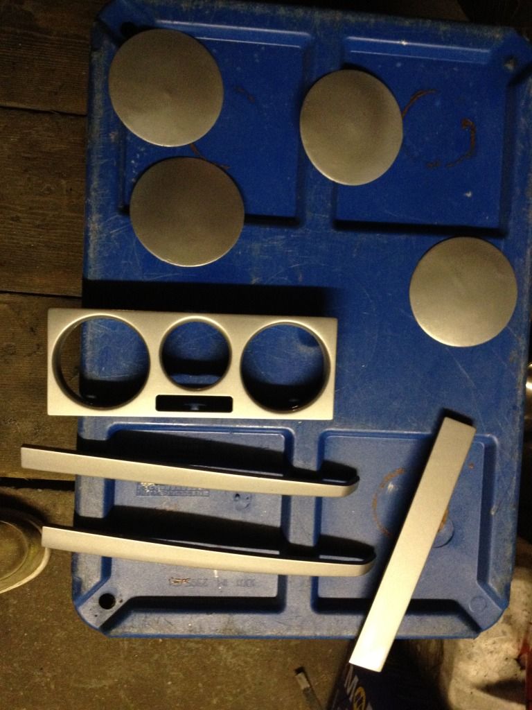

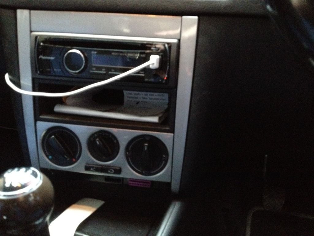

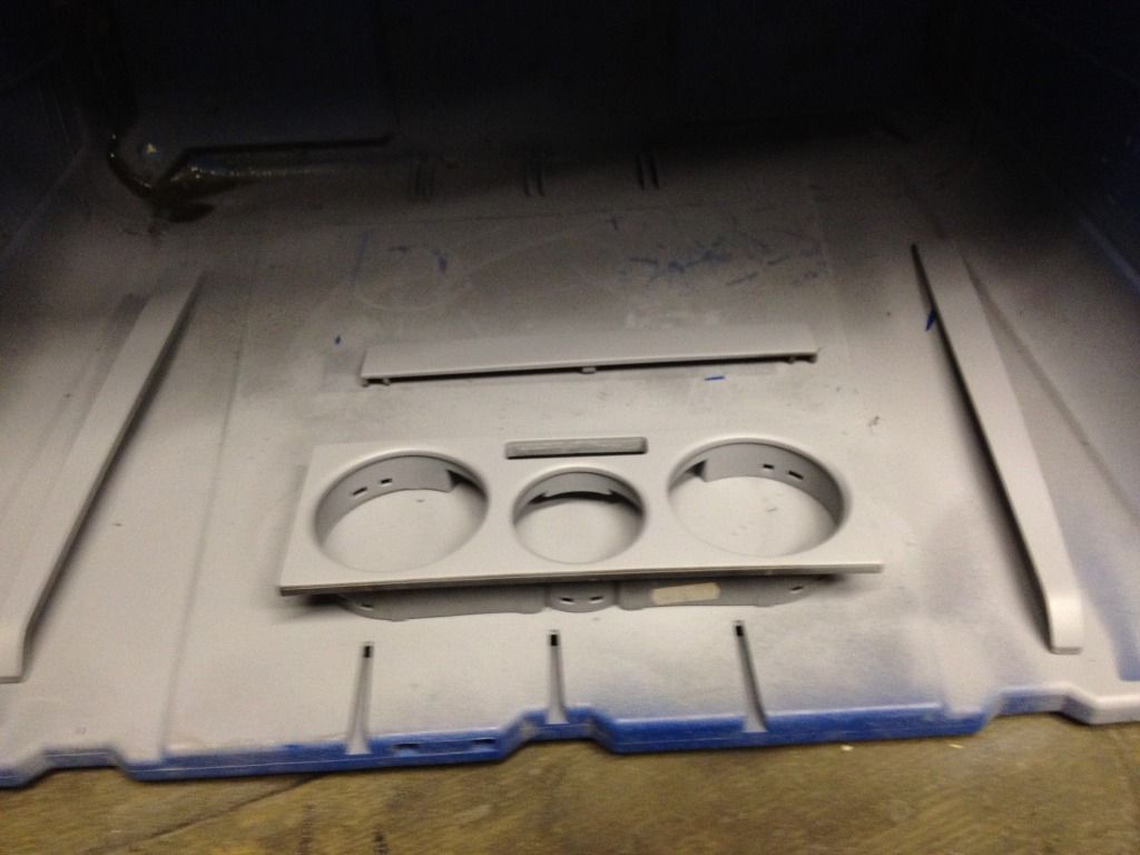

i decided it was time to get rid of the horrid wood look interior  :sick:

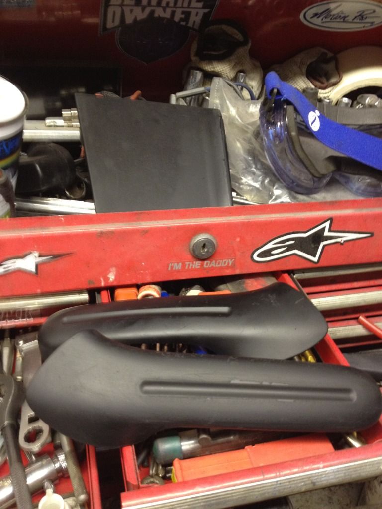

someone had already changed the door handles for matt black one but i wanted to make it all personal so decided to paint it all  :grin:
To start with...
all rubbed down ....
And primed...
And painted along with the backing plates for the vw stickers going on the wheels...
And fitted  :cool:...
(i also did the ash tray but havent got a photo...will try remember to take one  :grin:)
Door handles and ashtray before...
being cleaned
And after painting  :cool:

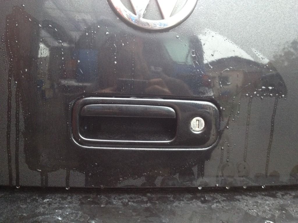

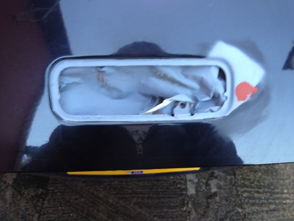

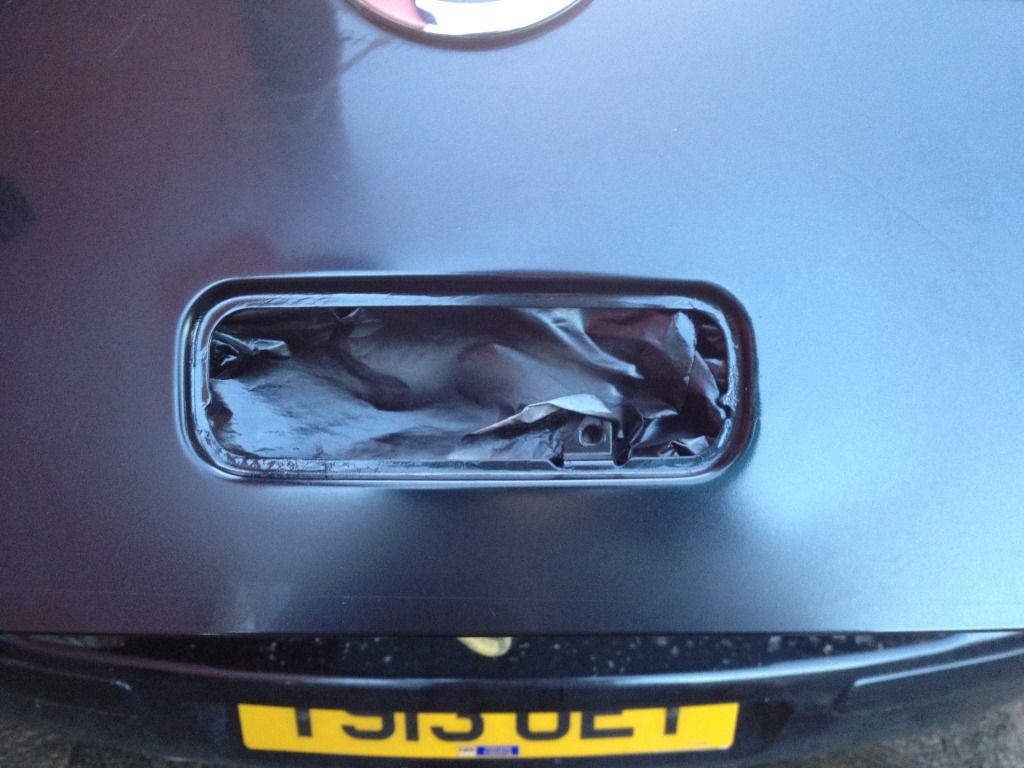

another painting job i did was a large chip next to the boot handle and then handle itself was all corroded etc,
After disassembly and filling etc...
during painting ...
and afterwards  :cool:

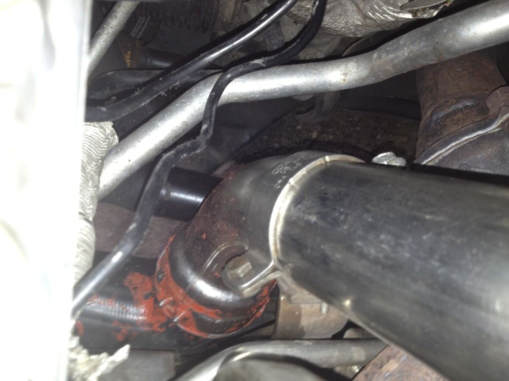

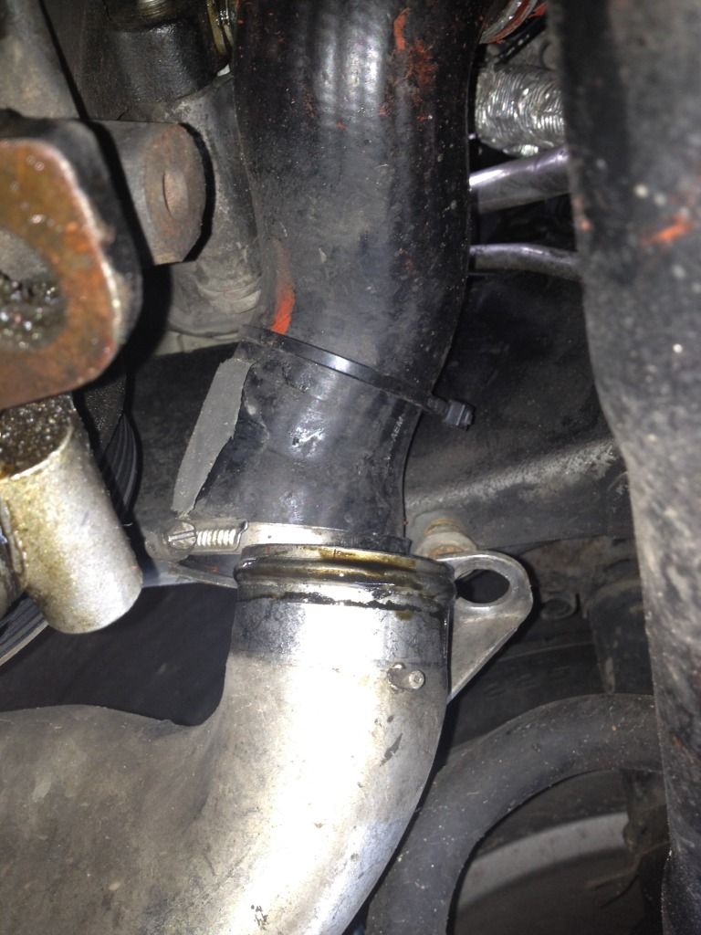

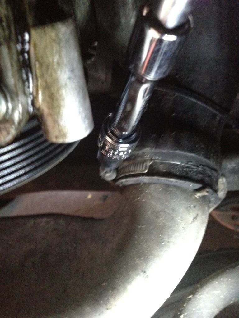

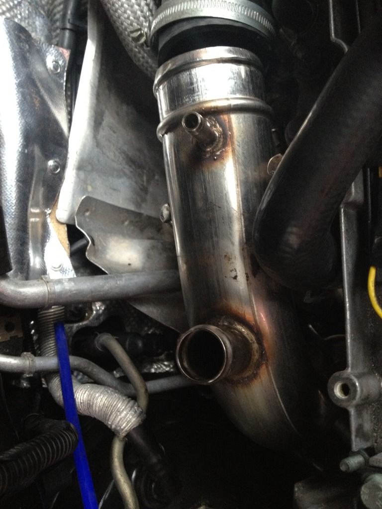

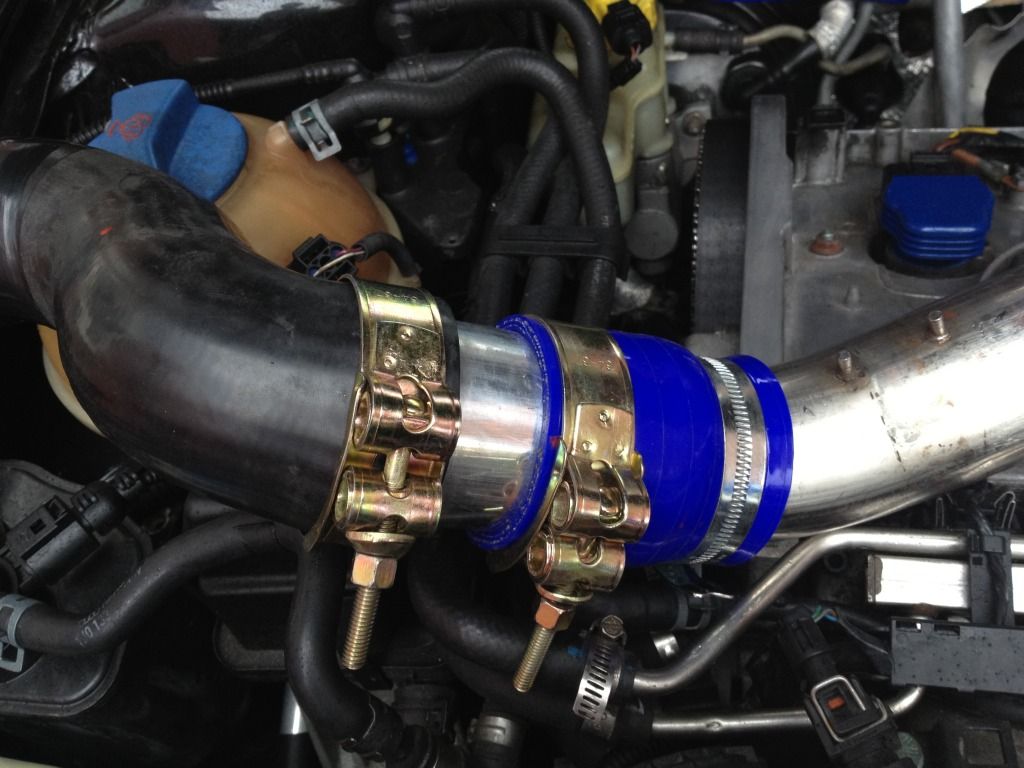

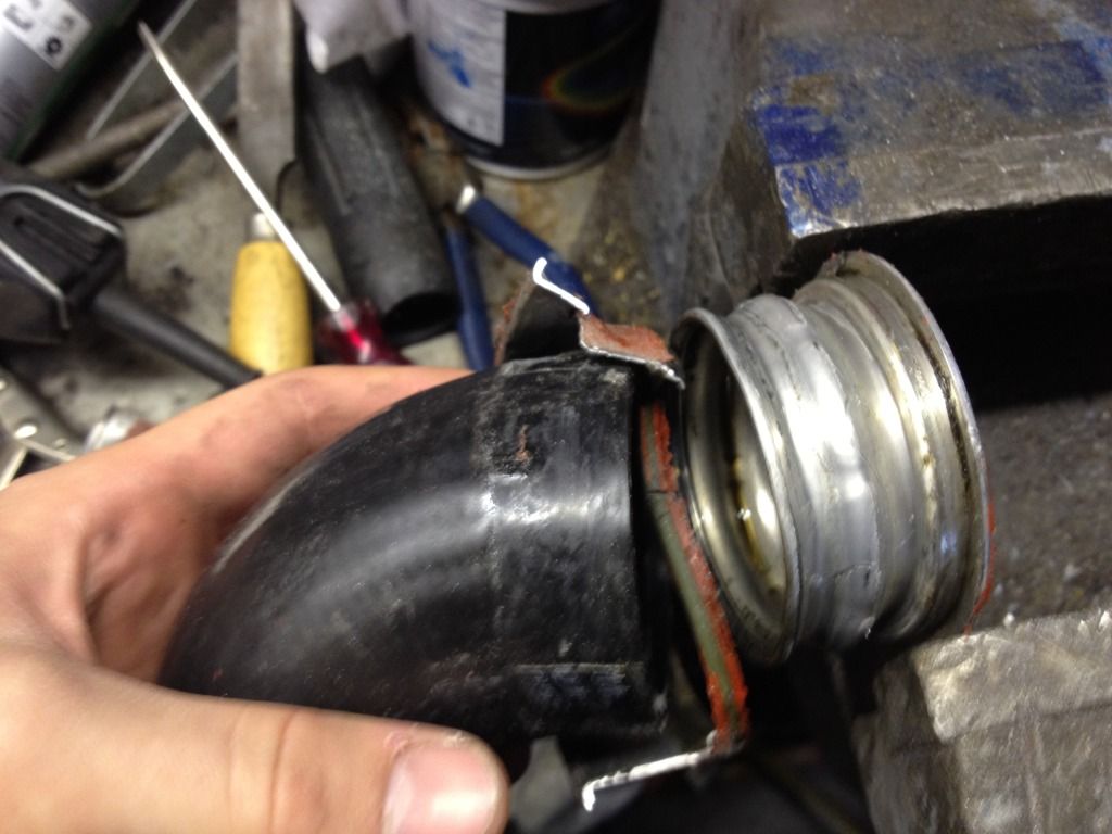

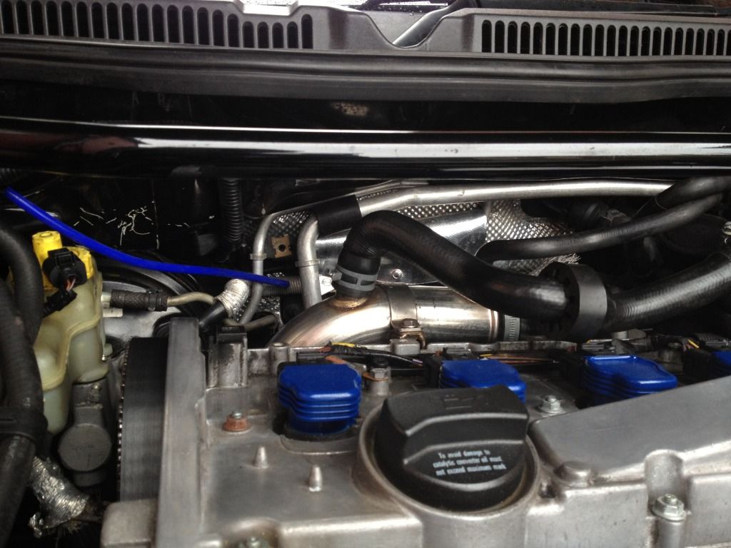

the next job was to fix the dreaded boost leak on the charge pipe - pancake pipe c clip connection  :sick:
I decided to go about it by eliminating the c-clip and using a piece of silicone hose and a coupler  :cool:

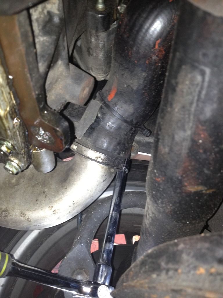

I started by jacking the car up onto the axle stands and then locating the charge pipe at the back of the engine bay
i then removed both the upper and lower clamps...(you can see where i had previously tried using a gasket sealer to stop the leak)
i then removed both the jubilee on the pancake pipe and the small nut mounting it about the arb ...
and removed the pipe
i then removed both the recirc hose and n75 hose on the top of the charge pipe and also loosed the jubilee on the turbo outlet and pulled out the charge pipe
and then with a lot of wiggling and turning i managed to pull the charge pipe out from above, you sort of need to twist it and pull it up a little and then twist it the opposite and pull it some more  :laugh: its awkward but not impossible  :wink:
i then removed the rubber hose...

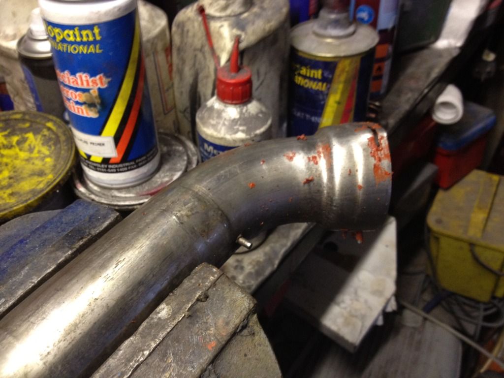

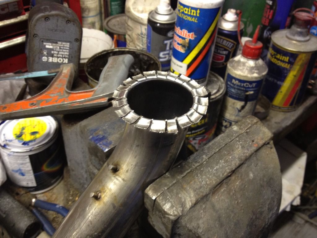

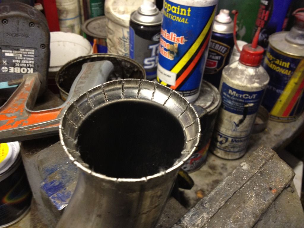

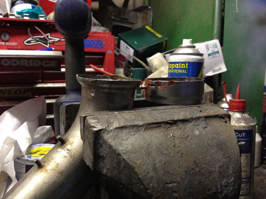

and clamped the charge pipe in the vice
i then proceeded to cut off the end and cut a load of slits into it ...
i then folded them over and flattened them to create a lip ... (i actually shorted them abit afterwards which would have been easier to do before hand)

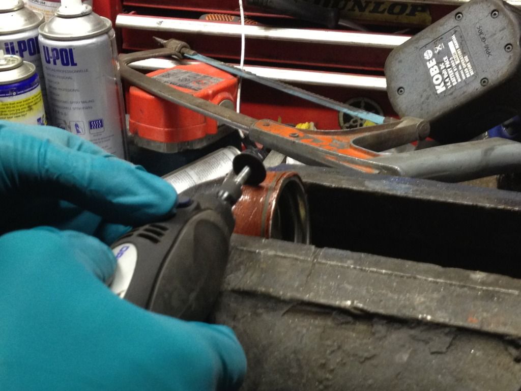

i then removed the metal end of the rubber hose using a dremil and being careful not to catch the rubber underneath ...
i then warmed all the hose in a bucket of hot water to make it all more flexible ...
i then assembled it all together
i then reversed the removal process and put everything back together  :cool:
this mod worked fine but i have since bought i standard change pipe which i checked for leaks and then polished up but have kept this one incase it leaks  :grin:
