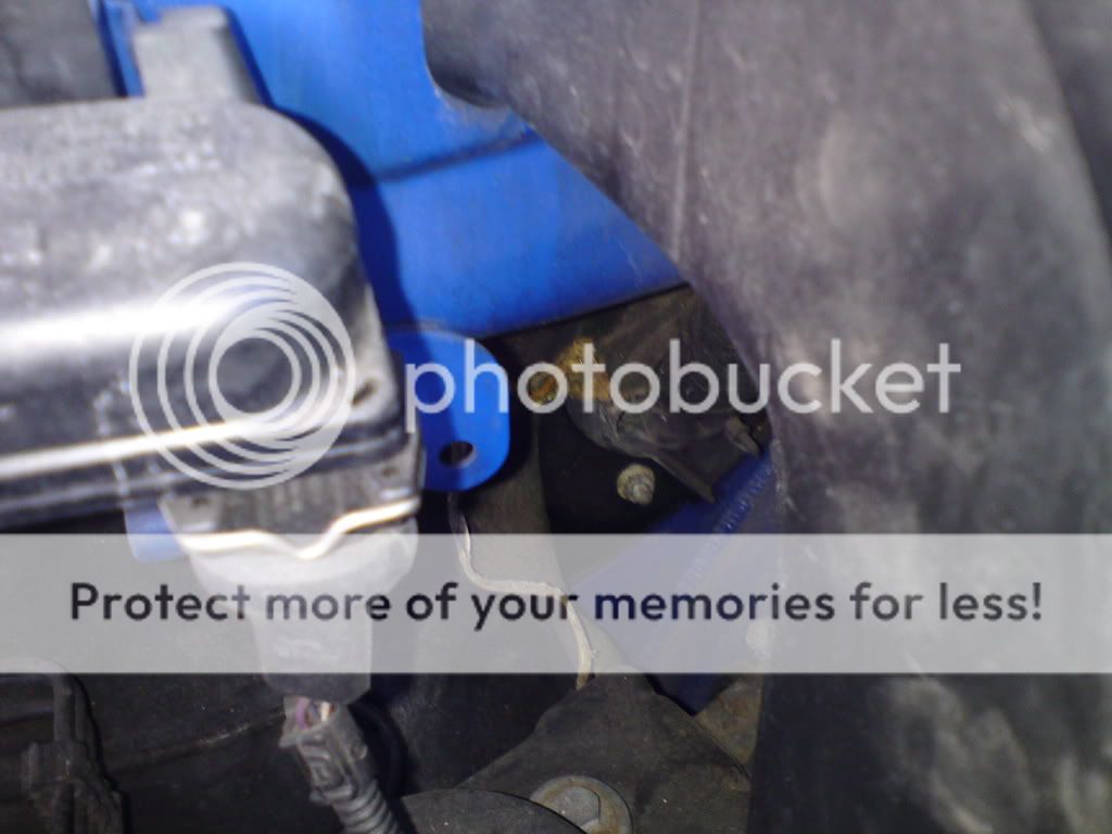

« Reply #9 on: 27 April 2012, 17:47 »
passnger side under scuttle panel you will see where some wires cables go through a gromet into car you can feed through here tape your pipe to a piece of metal and feed it through and it comes out in passenger side you will have to pull carpet back slightly (not much) you then feed it behind dash etc upto where you want it to go heres some pics of how i did mine
