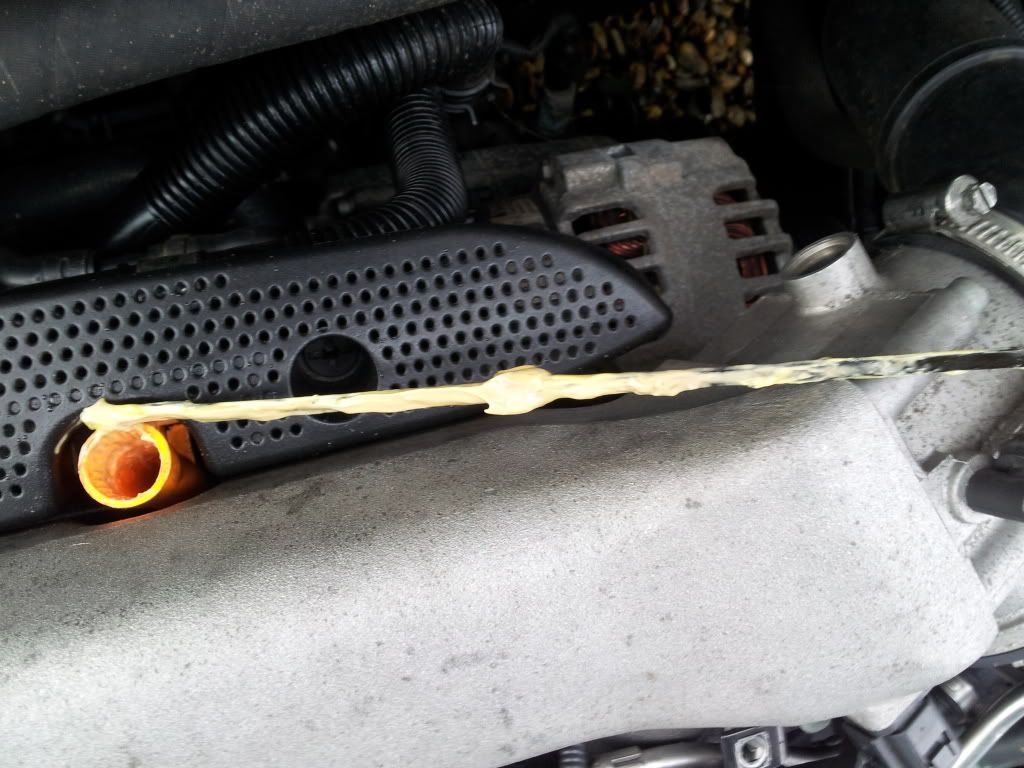

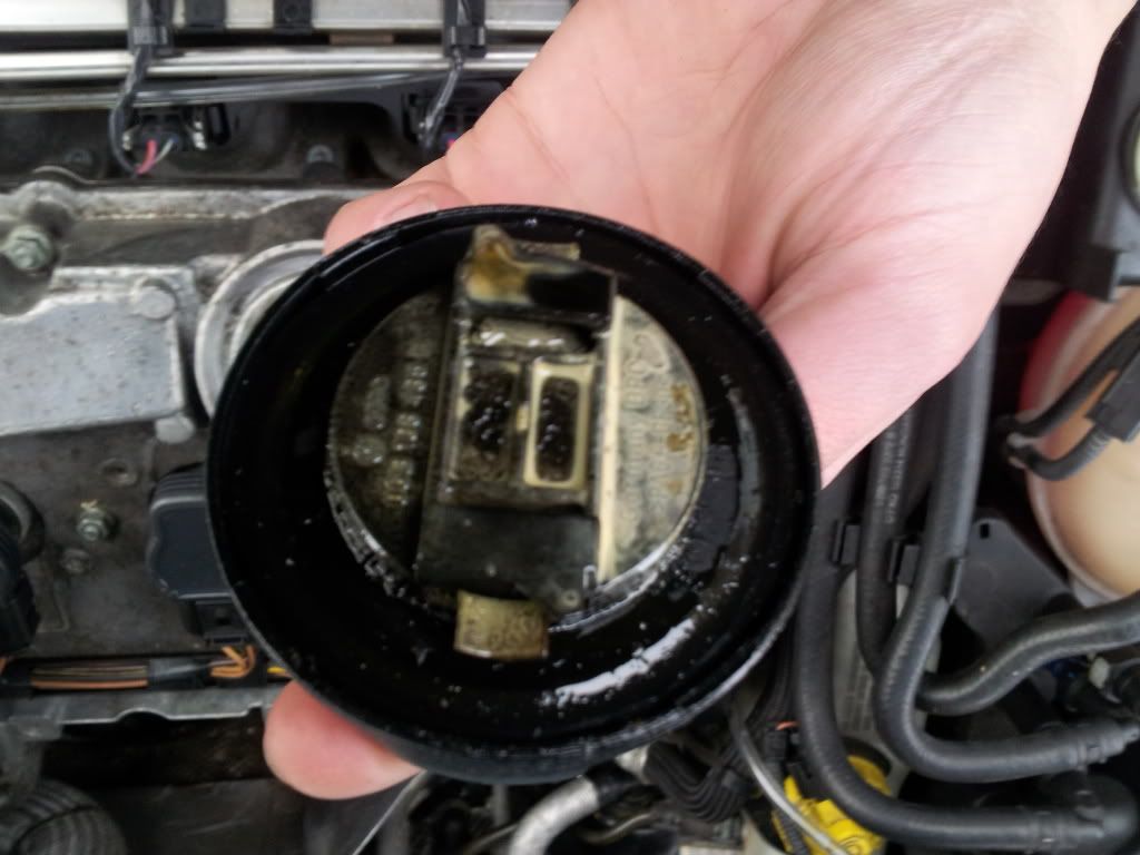

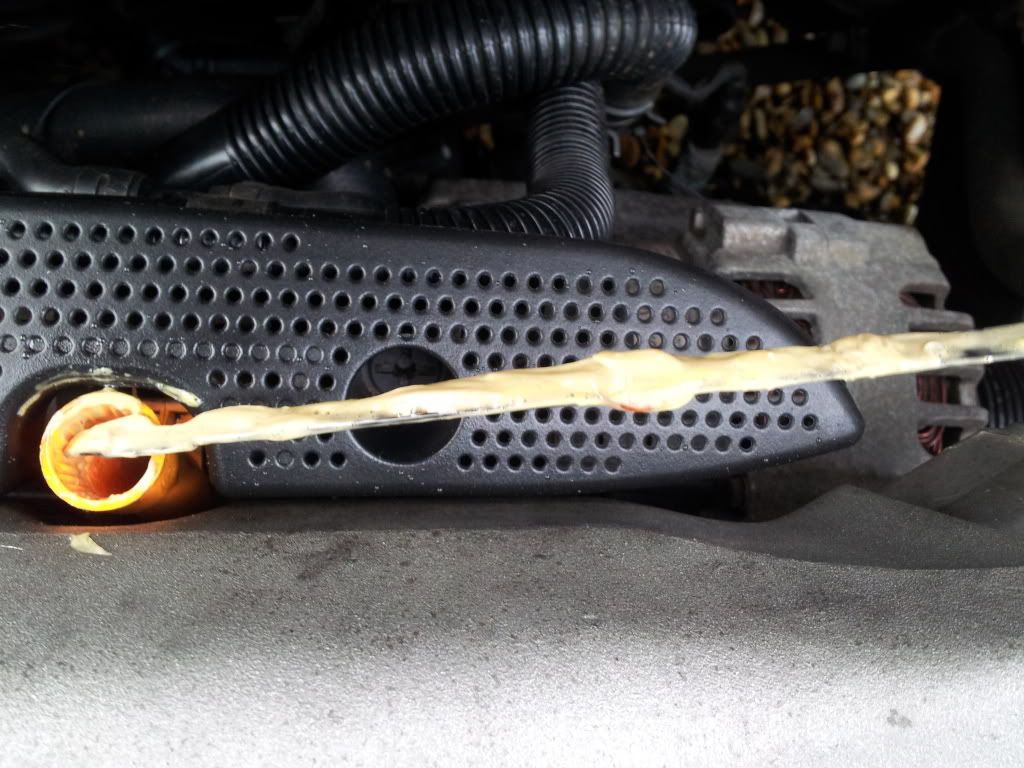

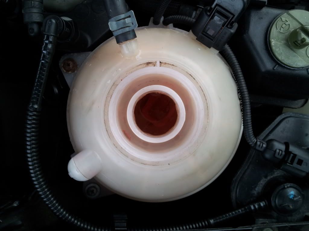

Howdo, fairly mechanically minded and havent ever seen this before so I was wondering if anyone could shead any light on it. Ever since fitting my oil catch can I get a massive build up of mayo on my dipstick guide, quite litteraly mm thick. and a very slight 'dusting' on the filler cap. Not loosing any coolant, nor is it contaminated. anyone got any ideas  :undecided:

You can buy hydrocarbon test strips stick it into coolant and see what colour comes out.

Il try get a comp test done this weekend anyone know the figures I should be achieving?

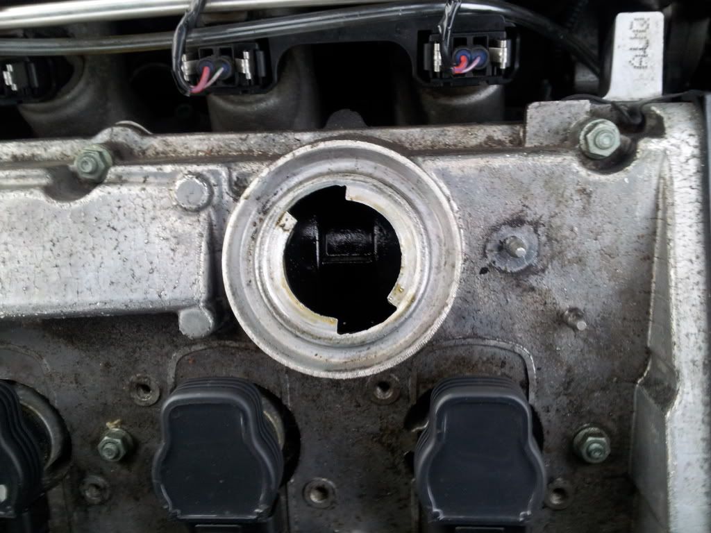

if it was the head gasket would there not be more in the filler cap and inside the head?

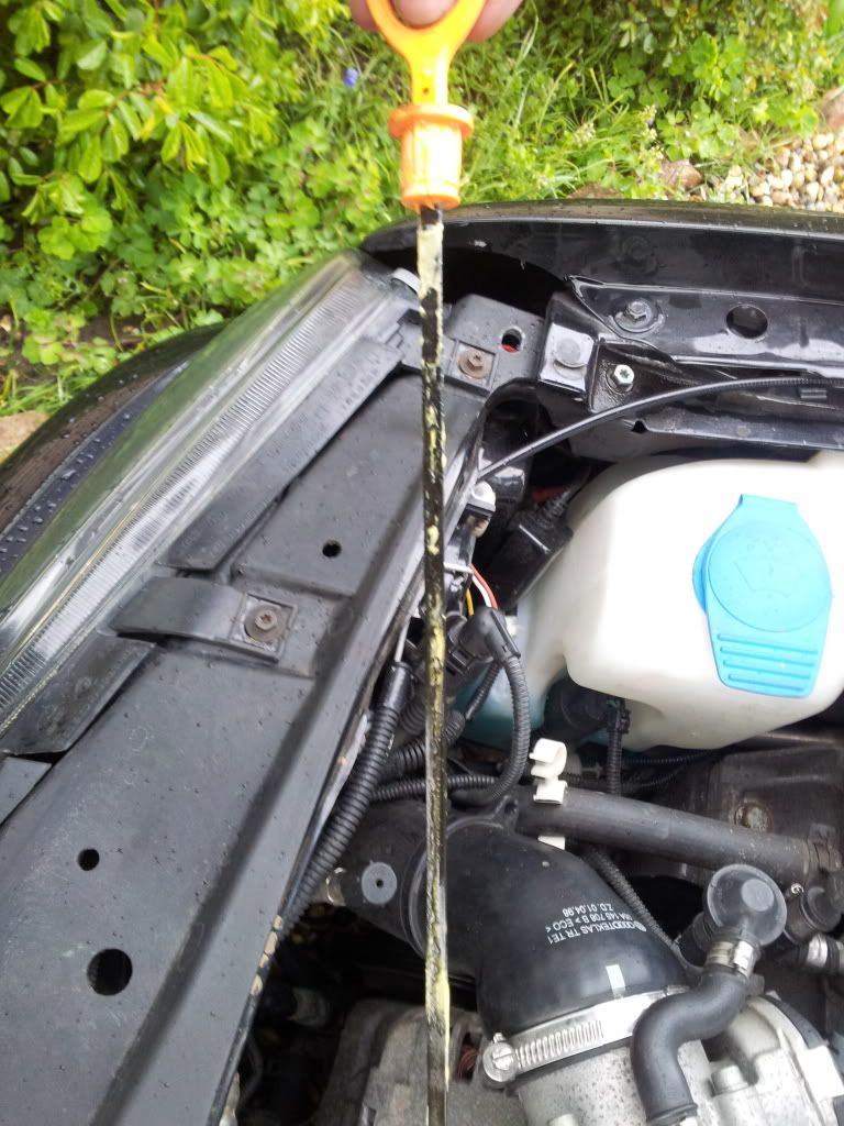

On the dip stick the gunk look like it goes right down to the sump but I think its all collecting in the guide so when you pull the dipstick is pulled out it covers it all. Reason I say this is when I wiped the stick and put it back in  normal coloured oil was appearing on the guide
