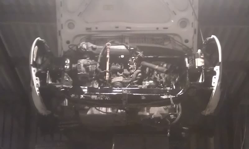

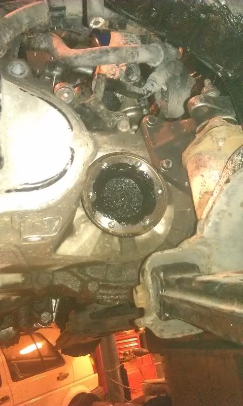

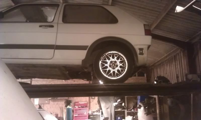

Polybushed crossmember back in, also engine, with gearbox to ponder over shafts.
02J shaft trial fit, just for sh!ts and giggles, too long.
02A cups fitted, 02A shafts fit.
Temporary wheels fitted.
Project: Mk2 20vT trackslag
Daily: Mk2 GTI typ19
