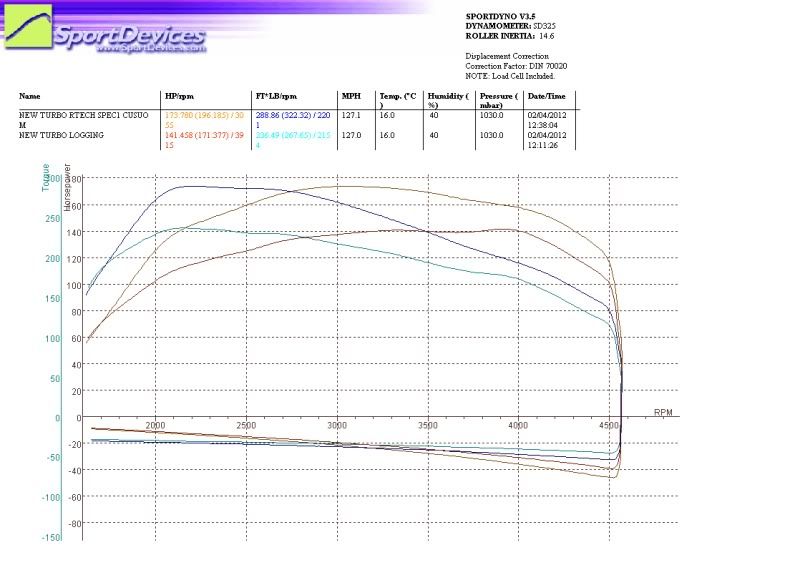

Just been to r-tech for remap after having fitted brand new turbo as they said it was overboosting ....well what can i say !!! its never gone this well since ive had it ....had it remapped at chipped uk 5 years back and has never been right ...supposed to be like night and day when remapped but mine never was ....until today !!!!

Those are some savage figures mate!
I assume you have a 'newish' clutch? Was that a custom map or just a spec one?
