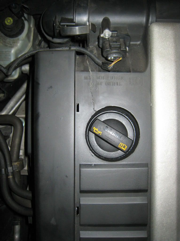

Also forgot to mention air box needs replacing, as that just case of buying box, and change yourself as they want £260.! think i read somewhere on here its part of engine cover, i might do a search on this forum.

What about time passing means the lights need adjusting?  :huh:
What's wrong with the airbox?  :huh:

As for the airbox, it just says air cleaner housing broken, has been glued, require new air housing. I can see a crack which goes up to the end of the cover?

thanks all, managed to get bosch s5 battery, it was £85..nearly as much as VW, but its 5yr warranty and decent spec. now the ignition turn is much better/quicker  :smiley:. Think that was the most helpful comment they made, as they said it was knackered. now with the broken airbox, is just that damage i posted pic of and assume they were being over cautious in getting me to change it and part with some dosh, judging by the xenon comment.

« Reply #9 on: 22 March 2012, 19:51 »
