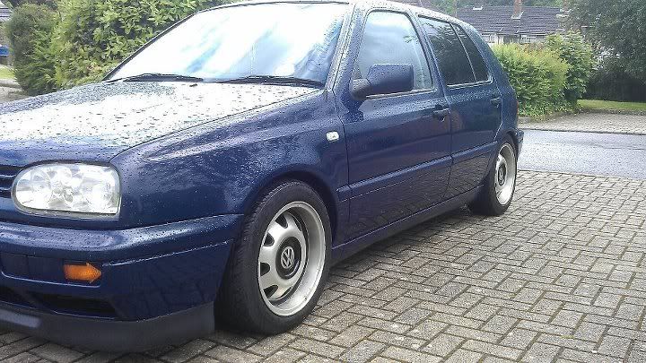

no dishes are some silver/very light gold looking paint, i will be making them bare metal polish them up etc but that much later down the road.
since they put them on tho when i break i can hear something rubbing! thinking maybe its the weights they put on as there is not much of a gap from breaks to the back of the alloys!

these are my old tyres, couldn't wait to get new ones. when i do get new ones thinking 175/50 or 195/45 but yes the front end needs lowering very much so. just no C spanners.
Under heavy breaking or all he time? Could be tyres catching the coilovers

i think just under breaking, Hmmmm is this bad? was told 195/50 would be fine on them. there 7j 15 et28
Easiest ray to check is have a look on the inside tyre wall, and see if it's warn at all

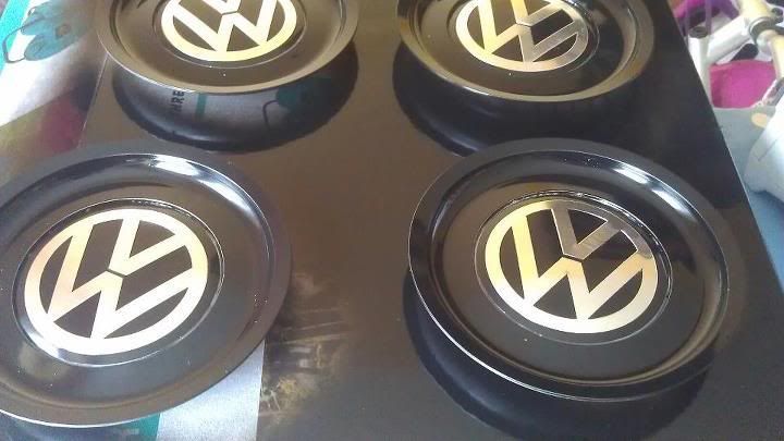

Little update: but its the little things that make the big things look better ;-)

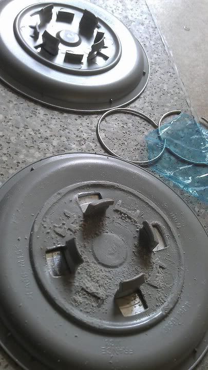

ok so wanted some center caps when i came across a little DIY with golf mk4 center caps here it was.

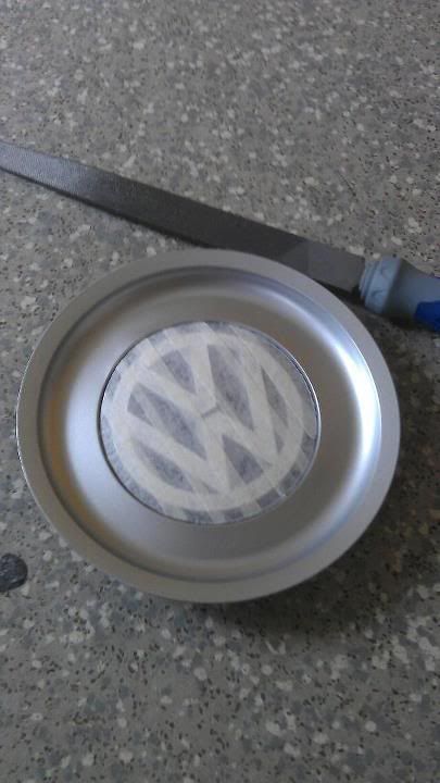

Step 1: remove ring and take off little lugs. i shaved them down.

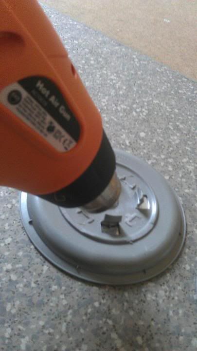

Step 2: Heat up bigger lugs and move them in slightly for a tighter fit.
Done now center caps will fit ATS CUPS!

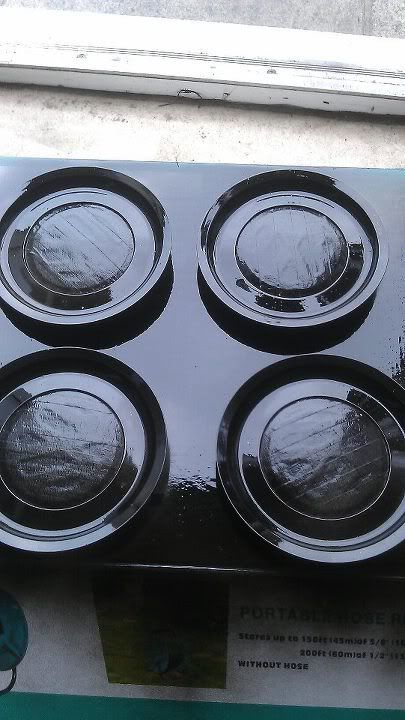

Step 3: Mask off area i wanted to keep.
Step 4: PAINT!!!!
step 5: unmask your art work.
Step 6:
TADA!!!  i like these i must say.
