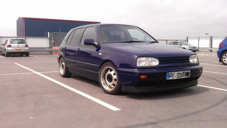

I agree with Sean! Such an improvement with the new alloys and a healthy beating with the lowering stick :)

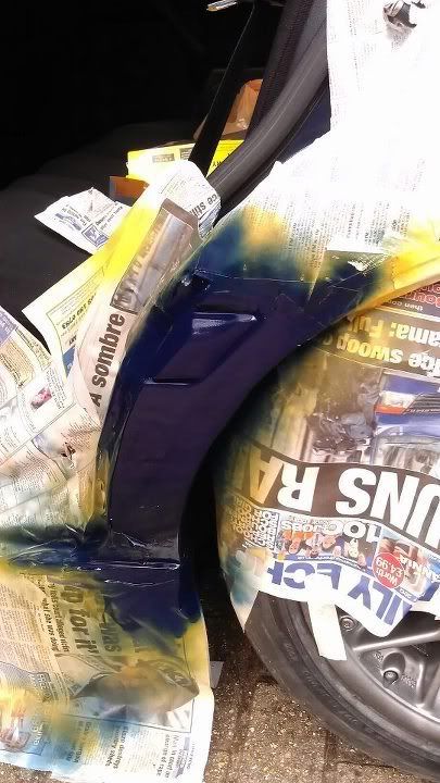

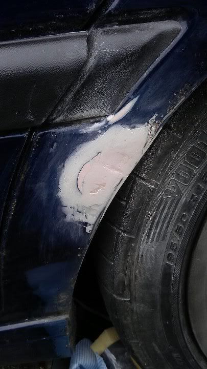

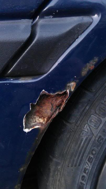

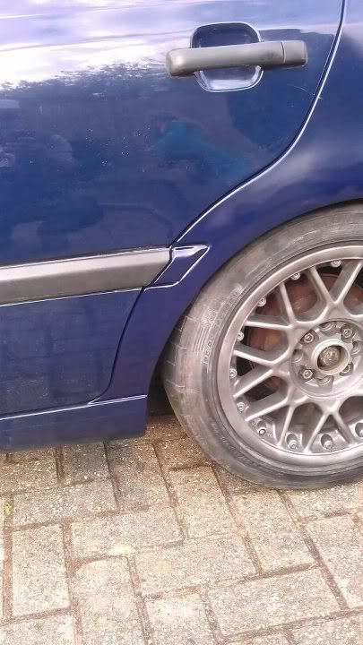

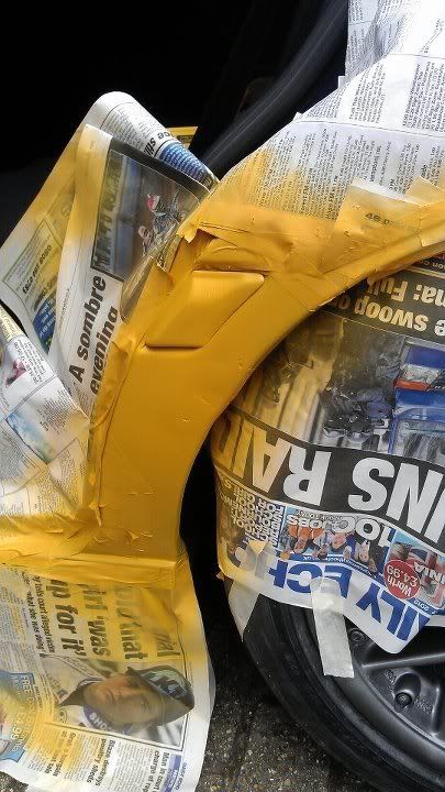

little update:

Looks not a bad job takes your eye of it anyway. But unless the rust has been treated or removed it will be showing through again in a matter of weeks.
Offline murraymint
  • Posts: 3,022
Re: Golf MK3 CL (Project)
« Reply #105 on: 17 May 2012, 18:32 »
Why didn't you remove the trim? Or have you plans to colour code?
josh
Offline Khare
  • Posts: 7,626
  • The bear that khares
« Reply #106 on: 17 May 2012, 20:47 »
Was just about to say about the trim. Even if you were colour coding you'd want to paint under it, to avoid old colour from different angles.
Are you going to blend it in?
Offline search
  • Posts: 898
« Reply #107 on: 17 May 2012, 22:27 »
i'm getting new trims and could't be bothered to take that bit of trim off to do the job LOL.
the car was rusting inside out. turns out the whole panel is rusted from top to bottom due to broken seal on the roof and a rusty hole under the seal, making my boot wet and my back seats. so i used unibond sealant under the seal on the roof and stuck it down. then fixed the hole at the bottom.
