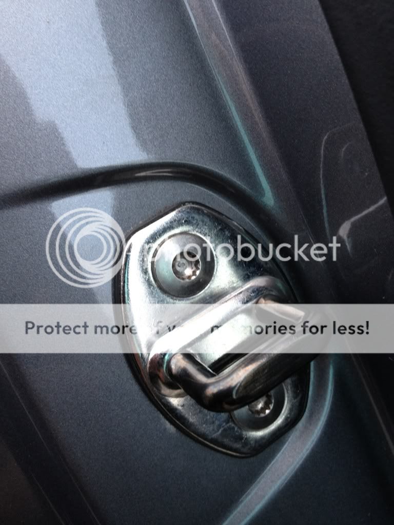

Literally 5 minutes ago i've sat in every seat in the car and poked, pushed, pulled all 4 doors, i've now found thats it's the off side rear door which is making a majority if not all of the noise, it seems to be able to move around an alarming amount!! :shocked:
I think a trip to the dealers is in order before my nan falls out the car!!!
Is there much adjustment in the hinge or latch?
Cheers.

yeah you can adjust the strike pin to pul the door into the body more

I know that this is starting to go off topic but i went to the dealer yesterday for this and they were next to useless and weren't really bothered, so next question, what type of bit would i need for this? I know it's an 8mm and not a torx but what is it?

thats a spline bit.. its a VW favourite  :smiley:
