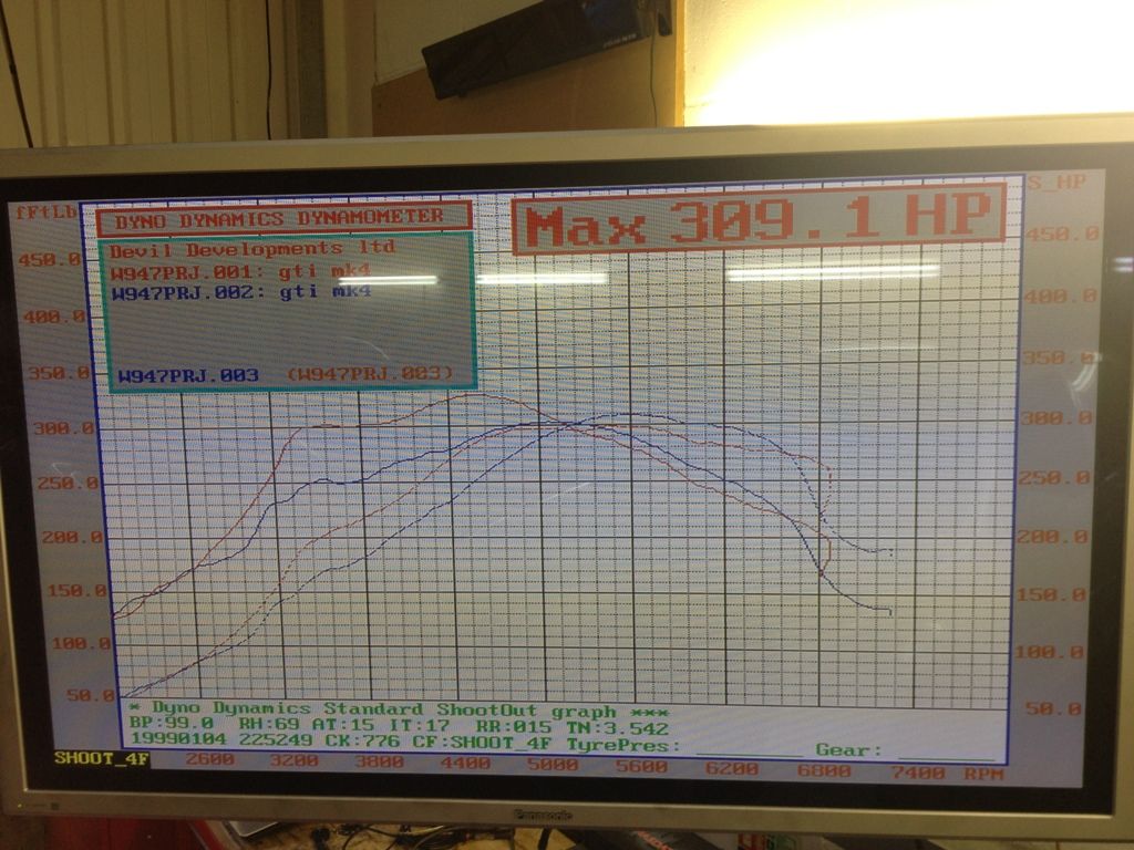

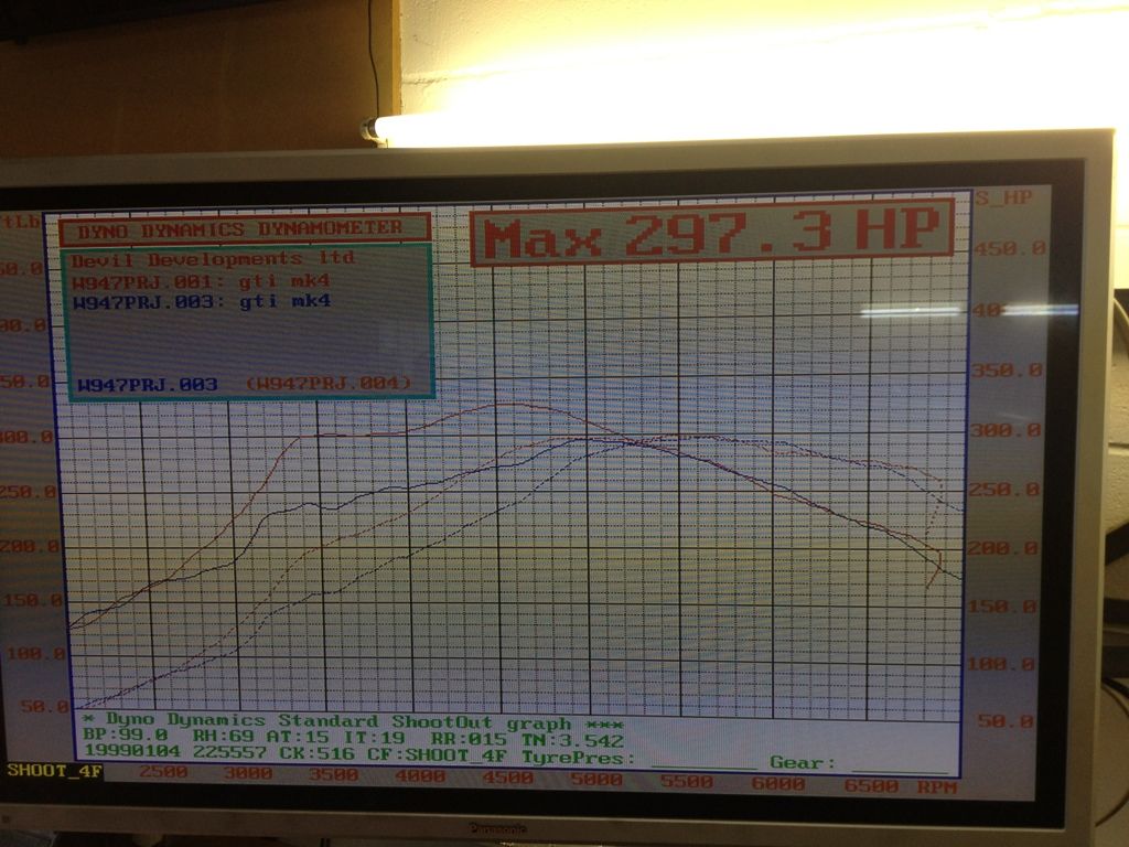

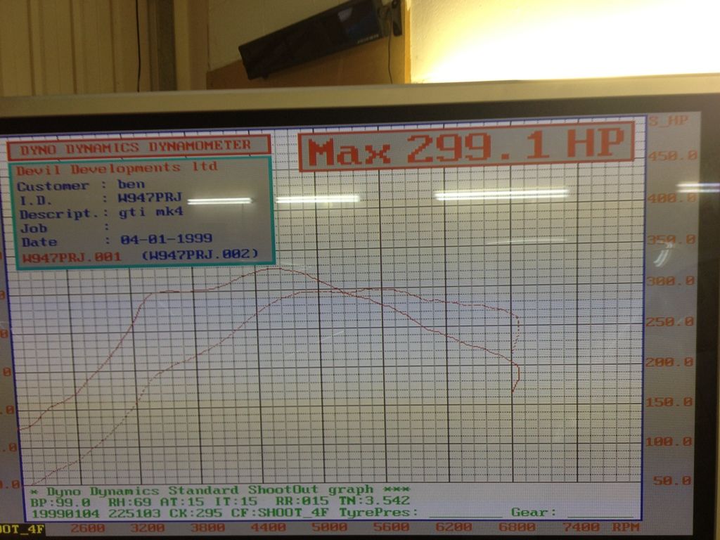

Theres something a miss with those dyno plots.
What was the weather like there at the time? Raining? Overcast?
Dyno weather conditions show on the graph as:
BP = 99kPa
RH = 69%
AT = 15º
IT = 15-17º
Which doesn't follow weather in the actual location, which will affect how dyno uses correction.
