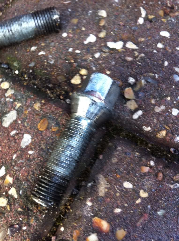

had a look at bolts and these are the ones they have atm?

They are tapered bolts.
Offline jnufcuk
  • Posts: 2,145
so they are correct atleast must have just worked loost then or someone undone them  :lipsrsealed:
size is correct?
will have to get some more then. Will hopefully try the place wayne suggested.
Thanks guys

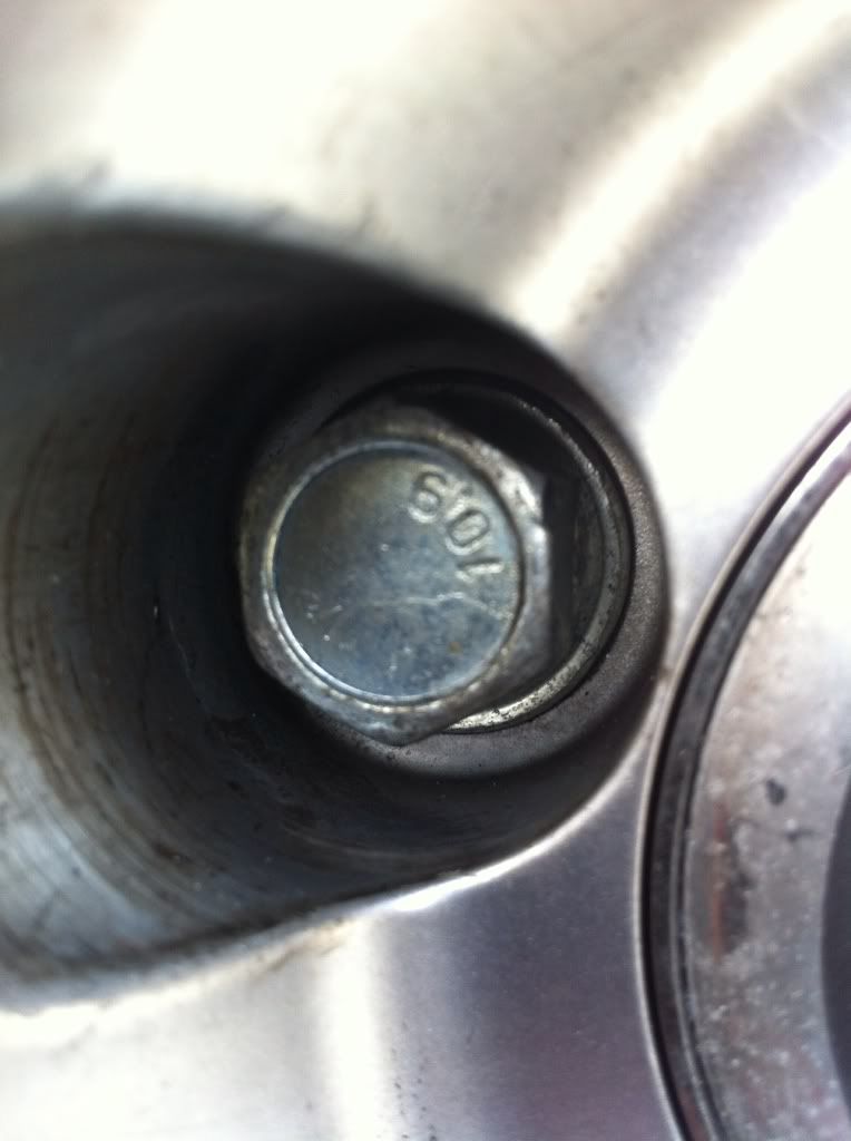

p.s. just found out the are cade berns 710 :smiley:
Re: what wheel bolts do i need for my wheels? UPDATED with Pics
« Reply #16 on: 19 January 2012, 16:10 »
This to me looks like it has been overtightened  :undecided: maybe the spacers are causing issues
Offline Steve_PD
  • Posts: 7,121

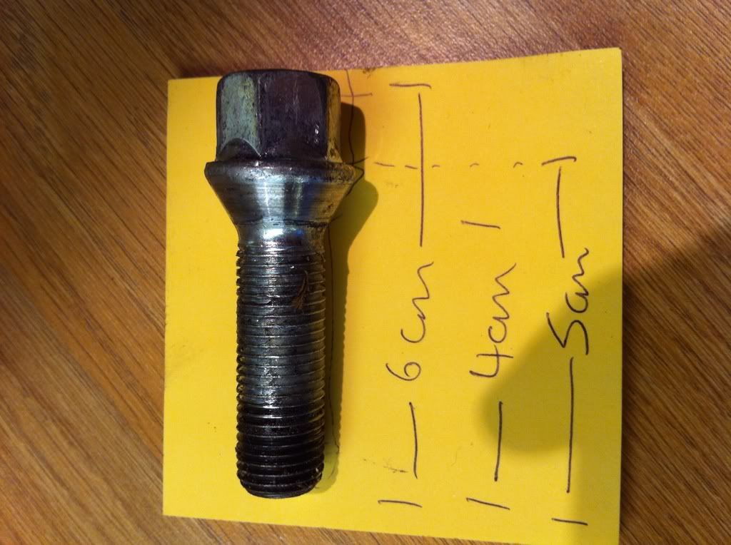

40mm bolts, they the ones which go through the 20mm spacers? Did you torque them up?
Offline jnufcuk
  • Posts: 2,145
yes theyre the ones which go thru, dont have a torque wrench so just done them tight?
Been to about 3-5 different wheels places and non have any bolts that size  :sad:
got myself a torque wrench and copper grease on the plus side lol :grin:
question is now:
what size would normal bolts be as i may take of spacers off for the time being until i can source some longer bolts.
Thanks
