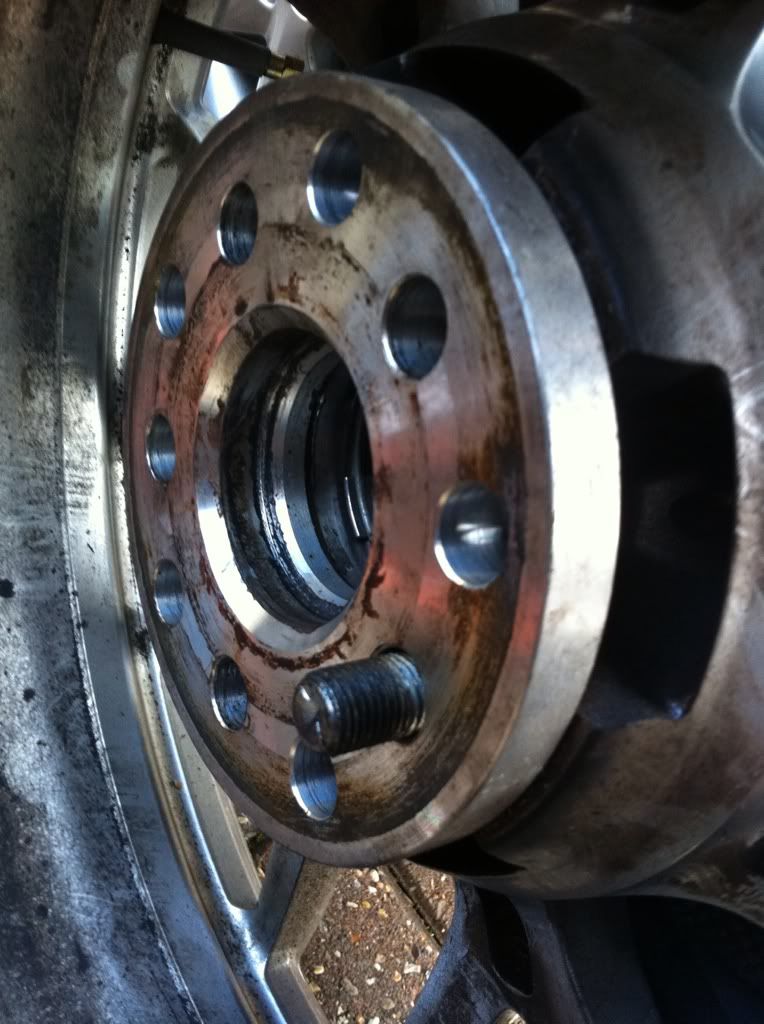

this is how much us going into the wheel hub? is that enough.
just found this site which has differnet sizes http://caraudiosecurity.com/shop/search_result/keywords/wheel+bolts/desc/1/x/0/y/0/pg/1.html
so i need M14 x 1.5 x ??
just using the bolts that came with the spacers so thought they would have been ok  :grin:
Thanks

well standard are 27-28mm just add on 20mm =47-48mm should be ok then mate i know how you feel cos my front ones come loose not to long ago is quite scary mate wasnt my fault though the garage didnt do them up properly  :shocked:

ok brill need to source some standard bolts lol
the 27-28mm is that the thread length? or bolt length?
sorry being dumb here  :embarassed:

should really have 50mm bolts with 20mm spacers. standard bolts are 27mm + 20mm

That ebay link is the correct bolts but you will need to buy a locking set as well which unfortunately only come in 4's :sad:
