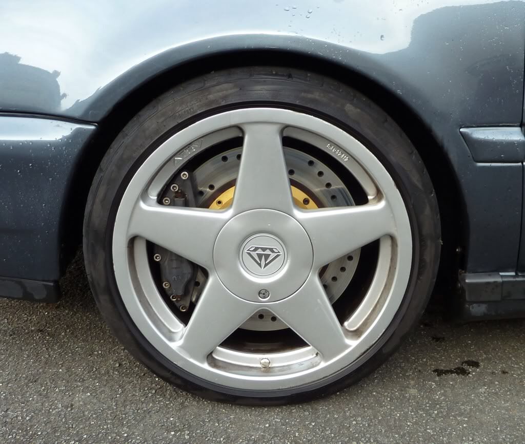

Hey, does anyone know if these brakes off a late mk3 will fit a mk4?

There not standard mk3 brakes but I'm sure anything you can fit to a mk3 will somehow bolt to a mk4 maybe with little changes possibly  :undecided: They look like a nice set though probably 312-334 mm 4 pots nice  :cool:

Do brakes such as cupra r brakes for a mk3?
It's jut got the chance to buy them and wouldn't mind knowing 100%

I don't think so you need to make a bracket for the mk3 and i'm sure it's the same for mk4 but there is a company on piston heads who make the brackets for 4 pots you will have to have a search around for some, sorry i can't help anymore  :sad: might be worth asking were to get caliper adaptors from in the mk4 section  :smiley:

Sorry forgot about the adapters I knew they don't for directly but ment do the mk3/mk4 use the same adapters haha

As long as the mk3 is 5 stud they should fit.

Ok cheers mate, do the mk3 guys put
Mk4 or cupra brakes on then?

Yes the 312mm mk4 set up is a common conversion on a mk3.
