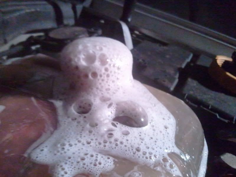

06 astra estate 17 ctdi
seems to be over heating but no lights on dash or running problems im gettin a foam like substance out of washer bottle
theres no oil in water or visaversa
ive changed thermostat and flushed system best i could with a hose  its doin the same any one got any ideas
heres the foam  :shocked:
cheers lee

looks more like the expansion tank for coolant to be.
if it's broken, replacement  headgasket at best more likely cylinder head

that's obviously the coolant tank. it appears that your coolant system is pressurising.

Just shown the lads at work.
First response was has someone used screenwash anti freeze rather than radiator antifreeze  :shocked:
They have seen this done before and it is a complete twit to fully clean out of the radiator system.
And you have said the washer bottle and not expansion tank  :lipsrsealed:

Next question
What work has been done on the car lately ?
