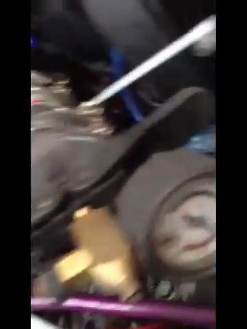

I did the test today, <a href="http://s1197.photobucket.com/albums/aa433/golfyste/?action=view&current=5fceed91.mp4" target="_blank"><img src="http://i1197.photobucket.com/albums/aa433/golfyste/5fceed91.mp4" border="0" alt="Photobucket Pictures, Images and Photos" /></a>. ( dunno if that will work)
But I seemed to loose about 10psi a min but I couldn't really hear any air escaping apart from the sound of oil glooping.
