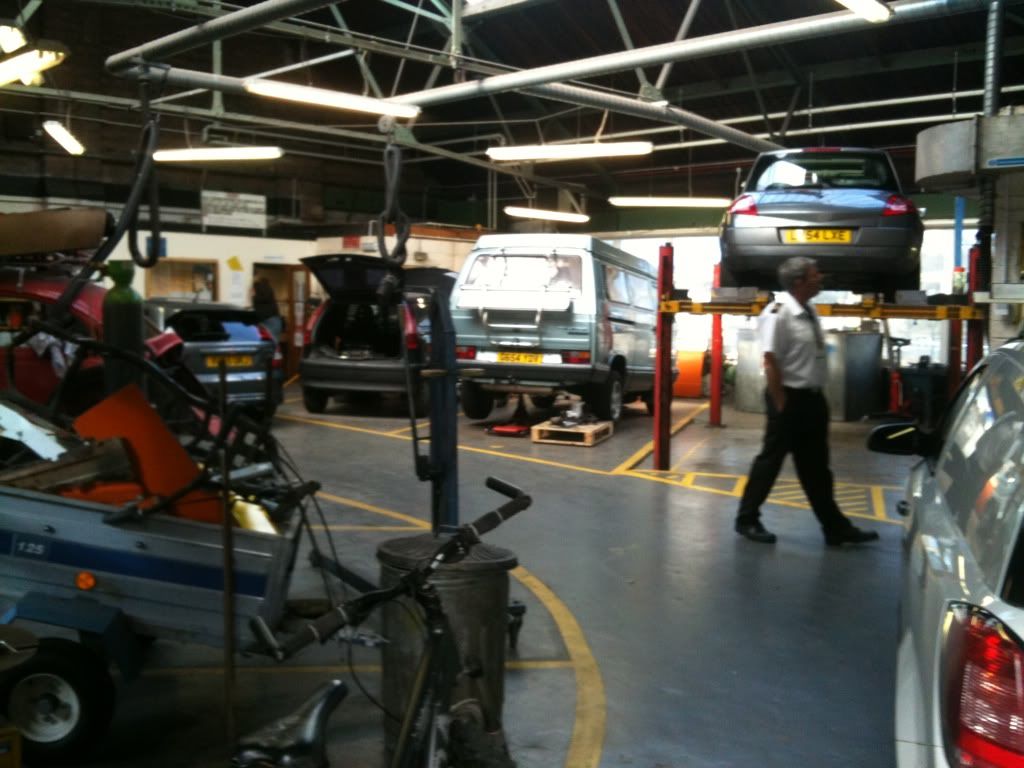

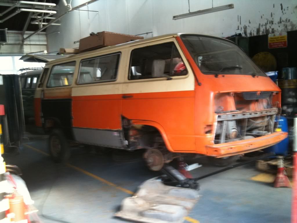

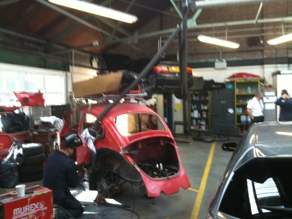

Had a good go over underneath, and its surprisingly good! A little rust around the leading edge of the sills, but not bad at all tbh. Was expecting to have to rub all brake lines down and paint, but under all the crud, they looked brand new! Was well impressed! Its all new copper pipe, history of MOTs says OSF pipe excessively corroded in 2009, and was obviously replaced, but they must have done em all, all though there's no receipts for them being done. Tank straps needed a good rub down and hammerite, and most of the bushes are all very good too. Things I need to do though are rear bearing, both have ALOT of play in em, although theres no drone so it could possibly be cured by just doing them up a little. Gonna get new though as they could have had it and I'll just be delaying the inevitable. Its wierd cos they've been changed 3 times in 5 years according to MOT history. Something amiss maybe..... :undecided:      ARB droplinks need replacing as one side is all splitting and perished, and the only other thing is exhaust hangers! Both rear box hangers have proper had it!  :grin:
Only other thing that needs doing under there is a star washer thing (whatever their called) that secure the heatshield. One is missing near the backbox causing a little bit of a rattle when cold at idle. Thats it though!  :smiley: Here are some pics from today, not any up close of my car though, just a background of it up on the 2 post.  :cool:
