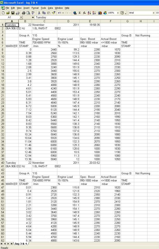

What's the typical boost of a stage 1 AUM with KO3s?
I have a log from vag com that a mate did on his laptop showing at its highest, Spec boost of 2290 mBar with actual boost being 2260 mBar. Is it really that high?
Link to a shot of the logging http://i8.photobucket.com/albums/a3/ant1981/Boostlog.jpg

that is like 30 psi... have u clamped a pipe :shocked: ..... could be a revo map :grin:

No nothing. I am wondering if Vag Com is reading that boost as a level above atmospheric pressure?

Depending on the map it should peak at around 17psi :undecided:

It's including atmos press :-)
Around  1000 mB

lol don't panic as Doc says it includes atmospheric pressure :grin:
18.26psi roughly  :wink:

Awesome, thanks. Next time we do logging, I'll check with the weather so that I know what the QNH (pressure) is so that I have an accurate figure to deduct. But it's pleasing anyway to see there's little difference between requested and recieved boost.
