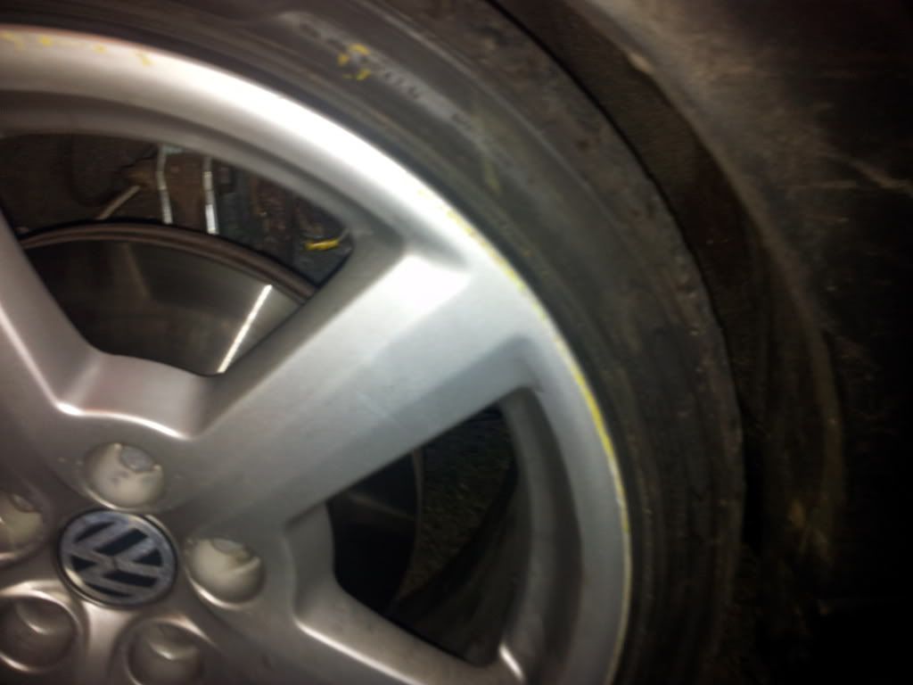

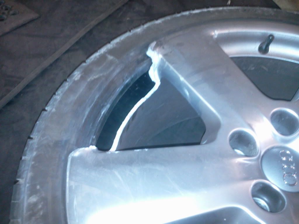

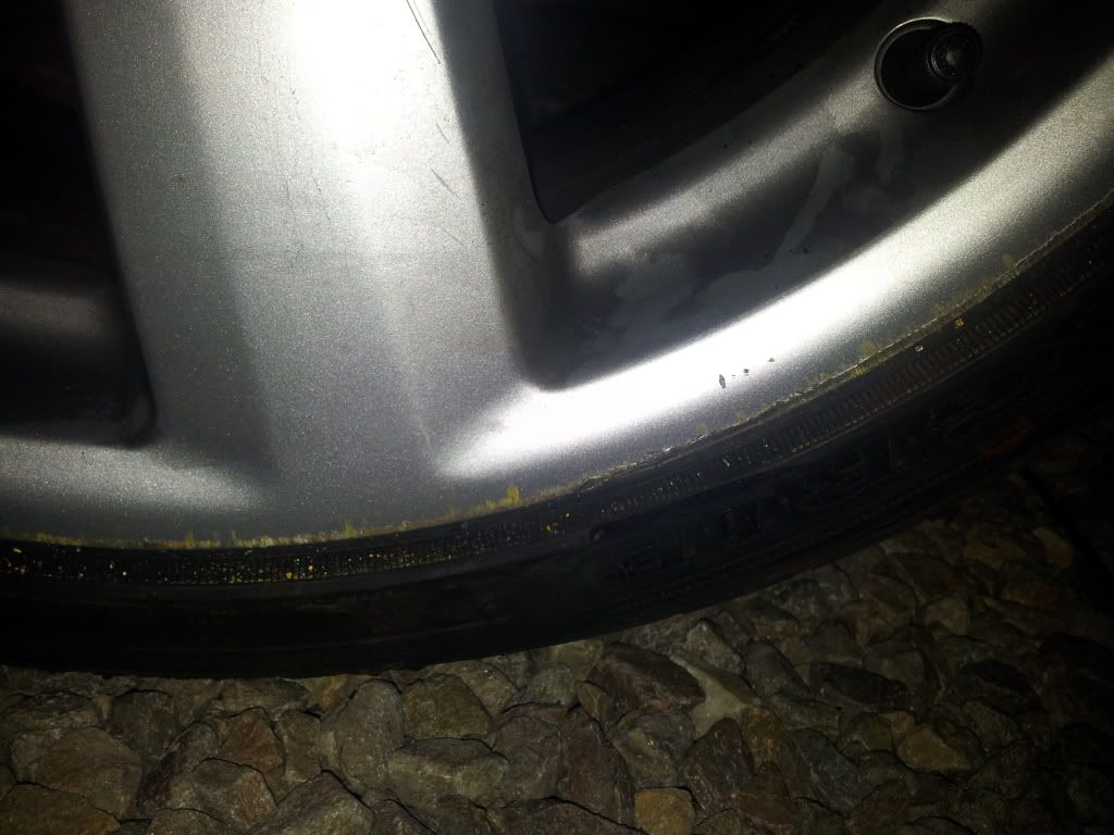

« Reply #4 on: 18 November 2011, 19:43 »
Ouch  :shocked:
Heres pics, yellow paint is the skids off the ramp c/o Bradburry  :grin:

Aint that a beaach,you could probably get the yellow off with a liquid rubbing compound or maybe T cut,but the rest (suck teeth) could try some fine wet and dry then polish back to a finish but i imagine the wheels will need to be refinished to removed all traces of damage  :sad:

Yeah some of the damage is quite deep....
Worst bit is two of the people I work with were doing a clutch on an Itegra at the time... Their laughter only made me feel worse!!!! :grin:
Is it easy enough to refurb yourself??? Im happy enough to do it. Just concerned about paint peeling/using correct paint etc.... Is there any guides to refurbing your own wheels??

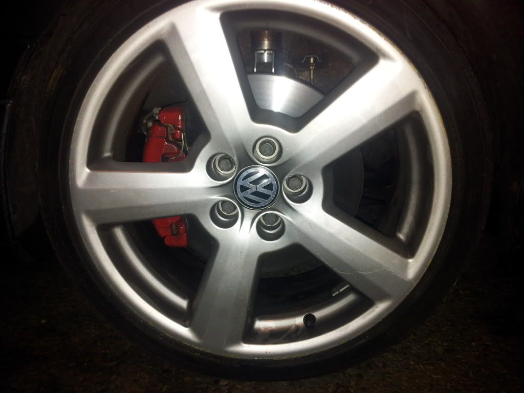

Im no expert,but if you got half an idea how to spray then have a go ,yours would be an easy wheel to deal with,what i would do is remove the tyres,sand the edge of the rim untill all the scrapes have gone,flat the whole wheel with wet and dry,etch primer where the bare alloy is visible then use a 2k primer all over,2k basecoat then clearcoat,like i say im no pro but i did my own and got good results.....
Offline CJA321
  • Posts: 684
Re: Made a biiiiiiig mess
« Reply #9 on: 18 November 2011, 22:19 »
Those are yours? There great bud. look great!!! Really good finnish!!!
