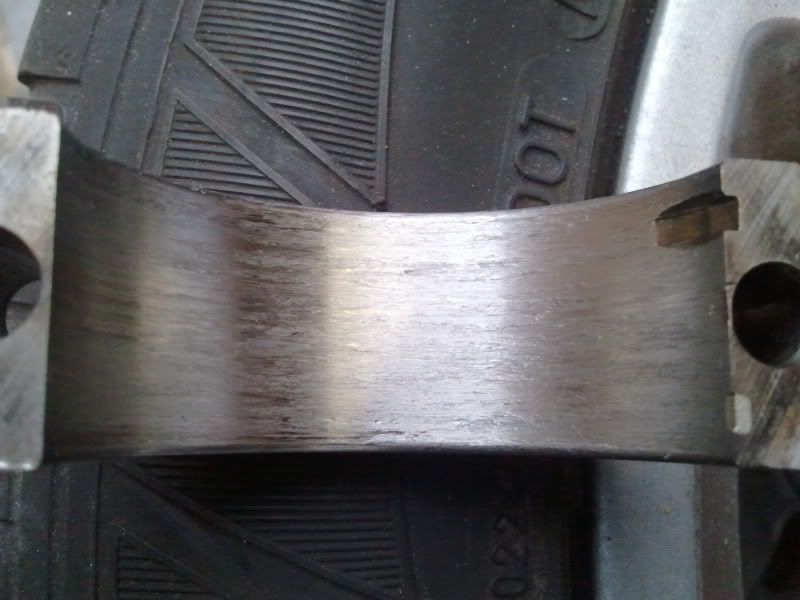

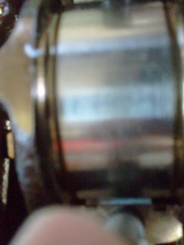

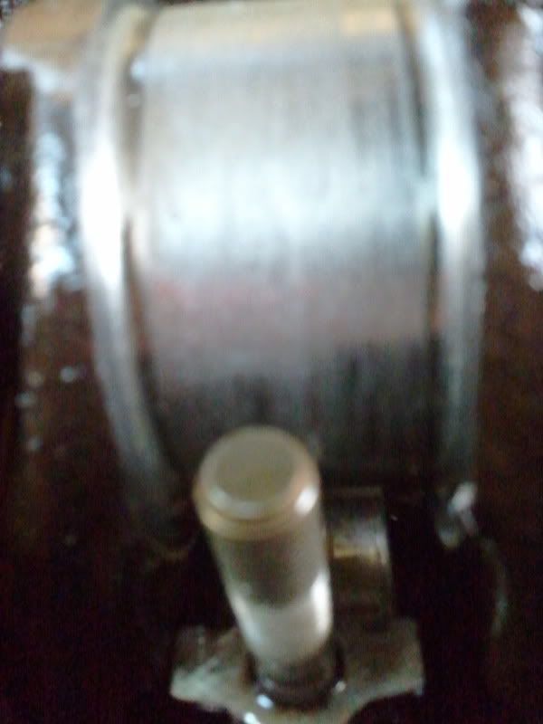

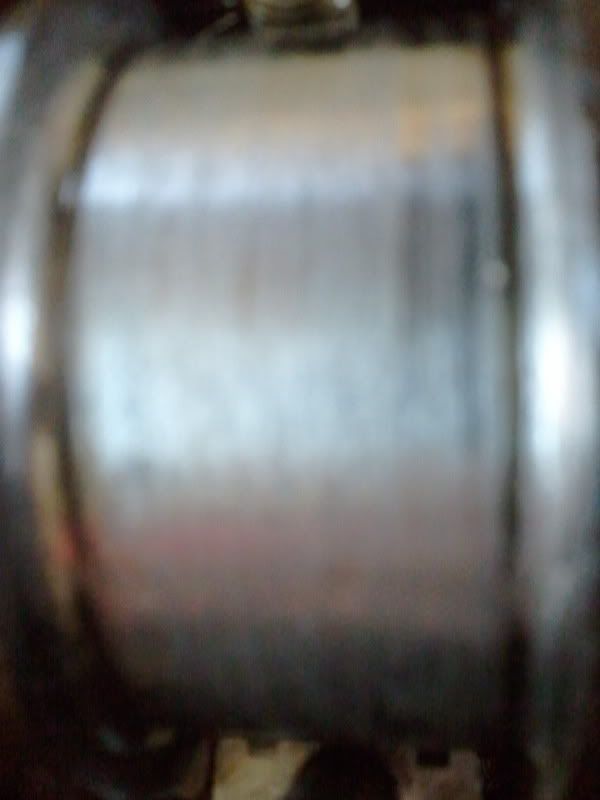

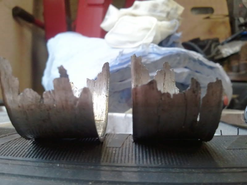

found this today after i whipped the engine out
do u think there foobared ?
anyway what u reckon has the crank had it here some pics sorry there not all that but was on my phone
heres a pic of the a good one
rite so i reckon if this is ok to fix i will need to put a new oil pump on just incase its full of metal filings and then do i rplace all the shells or just the one that foobarred
option 2 a friend has a bottom end that ament to be good could i drop the crank and shells out of that into my bottom end ?
cheers

Really need better focussed pictures to be sure but the crank journals and rod cap look fubar. If they are scored as bad as the picture seems to be saying Id be throwing another engine in there and keeping your current one for the top end bits (after stripping that to check nothings been floating up there).

its perfectly fixable you may have to have the cranck reground, i would defantly do all the shells if ones gone trhe rest are going to be worn,   think it maybe to late for that con rod tho looks like the shells ripped it up a bit,   of needed i chould fin you a rod  have a box full of std abf rods
