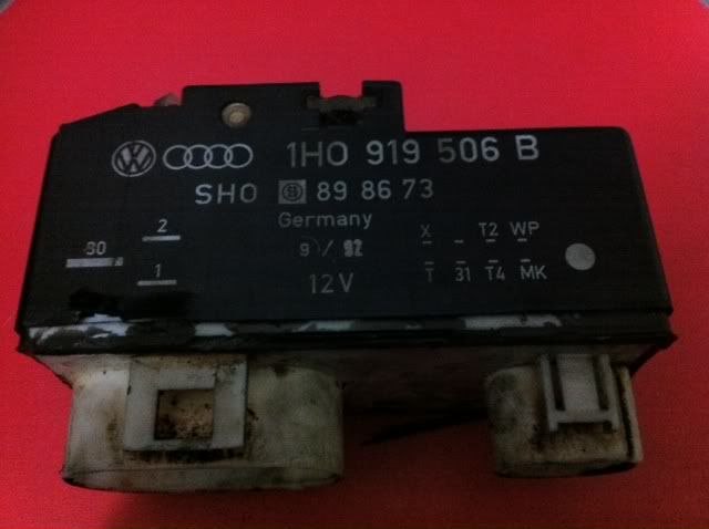

If is possible...Is it an easy task or maybe not worth it? what about the electronics involved? Would a single relay as the one have now (picture my old broken one):
will be enough and would only have to bridge it somehow to the other fan? What about the radiator and such...if there's a link explaining the whole overdeal I appreciated.

Firstly, that is crazily over priced and is literally just the plastic housing, I saw one sell for less than a fiver on ebay just a few days ago with both fans and motor.
The twin fan from certain 16v GTi's or a straight swap and run perfectly well on the existing 8v fan loom, the VR twin fan runs a different relay module and wiring so that would be a no go for you.
Both items just run one motor and the 2nd fan runs on a belt from the first one.

as Ben jam in says..
We swapped my single fan set up with the twin fan set up that was on a 16v car with i used for bits when we did the S3 conversion on mine
All i swapped was the whole front panel, loom just plugged in as normal and it all works

I'm pretty sure you can swap the single for a double without touching anything else, as the second fan is just driven by a belt attached to the first one so in affect there is still only 1 fan being operated
I wouldn't go changing the control units as (at least from my experience) its hard finding the right one, there are literally loads of different ones some have 2 plugs some just one, and they all have different pin layouts. since playing around with mine my fan has stopped working all together!

Dan you can becasu its what i did
The VR has a different plug and control unit tho, but along as you get one from a GTI that had aircon and twin fans, it will be direct swap (just the front panel) and no need to change out else

That's what I said! just change the front panel don't touch the control unit (unless I'm misreading your post)
Only reason I had to change my control unit was because I went from using an 8v loom to a 16v loom so they had different plugs
