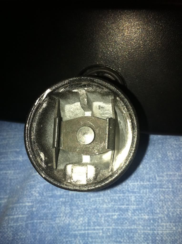

Ive bought myself a black rear view mirror that I'm planning on putting in the car, but I just wanted to ask, is there a technique to removing the original mirror? :undecided:
I replaced my rear view on my Mk3, n was soon on the phone to AutoGlass :cry: :grin:
Risky job, possibly. Worthy mod, definitely!!
I took a pic of the clip to refresh people's memories

One black rear view mirror :cool:
Note to anyone doing this mod, turn the base 90' anti clockwise, n it will plop off :smiley:

As mentioned, and pictured, grab hold of the base, and tentatively twist it 90'. It will pop off clockwise or anti clockwise, but it must twist 90'. Some are a right b!tch, and will crack your screen regardless! :angry:
