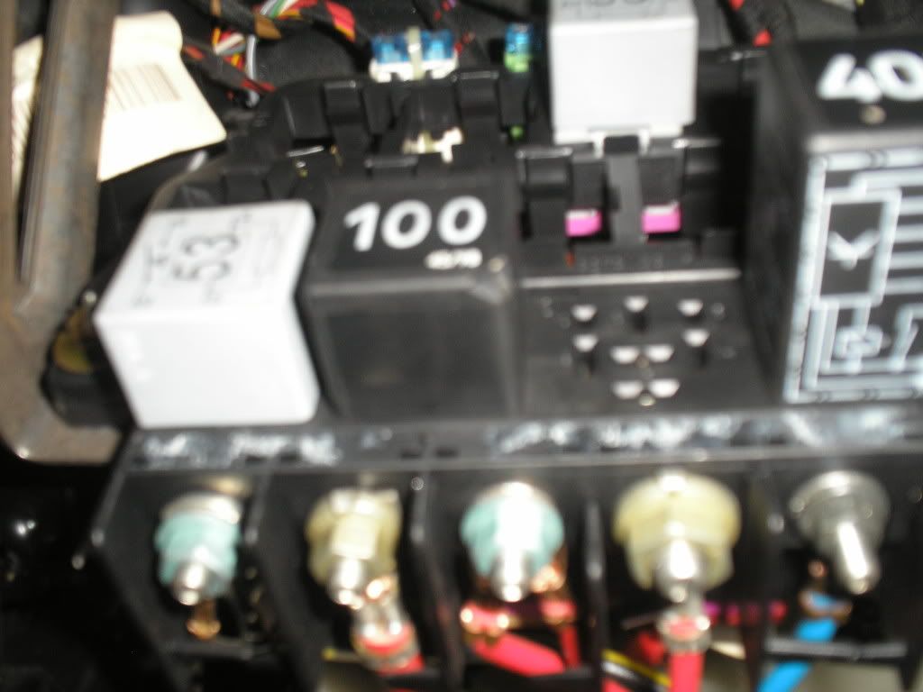

I've managed to trace my fault to a relay by the pedals, numbered 100
It keeps cliking on and off when the fault occours, anybody tell me what it's for, as ive changed it and it's still the same  :huh:
Offline Rhyso
  • Posts: 26,687
Re: Missfire on an 1.8T AGU engine code?
« Reply #18 on: 22 September 2011, 11:28 »
Its the ignition relay
http://www.golfgtiforum.co.uk/index.php?topic=87372.0
Offline johnomk4
  • Posts: 262
« Reply #19 on: 22 September 2011, 11:36 »
Thank's Rhyso. :afro:
So looks like im going to have to delve into the wiring somewhere.  :sick:
