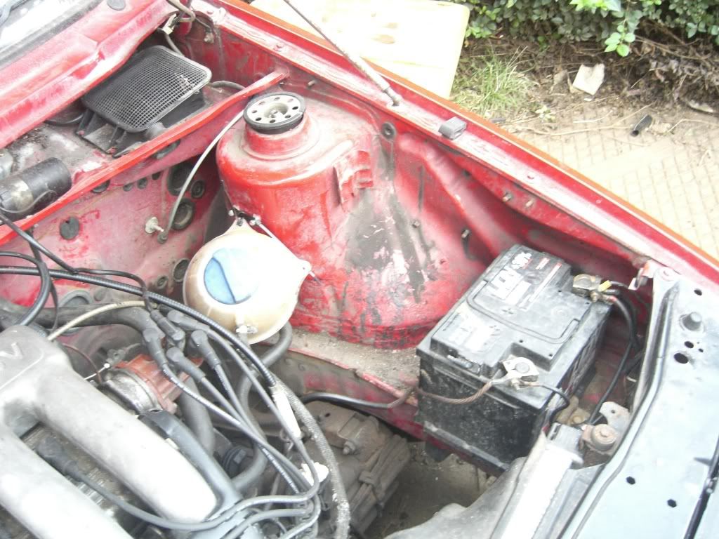

Ive used my ABF engine (115k) after a mild refresh replacing headgasket bolts plus leads and service items and engine mounts.
It is running standard digi 3.2 with whole loom tucked and an 020 box with full linkage kit replaced.
Old mk3loom

Still needs a steam clean in there and detailing

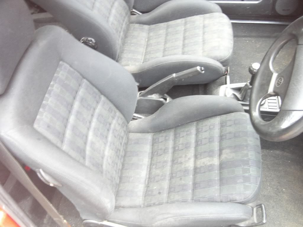

160mph 16v clocks, polo gt steering wheel. Similar to corrado wheel but silver trim not leather stitched
Corrado front seats with no tears, still need doorcards trimmed to match
Boot is carpeted with a rear mount washer bottle to clean bay up.
Still need a top hose coolant filler to erase expansion bottle, does any1 have any ideas on this?
