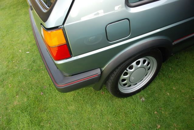

Hello, and welcome... If i'm honest, i dont like any of the wheels that halfords do, but thats my opinion, and your choice... Have you considered something like genuine VW G60 steel wheels? they are dirt cheap, look good, and dead easy to get a replacement if one gets damaged, smooth center caps, or a small black cap that covers the hub, look great with a wide low profile tire...
And... not the best pic, sorry

« Reply #3 on: 06 August 2011, 16:55 »
they look good on others too
 :smiley:
