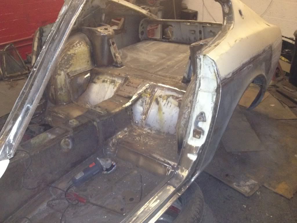

Boot floor made and put in...plus the new side parts fabbed up and welded in. Can get some paint under her now. Just rear shock towers and roof to finish the shell...then on to the cage.

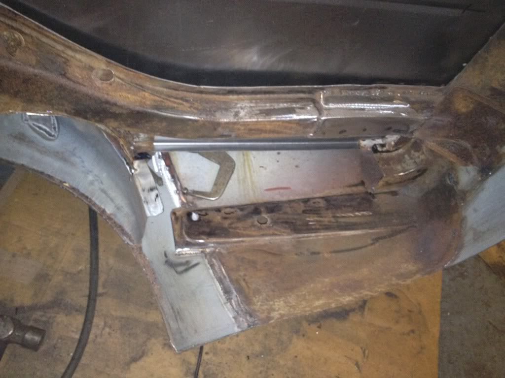

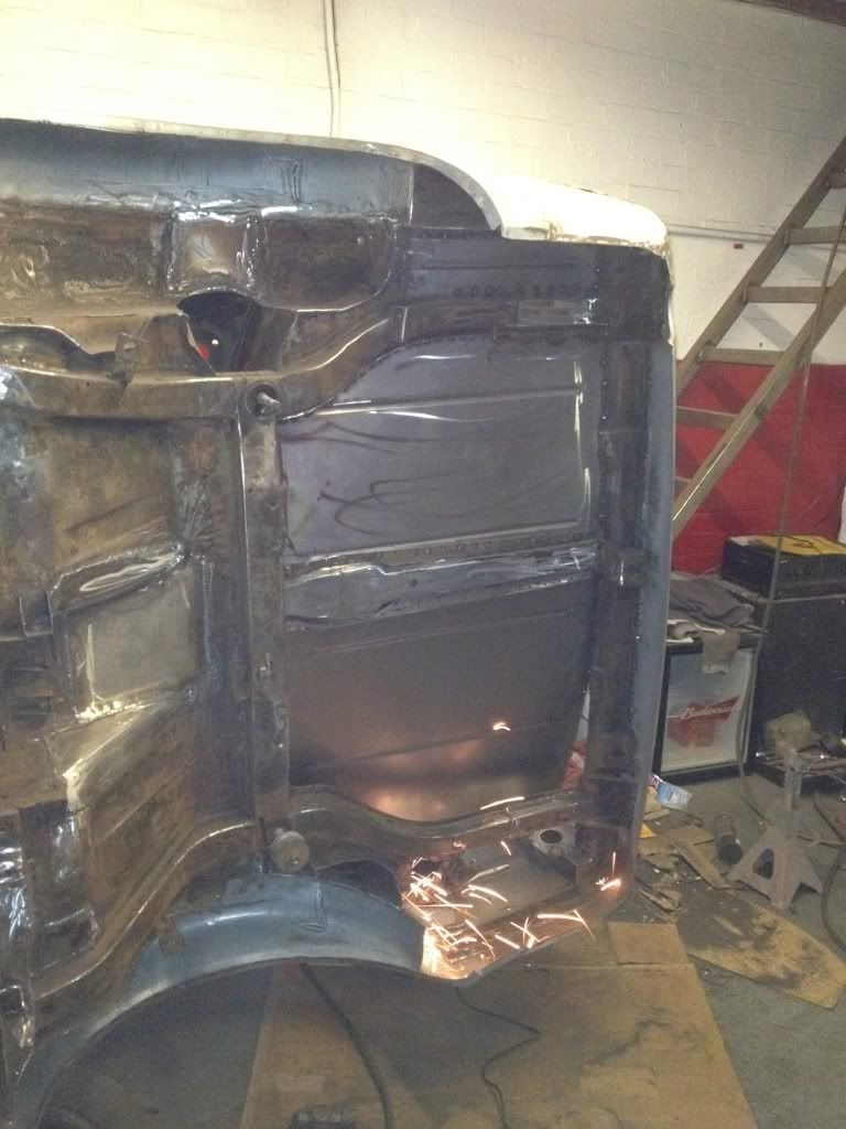

Worked out that when the cage goes in the rear storage compartments will be in the way...so out they come (Pre '71 Z's didn't have them anyway!):

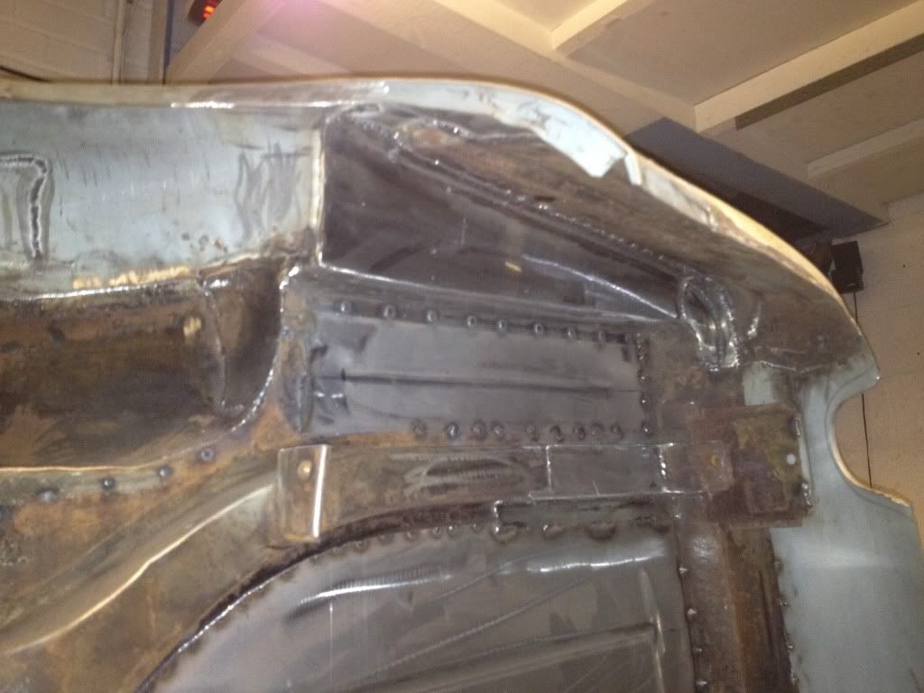

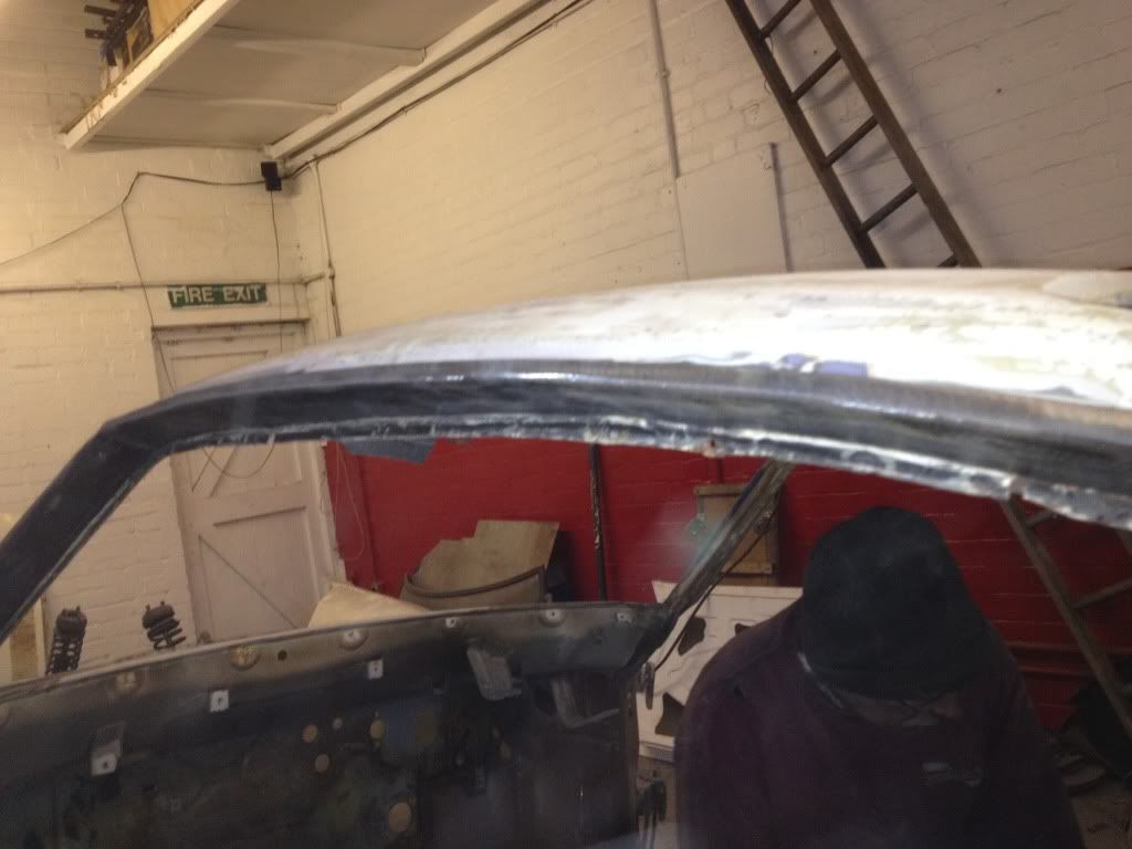

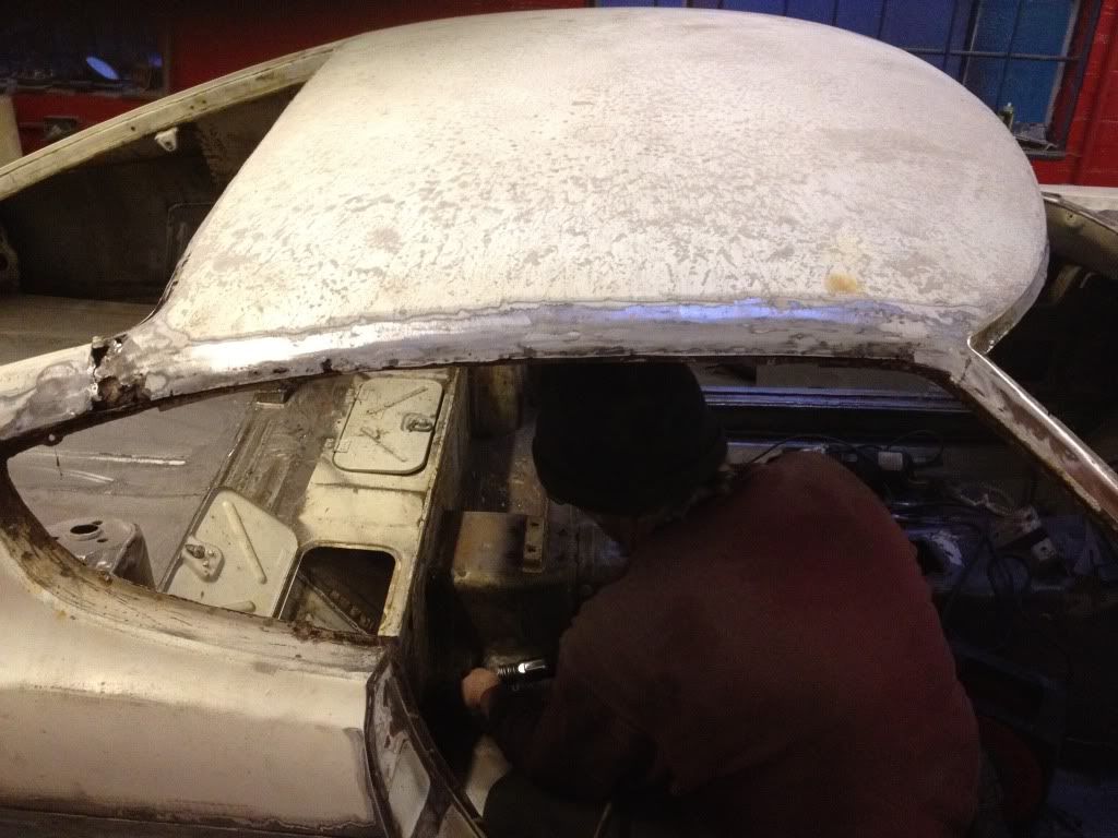

One side of the door sill fabbed up and fitted...the bottom of the roof was barely attached to the rest of the body.

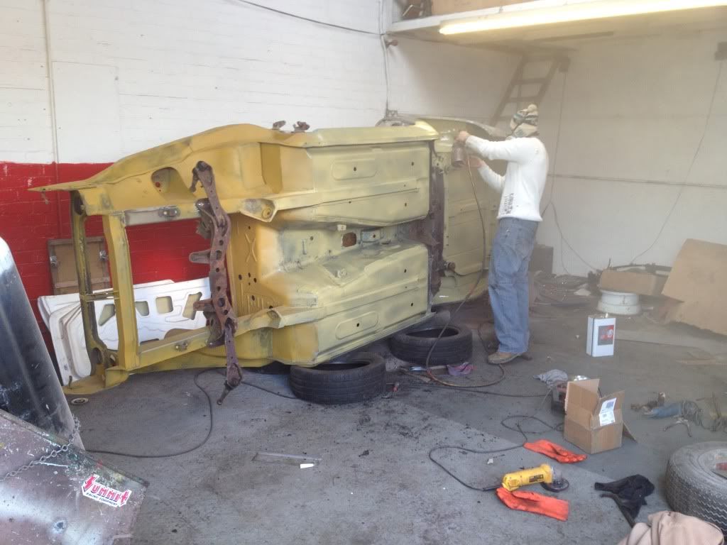

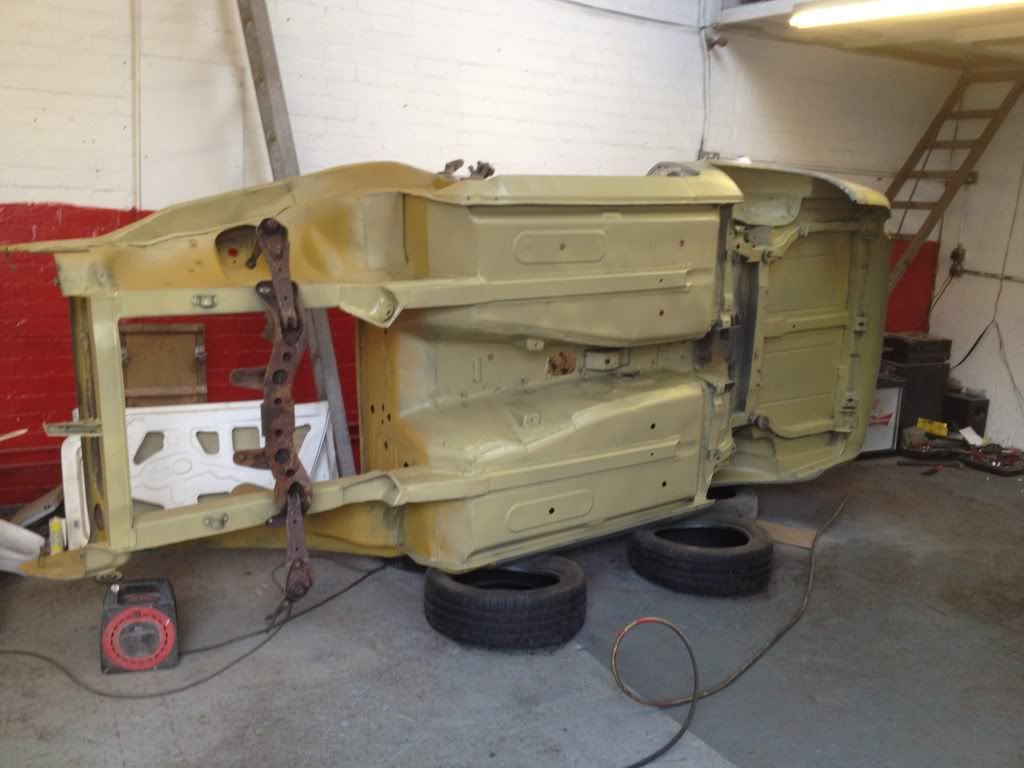

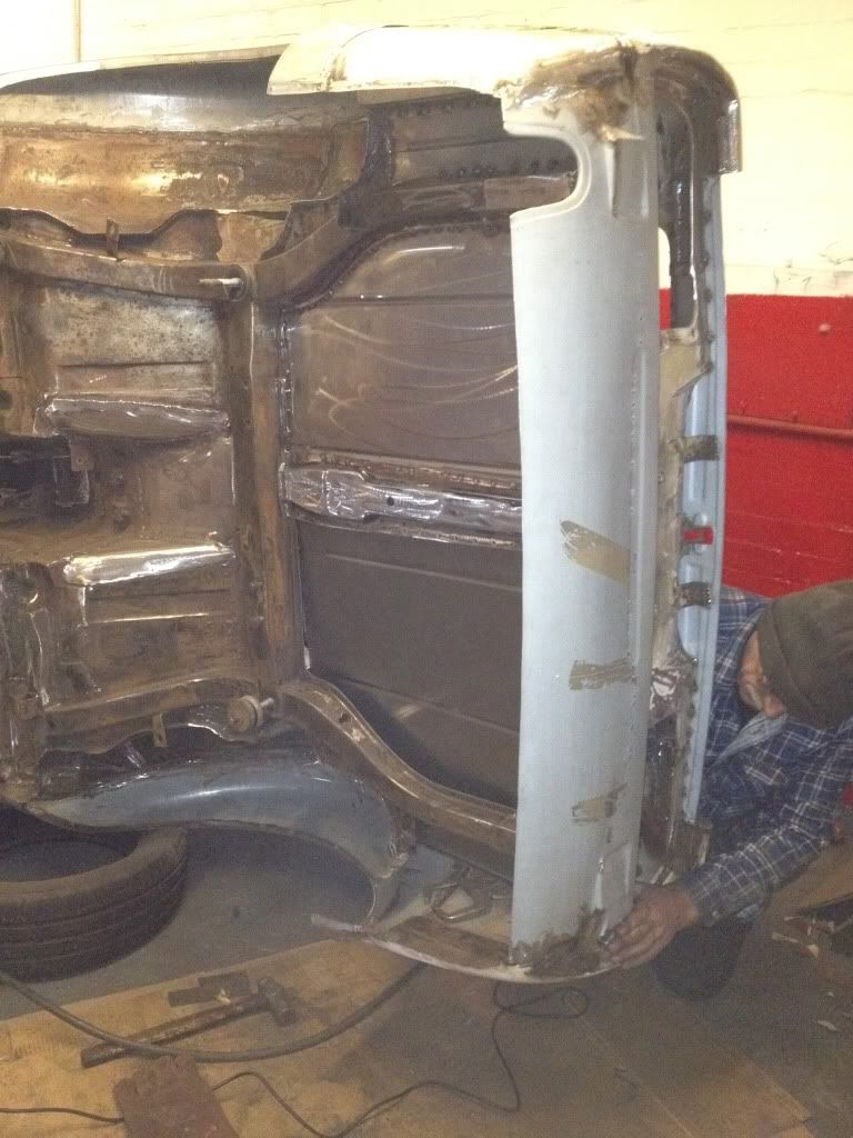

Underneath painted to protect it...lots of the paint will be coming off again when the plates are welded in for the cage but didn't want it all left bare:
Layed it back again and messed around while cleaning all the crap out of the garage...put some SE37k's under it for a laugh...
