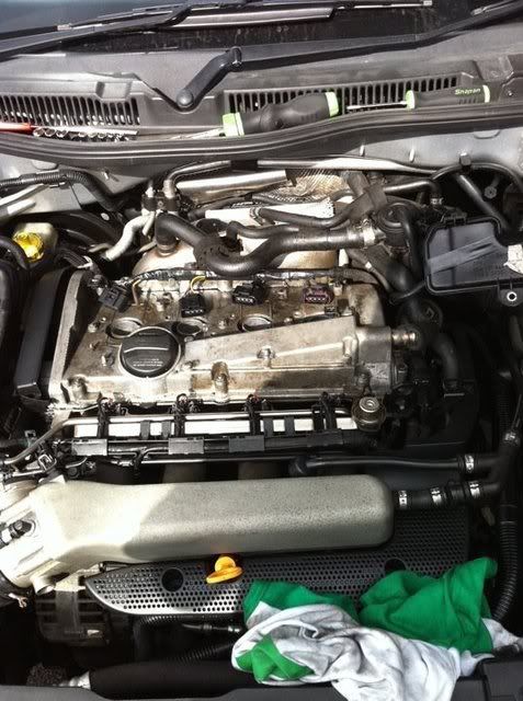

ok peeps when i bought the golf bout 4 months ago she had a few gremlins that bugged me and had to get sorted,still a few but almost there.
the rocker cover gasket was leaking and replaced with a genuine one.
before
half way
and job done

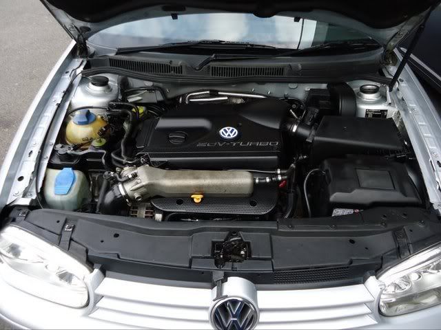

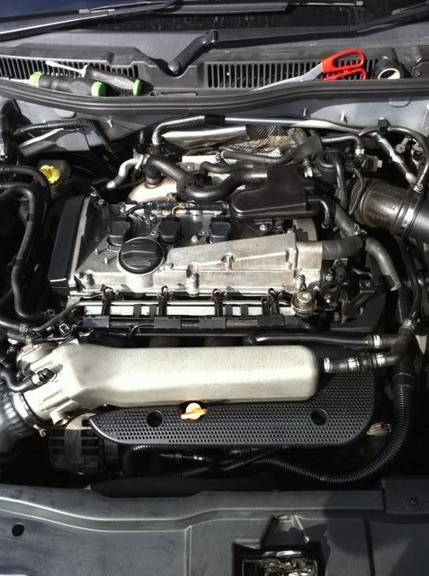

the engine management light came on after a week of taking ownership,got my mate to scan her with vagcom and turned out coils 1 and 3 was dodgy,but 2 and 4 was ok even though all 4 was cheap euro car parts specials.decided to change all 4 with genuine parts,replaced them,rescanned and resetted with vagcom and running spot on.so i decided to wash the engine bay at work using jizer as a degreaser and jet washed it all off
bay on the day i got her
bay after a good clean
decided not putting the cover back as it just looks better this way

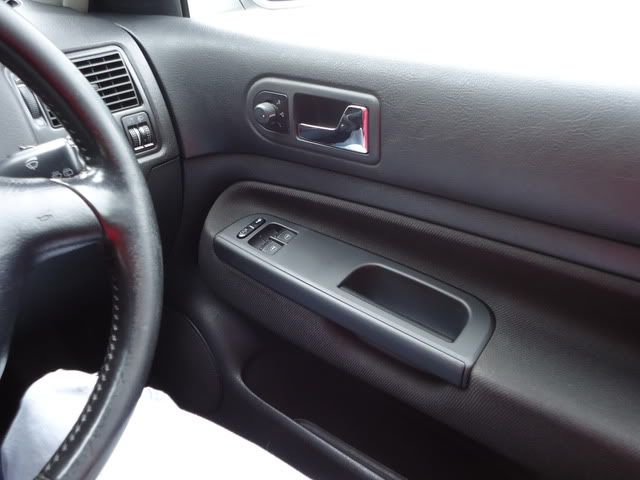

after all this the reverse lights stopped working,checked all the fuses and bulbs-nothing to be found and then it hit me,had the same issue when had my vr6 so replaced the sensor on the gear box and hey hey got it working again.this got me in a happy mood so i decided to change the horrible wallnut wood effect trim-diy spray job which tunred out quit nice
pass door handle
driver door handle
centre console bits,ashtray and gear knob

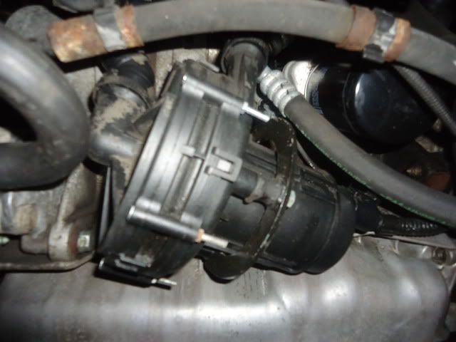

on start up the golf sounded like a henry hoover being red lined like a type r honda.it was coused by the vacuum pump,so had to get it sorted and thanx to the search option i got it done with bolts and nuts i got free from work.vacuum system soon to be removed when i feel up to it

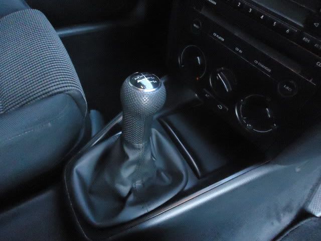

then i decided to got a new gear knob and gaiter from the stealers,the wood effect one wich i sprayed black started getting scratched to easily.
