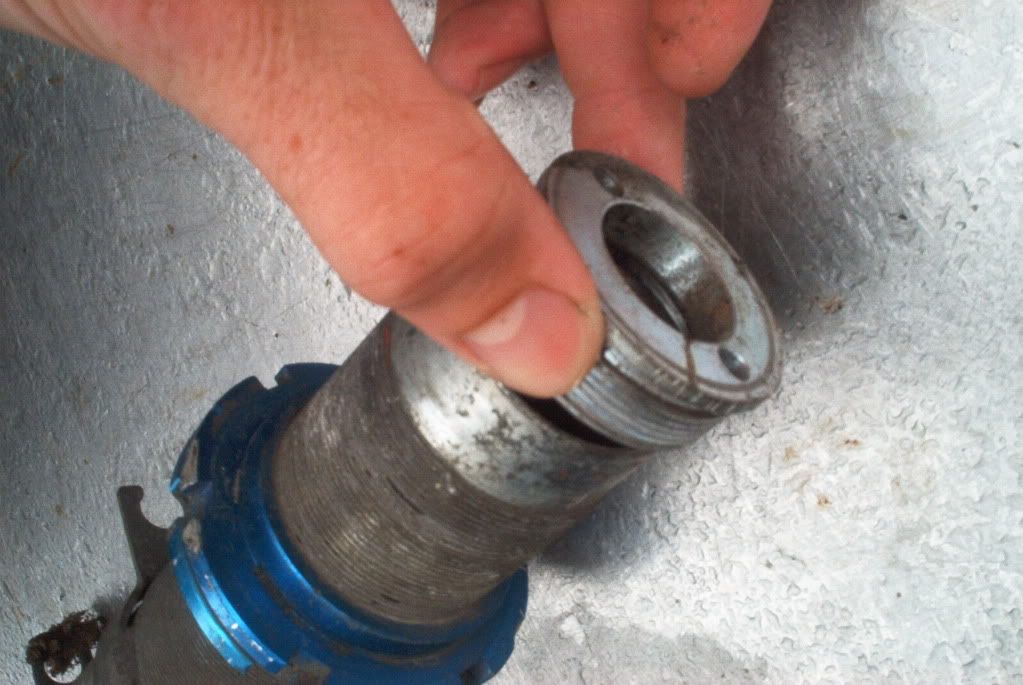

With the help of a mate earlier I stripped down the front coilovers to try and solve the knocking from the offside strut.
Due to JOMs being designed to be serviceable they have a 'nut' which holds the shock in place inside the strut:
This works loose causing play in the strut and an annoying knocking! Although it was only a problem on the offside we stripped both coils down and applied threadlock to both nuts and rebuilt them again.
The offside had leaked a little bit of oil due to the movement in the shock :sick:
While the coilovers were off it would have been rude to not wind them down a little more :evil:

Is the shock a complete insert, if so a little oil will not hurt as it will stop it rattling.
Yeah it is, the nearside one was bone dry though. Apparently you can replace the JOM shocks with Koni inserts....something that might be a worthwhile upgrade.
In theory that little cap stops the rattling by holding the shock in place :wink:
Whenever I have fitted inserts, I always use a little oil or even antifreeze they do tend to rattle otherwise.
Fair enough :smiley:

How do you find the ride on the JOMs Dom?
At a reasonable height the ride is actually pretty good, I dropped mine about 15mm earlier and that made a big difference to the comfort. When they get low, they get bouncy like all cheap coilovers.
That said the ride is no worse than a mate's MK2 running KW V2's that are would all the way down.
