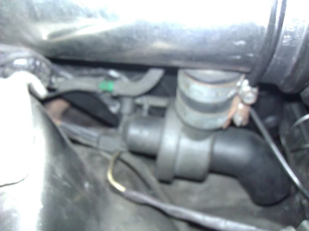

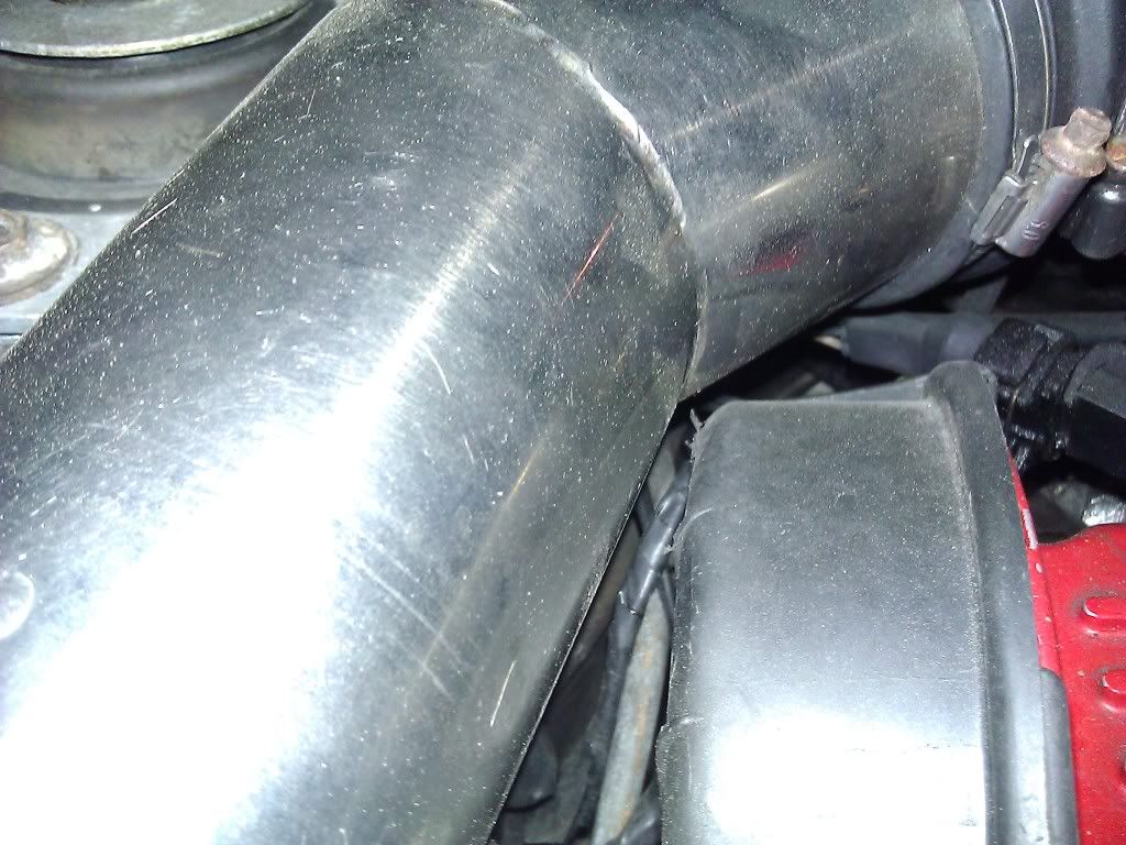

ahh right then i would suggest taking the intake pipe apart and see if its all fitting properly. on mine it a chrome power rohr pipe that is a bit longer and gives good clearance but does touch suspension turret. the valve thingy underneath is the overrun cutoff valve and you should be able to loosen the jubilee clip and maybe twist it away from cambelt the open end of this valve on mine is pointing towards wing.
get a picture up
it does sound like the metering head is mounted too close to engine thereby causing intake to foul
my m/head airbox is about maximum an inch from the inner wing, and yes they should clear the belt

right heres piccys clearance is closer than i thought but never had an issue
