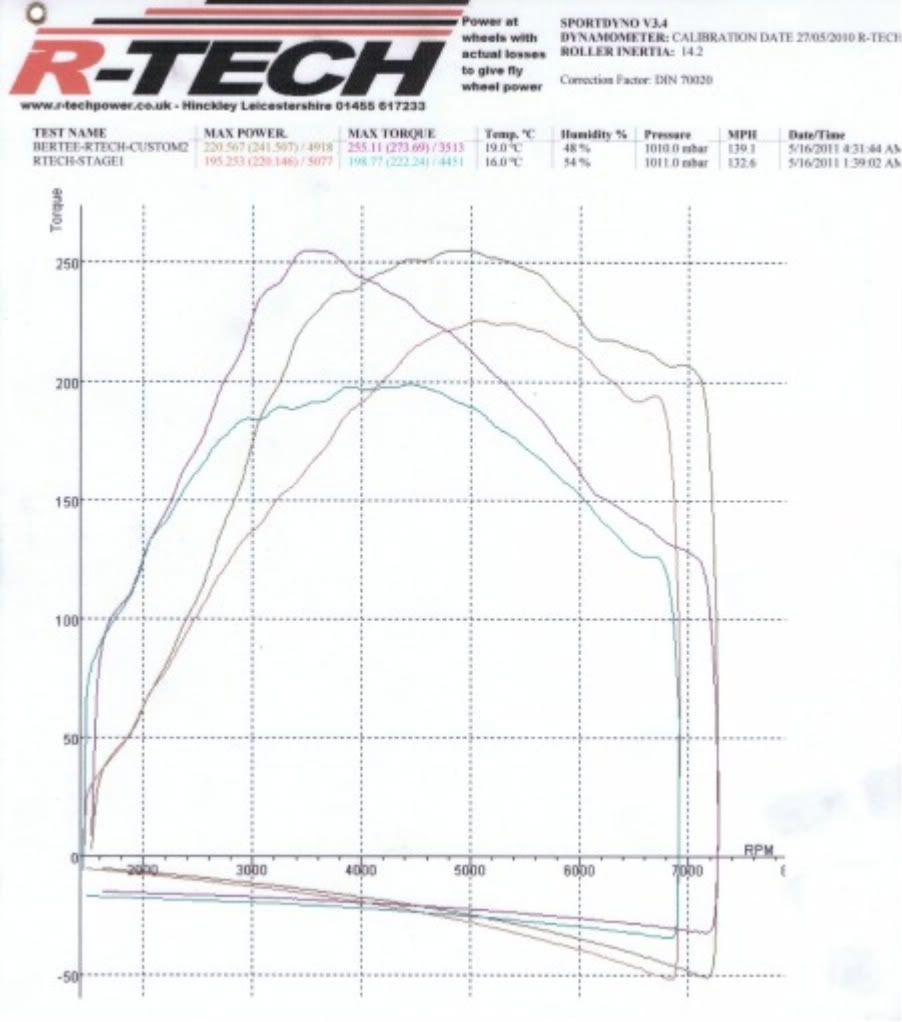

Heres the answer I got when I asked this not long ago. I was asking for the AUM engine which is 150bhp standard with K03s turbo. Not sure about the AGU which is 180 standard but I guess its the same kinda stuff
How much work is needed to be done to an AUM to reach more than 255bhp? Asking as I'm choosing my cat and need either 195-255bhp or 256-325bhp
cheers :)
Ko3/k04RS hybrid turbo
3" MAF
380cc injectors
225lph fuel pump
Milltek Turbp back exhaust
THS Front mount intercooler
R-Tech Custom remap
This setup should flow enough for aroud 270bhp 270lbft.
OK cheers looks like I'm in no danger of getting anywhere near that then lol
The safe max I can push the AUM trubo is around 242bhp 275lbft by using a cylinder wetting strategy and dumping fuel in at the top end to keep componet temps down.  This mapping will see 1.4/1.5bar peak boost peak and needs to be ran on V-power fuel.
Once map correct it will be just as QUICK as a the 225BHP TT with a stage1 remap due the the ares under the curves.
1.8T k03s R-Tech Live Custom Remap
