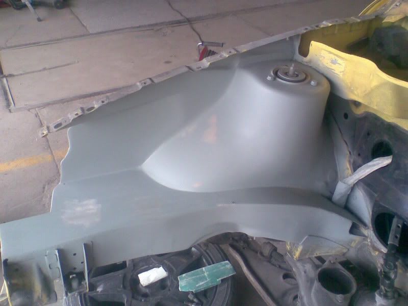

This si the look i am after more of a 'tubbed' bay

I have done a few to different levels.  The red one was just the main holes and battery tray etc and the other was an Ibiza which i had to fabricate the whole bay as it is normally just a skeleton!  Whatever lengths you go to it will take ages  :grin:  There is a fair amount of flex within the engine bay so welding is a must.

That was really hard to do, but mostly because it was like this before:
But mk2's are half done for you! I would get some filler with a bit of flex in it.. such as this
If you need to put a fair bit in, mix it with normal fibreglass filler for strength.
Imo the most time consuming part is getting all the old rubber sealant off, so a good blowtorch is a must!  When doing the Ibiza bay I just made a template from card and tried to make it all from as little pieces as possible.  Welding a little at a time saves a lot of warping of the metal and a lot more filler and effort later on.  I will try and dig up an old build thread of a nice bay.
