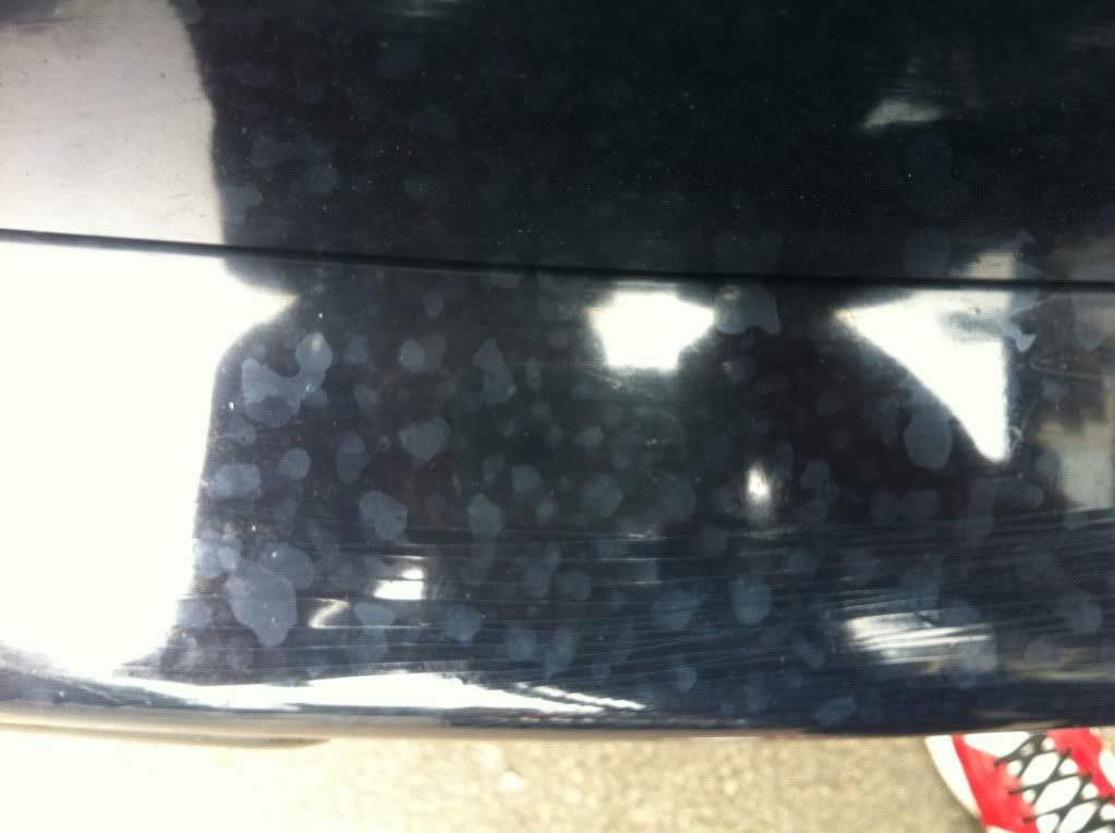

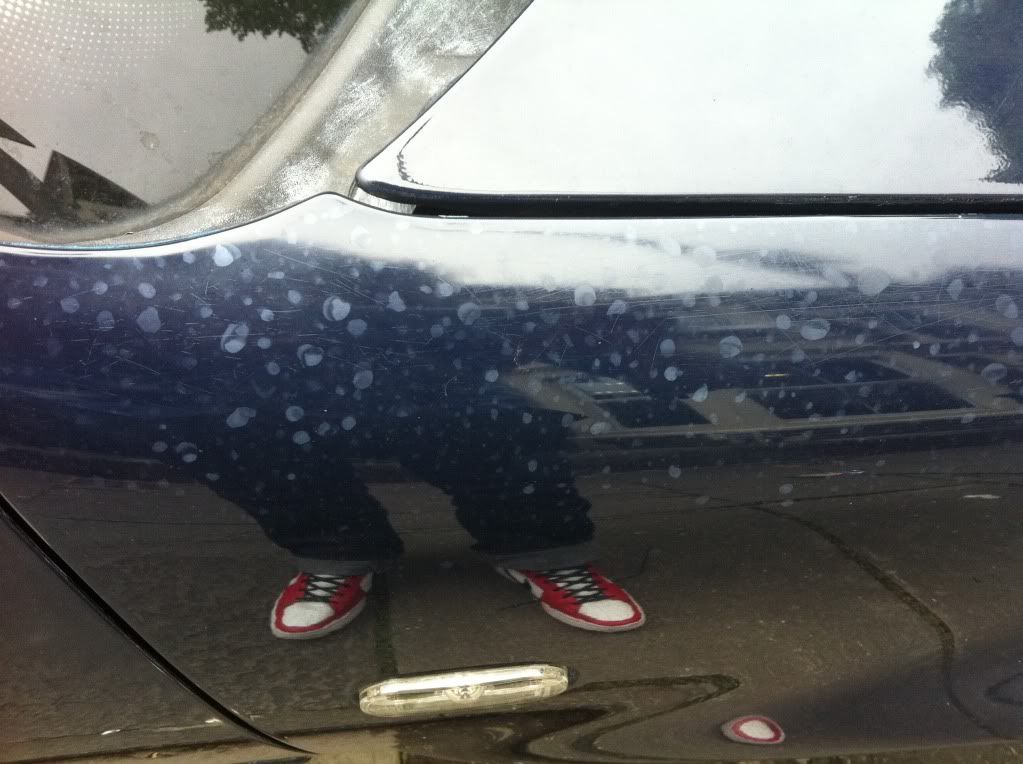

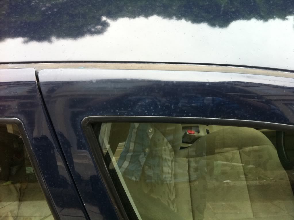

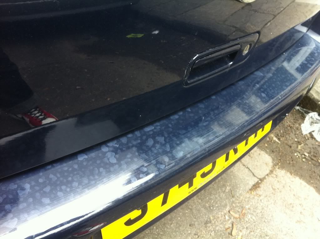

So basically he's stuck with it? Some pics (ignore the scratches):

Mmmmmm think thats going to be a strip back and start again job mate thats some serious water marks there but id concentrate on getting the paint spot on first before you waste anymore sealant and wax, the top of that drivers wing looks like the paints failed.

without seeing the top of that wing close up its hard to give an accurate diagnosis but the random direction of the scratches at the top of the wing look suspect to me and they are quite apparent which could mean they are either down to the primer or there quite deep and theres still wax or polish residue in them.
, if you can sort a few close up shots that would be cool if not id take it to a proffesional sprayer and get there opinion on it but my hunch is the paint is failing on the top of that wing due to deep scratches and the previous oxydation.
the rear bumper definatly needs a respray due to the cracked paint.

you can always garrenty getting the right advice on here  :cool:  after reading the first post, i was going to reply with just merely wipe the water marks off with a quick detailer, but after looking at the pictures, its obviously something more where it looks like the water has sunk into the protection, which with 6 possible layers, how has it done this?
