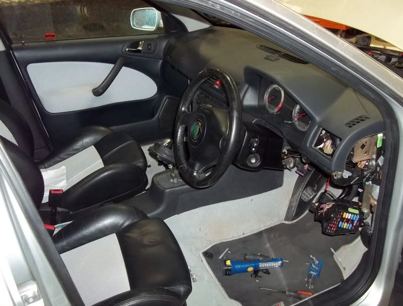

No pictures, sorry but heater matrix has now been replaced and dash is nearly back together, few hours tomorrow along with bleeding the cooling system will see it finished .

Few pictures from earlier, all now up and running just a few tweaks needed tomorrow.
All in all it took around 14 hours, it is not that hard a job but so much needs to be removed to gain access.
